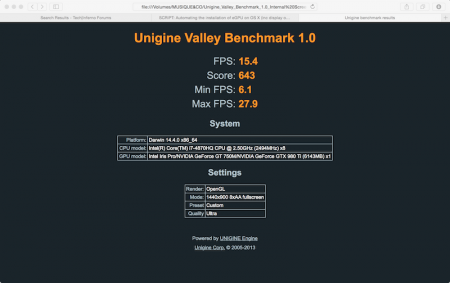

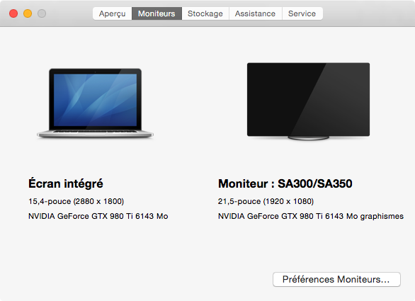

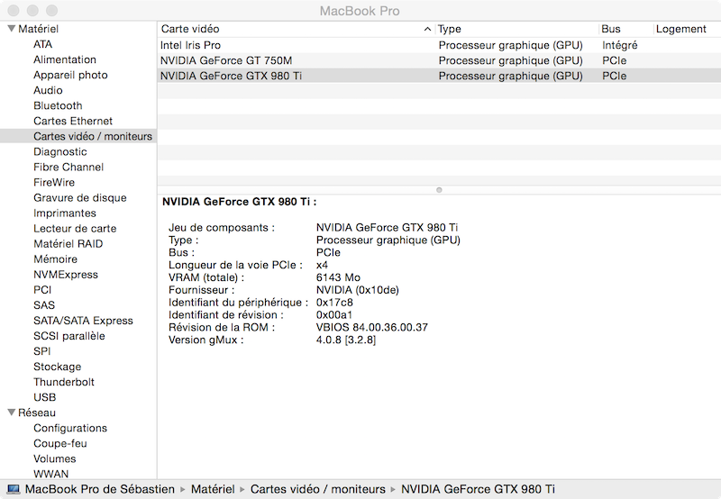

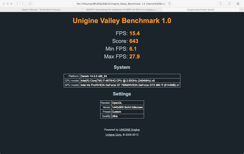

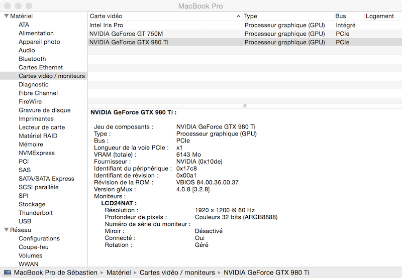

Hello,
First i want to thanks all the community for all the devotion and goalque for his wonderful script.
I have an issue with my setup :
- macbook pro 15’ mi-2014 with GT 750M
- Akitio
- PCIe Riser with molex
- XFX ProSeries (Black Edition) 750W Fully Modular 80+ Gold Power Supply
- Palit Nvidia GeForce GTX 980 Ti Super Jetstream Graphics Card
I have tried countless hours to make it works without success.
I was running the script on a clean install of OS X 10.10 Yosemite after having reset the NVRAM doing (Command (⌘), Option, P + R at startup). It was recognizing my card after the reboot as an « Nvidia Chip Card ». I have tried to hot plug my external monitor in DVI directly into the GPU, my computer could recognize it as an external screen but it was very unstable and every time i have tried to launch the benchmark Unigine Valley in this screen they were a kernel panic.
The « automatic graphics switching » was turned on, « integrated only » selected on gfxcardstatus and FileVault disable.
I have made an other clean install of OS X 10.10.4, did the same with NVRAM etc. The script installed the NVIDIA Web Driver 346.02.02f03. My computer was able this time to recognize my card as a GTX 980 TI
I have hot plugged the DVI, it was very unstable too. I tried to launch Unigine in my internal screen and the result of the benchmark was very bad.
I have tried all the combination possible, with or without -a mode etc with no success. The only stable thing was that my computer recognize my eGPU if i plugged the thunderbolt cable just after the chime at startup and if they were not a kernel panic before.
So i tried with a different monitor in hdmi. It was much more stable, and the computer recognized the external screen as a monitor associated with my eGPU
But unfortunately same error with the kernel panic each time i try to launch the benchmark on the external monitor.
I did exactly the same also on a second partition with El Capitan GM and the SIP (Cmd + R, « csrutil disable ») disabled in the terminal, same errors...
I have made two file for the eGPU with DVI plugged or hdmi with the method you described here :
