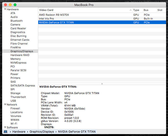

portwolf Posted September 18, 2015 Share Posted September 18, 2015 So I just got it working, my PCIe Lane Width is showing as 4x, but I believe I've seen some screenshots showing it running at 8x, is it just my card? Is there further config I can do? I'm not really super concerned as it's working very well, in OSX doing the day-to-day and development tasks I do, and gaming is working great on Windows too. But I like to get things right. Quote Link to comment Share on other sites More sharing options...
Tech Inferno Fan Posted September 18, 2015 Share Posted September 18, 2015 So I just got it working, my PCIe Lane Width is showing as 4x, but I believe I've seen some screenshots showing it running at 8x, is it just my card? Is there further config I can do?I'm not really super concerned as it's working very well, in OSX doing the day-to-day and development tasks I do, and gaming is working great on Windows too.But I like to get things right.[ATTACH]15950[/ATTACH]x4 2.0 is the electrical link a Thunderbolt1/Thunderbolt2 controller makes with the notebook. The x8 screenshots you've seen show a multi-slot Thunderbolt enclosure like say the Sonnet III-D. Those enclosures split off the x4 2.0 link using a PCIe bridge to slots using say x8 2.0. While the video card says it's connected at x8 2.0, the downstream link is still x4 2.0. Those multi-slot enclosures may even have their x4 2.0 bandwidth shared across three concurrently working cards in those slots. Quote Link to comment Share on other sites More sharing options...

portwolf Posted September 18, 2015 Share Posted September 18, 2015 Thanks Nando! Check this out guys 2 Quote Link to comment Share on other sites More sharing options...
