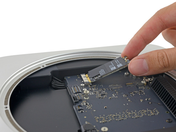

peleap Posted September 9, 2015 Share Posted September 9, 2015 i have a questions about make mac mini 2014 eGPU by pe4c to save budget (70-100 $) questions pcie in mac mini 2014 (pcie The AirPort card ) supoort pe4c (mpcei) work are eGPU ? thank you for every one Quote Link to comment Share on other sites More sharing options...
