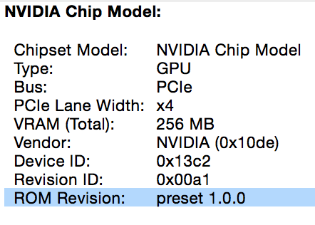

fupia Posted July 4, 2015 Share Posted July 4, 2015 Hi folks, I'm new to the forum, but have developed an interest in e-GPU setups after reading up on how the folks at Mediapros were able to put together a customized video editing rig. I've done some additional reading here and other websites and decided to attempt to put together a somewhat mobile e-GPU rig. Actually, it isn't so mobile now since I can't put the cover back on it because the GPU card is sticking out by a centimeter. :/ This past week, I purchased a Gigabyte GTX 970 Mini and a Akitio Thunder2 PCIe Box for my Early 2015 rMBP 13-inch running Yosemite 10.10.3. I've followed all the instructions (not sure if I might've missed a few steps), but I think I hit a wall at this point. My rMBP is detecting it but it's showing the following (see attached image): I greatly appreciate it if anyone can help! In the mean time I'll continue to scour forums and websites for any possible solutions to this. Thanks! Quote Link to comment Share on other sites More sharing options...
Dschijn Posted July 4, 2015 Share Posted July 4, 2015 @fupia: Well yeah… the Gigabyte card is too wide. Did you run the cript from goalque? http://forum.techinferno.com/mac-os-x-discussion/10289-script-enabling-nvidia-egpu-screen-output-os-x.html Quote Link to comment Share on other sites More sharing options...

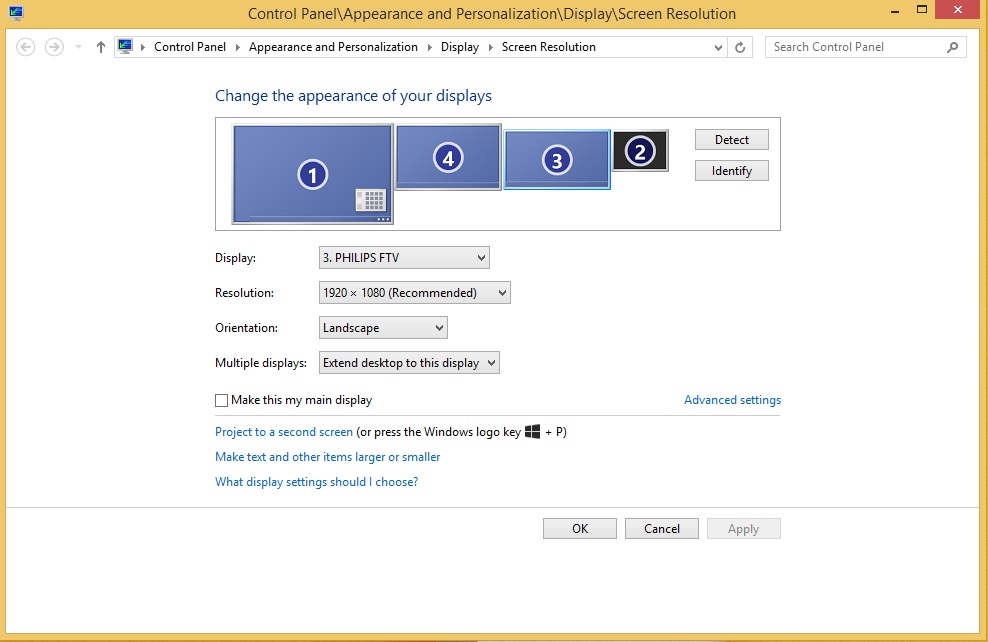

Dschijn Posted July 4, 2015 Share Posted July 4, 2015 Dschijn Do you know why I have nothing appearing on my external display? (using HDMI) OSX? Windows? Could you please put your Mac+eGPU into your signature, so I know what your setup is Quote Link to comment Share on other sites More sharing options...

Dschijn Posted July 4, 2015 Share Posted July 4, 2015 Windows 8.1. Here where i put my setup: On this page http://forum.techinferno.com/diy-e-gpu-projects/7910-diy-egpu-macbook-experiences-113.html I got monitors working on DVI and HDMI: Quote Link to comment Share on other sites More sharing options...

fupia Posted July 5, 2015 Share Posted July 5, 2015 @fupia: Well yeah… the Gigabyte card is too wide. Did you run the cript from goalque? http://forum.techinferno.com/mac-os-x-discussion/10289-script-enabling-nvidia-egpu-screen-output-os-x.htmlThanks for the response @Dschijin! Just tried it. After restarting, it's now only showing the intel graphics card and not detecting the GTX 970 in the system report. Before running the script, it'll at least show an NVIDIA card, but not specifying the model.I thought the kext files might've been reset. So I tried to edit the kext files again. Still, it isn't detecting the GPU. Quote Link to comment Share on other sites More sharing options...
