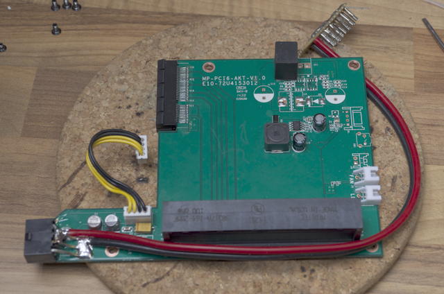

@weecooper:
Since nobody answered to my post #881 i´ve do it by t&e. What should is say, one step will work, the GTX660Ti is accesible. :D
@All:
There is also an other solution to get power into the enclosure if some tools (aka. soldering Iron, mini drilling machine) your friends, and you are willing to invest some work, .
Here´s a little workaround In short:
desoldered the barrel jack from the PCB
make some solder points on the PCB
desoldered the power connector form a Dell Optiplex GX620
solder the new power connector to the PCB
solder two wires for to power the PCIe plugs of the GTX
Plug in the jack from a Dell DA-2, power up the system, lean back and enjoy
:54_002: OMG, your warranty void if you do so :67: , sh** happens, but it works quite fine for me
little Impression:
Once all my works finished i´ll illustrate and describe more detailed what i've done.
Greetings
@seefew: Good job! Love the very minimalistic wiring. Keeps the inner case very clean. Inside mine it's kind of messy.
The wire for the 2*6-Pin PCIe plugs are thick enough to carry 12V and 12-13amps?
the calculated value is anywhere between 15 & 20A for this diameter and length.
A test run of 3h of rendering gives only minimal raising temps on the wires
If i find time i´ll measue the real values.
