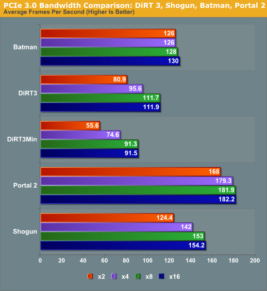

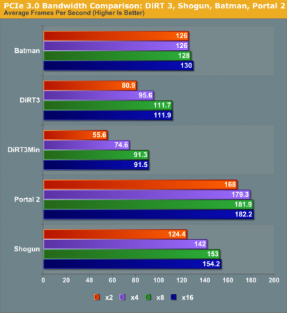

The tb2 will run at 16gbps due to the way pci-e is built - which is equivalent to PCIe 2 x4 (or PCIe 3 x2) = 2GB/s , TB1 would be theoretical half that speed.
Check out anadtech's article about the PCI-e impact on the bandwidth.
Finally if we take one further step to PCIe 3 x2 (2GB/sec), we see performance continue to drop on a game-by-game basis. Crysis, Metro, Civilization V, and Battlefield 3 still hold rather steady, having lost less than 5% of their performance versus PCIe 3 x16, but DiRT 3 continues to fall, while Total War: Shogun and Portal 2 begin to buckle. At these speeds DiRT3 is only 72% of its original performance, while Shogun and Portal 2 are at 81% and 92% respectively.
As you can see - It seems like the bandwidth needed for something of the scale of a HD7970 requires at least 16Gbps, and if you decrease that by using TB1 you would theoretical see a way higher deduction in FPS.
Bare in mind - this is just the results for these games, other games showed minimum significance, but lets assume worst case scenario.
