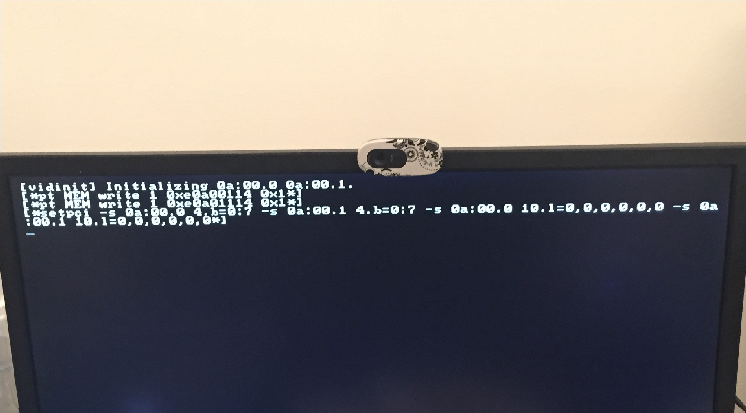

Hello all,
I have followed the setup from Karthikrajanv's guide and have managed to setup my eGPU to some success. My MBPr is able to setup the external display, but the eGPU part is not working. I was basically running multiple display with my 650M, while my 980 was idle (altho the fan is still on). Also, it is relatively unknown how I manage to display my screen on the external display. Sometimes my MBP starts on internal display and sometimes external. The DIY egpu menu also does not retain the settings, which means every time I boot up I have to rerun the setup procedure. Does anyone know why my card is not working, while the external display is actually on?
*Nvidia Control Panel cannot be opened if external display is working. Does not detect eGPU if only internal display managed to turn on.
*this screen pops up when I attempt to initialize eGPU everytime only at external display and gets stuck here:
[ATTACH=CONFIG]13999[/ATTACH]
Thank you!
If you hit F3 after a command you want, it will add it to your startup.bat. Then when you boot Setup 1.30 and let it run the default 'automated startup via startup.bat' it will run all your previous settings done via the menus.
You can see the vidinit is halting the system in that screenshot. I'd expect that to happen if in that instance that output was being sent to the external LCD. I've read on here that if people disconnnect the LCD fromt he eGPU then the apple firmware will boot using the internal LCD, as is required.
