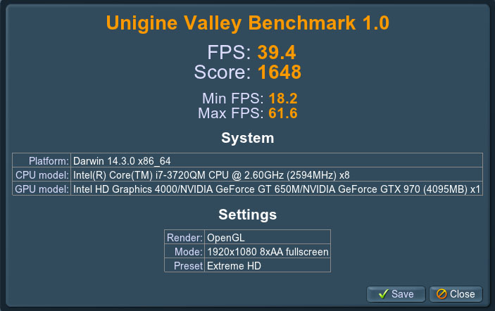

w4vz Posted May 31, 2015 Share Posted May 31, 2015 Looking at your heaven benchmark results I realised that I have a lot less. around 1200 each time on extreme. Your test shows 1819 so that is a big difference. Do you think it is all down to TB2 vs TB1 ? Quote Link to comment Share on other sites More sharing options...
Dschijn Posted May 31, 2015 Author Share Posted May 31, 2015 @w4vz: Please don't mix! There are two Unigine benchmarks:- Heaven- ValleyFor Valley ExtremeHD I had in Windows 8.1:- internal display: 1922- external display: 2104- desktop computer: 2274For Valley ExtremeHD I had in OSX 10.10:- external display 1895So, which OS are you referring to? Which MB model? Which GPU? 1 Quote Link to comment Share on other sites More sharing options...
w4vz Posted May 31, 2015 Share Posted May 31, 2015 @w4vz: Please don't mix! There are two Unigine benchmarks:- Heaven- ValleyFor Valley ExtremeHD I had in Windows 8.1:- internal display: 1922- external display: 2104- desktop computer: 2274For Valley ExtremeHD I had in OSX 10.10:- external display 1895So, which OS are you referring to? Which MB model? Which GPU?Sorry I confused heaven with valley. I'll try to benchmark valley myself and compare. Quote Link to comment Share on other sites More sharing options...
w4vz Posted May 31, 2015 Share Posted May 31, 2015 Got 1648. Still a loss comparatively to yours even :/ You have an I5 so the only thing I can see is either TB2 or Driver optimisation. Quote Link to comment Share on other sites More sharing options...
Dschijn Posted May 31, 2015 Author Share Posted May 31, 2015 There could be two reasons:- TB1 vs TB2 - your GTX 970 modelFor my benchmarks I used the first GTX 970 I had, the MSI 4G Gaming. If you just have a EVGA GTX 970 without SSC or FTW "tuning" your card will run at lower clock speeds. The MSI I used is running on a factory overclocked clock speed. Quote Link to comment Share on other sites More sharing options...
w4vz Posted May 31, 2015 Share Posted May 31, 2015 Could be the clocking. I run an evga 970 4gb so not overclocked i think. I suspect more TB but no way to monitor the bus load under osx. Quote Link to comment Share on other sites More sharing options...
