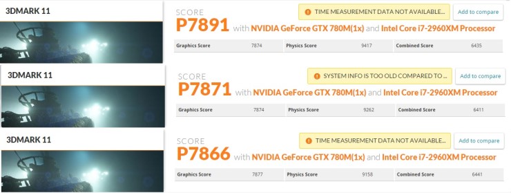

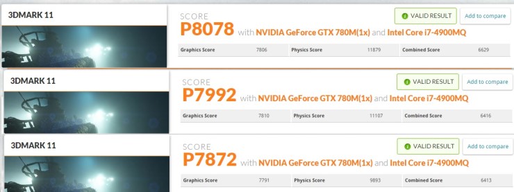

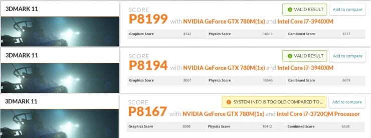

For better understanding, I am posting pics.
just look at the graphic score of each of three generation.
All stock GPU clock.

So what I did was, I removed the same 780m from AW17 and put it on m17x R4.
Very good experiment to show how bad AW17's GPU PCIE is.
I believe there isn't a better one.
And the results are that AW17 has a 3-4% disadvantage in GPU score than m17x R4.
And the worst thing is if you compare a better GPU like 880m, the absolute GPU score difference gets bigger.
Which implies the score difference is not in "absolute value" but in percentage(3-4%).
Even worse thing is that AW17 has a worse slight graphic score than m17x R3 which has PCIE 2.0 while m17x R4 and AW17 are known to have PCIE3.0.
