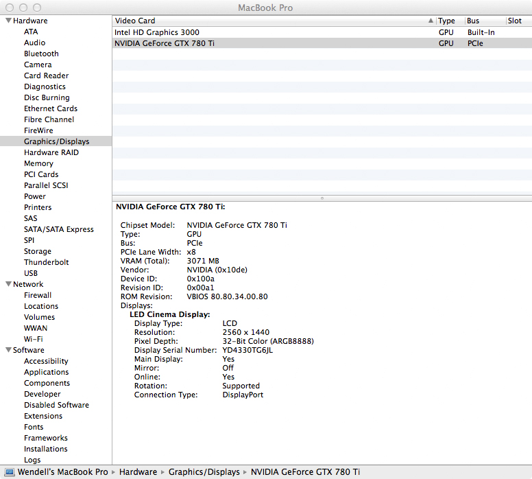

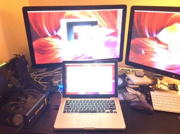

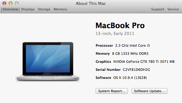

Hello Guys, I would like to share my Sonnet III-D experience. So basically I bite the bullet. I bought an open-box Sonnet III-D for 700$. Sold my ASUS Gaming Monitor and purchased a refurbished 27 Apple Cinema Display. I used a female mini DVI to DisplayPort adapter to connect the Apple Cinema Display to the GPU. I really hate the washed out display of the ASUS monitor. Basically, I am an Apple Guy! LOL.
I returned my GTX 770 4GB and replaced with the GTX 780 Ti 3GB.

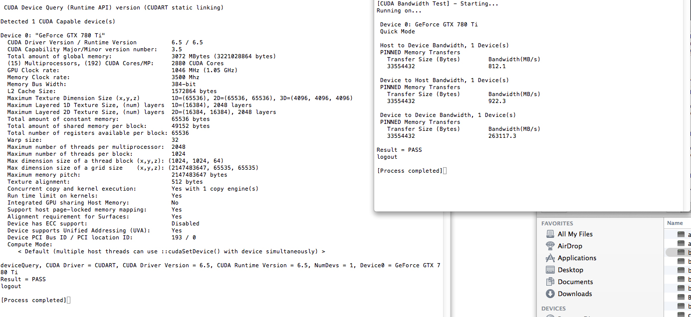

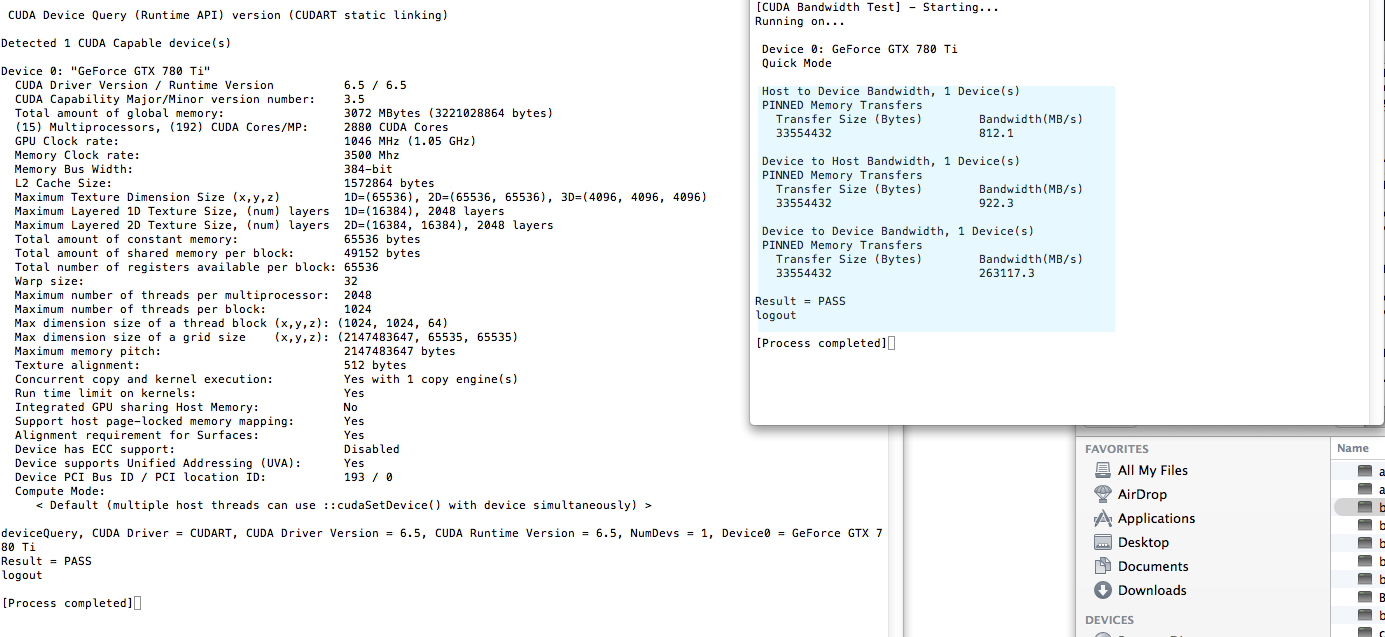

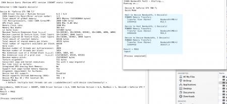

So here we go, I plug my GPU to Sonnet and ran the my Mac Mini, it was expected to work like a charm. Then, I tested my old MBP 13-inch 2011, Installed the CUDA drivers and NVIDIA drivers, and boom! :)
Basically the setup and guide is similar to my previous guide on Mac Mini using AkiTio [GUIDE] Mac Mini 2012 + GTX770@10Gbps-TB1 (AKiTiO Thunder2) + OSX 10.9.4

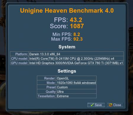

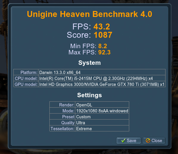

Here are the photos and benchmark.

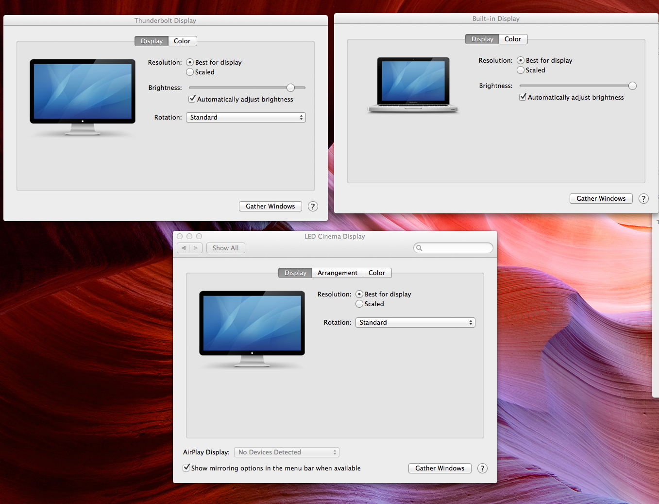

Plug-in my Thunderbolt display to the extra TB port in Sonnet. And the extend and mirror display function was fabulous!!!!!!!!
The reason I purchase this Sonnet is because my frustration of the constant freezing of the AkiTio. I am still investigating why I do got the kernel panic from time to time. With the Sonnet III-D. I've been playing steam game (DOTA 2) the whole day today and the graphics was really really awesome under 2560x1440 high setting!!!! Performed some Adobe Premiere editing and some photoshop CS5 3D modeling. Never I experience any issue!!!

Are you going to mod the Sonnets PSU to get rid the Corsair? Sth like kryzaach did?
http://forum.techinferno.com/diy-e-gpu-projects/7685-%5Bguide%5D-2013-11-macbook-air-titan%4010gbps-tb1-sonnet-iii-d-osx-10-9-4-a.html
For now no. yeah the enclosure is cool.. But for the price you'll be really want to justify your purchase ...
Have you run this setup on Unigine Valley for at least a couple of hours? I'm thinking of throwing money into a III-D enclosure too if this is a truly stable option!
Yes very stable. Never got any kernel panic or freezing... I even run LuxMark and UniEngine high settings at the same time for 2 consecutive times. Play steam games(high setting 2550x1460) straight 3hrs.
@entzoe Can you use Macbook in OSX without external display?
Only If you use rMBP 2013 up (via optimus in Windows). Mac OS you need an external screen otherwise the internal GPU kicks in if you use MBP screen
