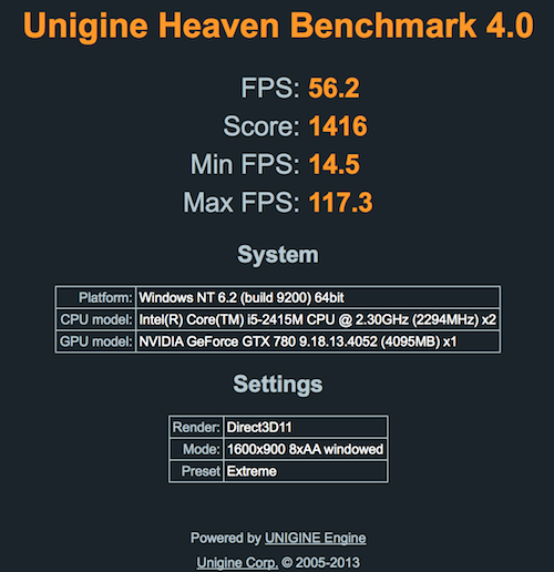

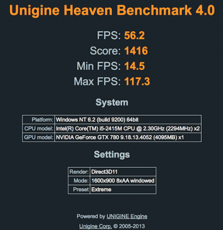

PERFORMANCE
3DMark11 (graphics) 11438 (This is actually very close the graphics score 11832 @16Gbps with 15" MBPr). TB1 is not a big bottleneck here.

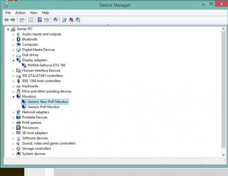

Thanks for sharing your benchmark results. What method did you use to install Win 8.1 on your Mac mini? Is it a standard Boot Camp installation? I tried it and also diskpart commands, but no success when installing on the secondary 500GB drive. The secondary drive might be a reason. I haven't tested installing Win8.1 on the 64GB SSD drive (OSX works well on it).
EDIT: I noticed that your internal graphics is not visible in the device manager / display adapters. I have both the Intel HD Graphics 3000 and GTX 780 listed there.
