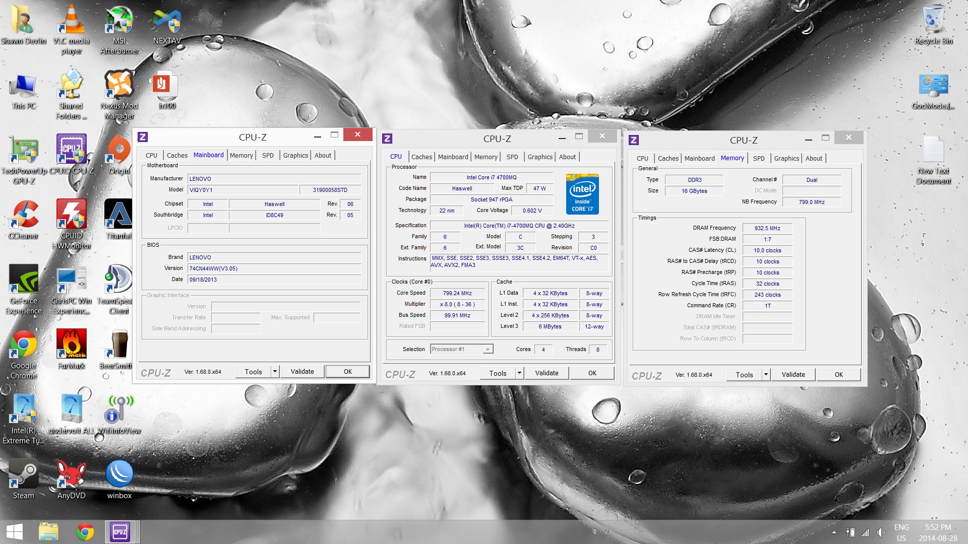

Varroa Posted August 28, 2014 Share Posted August 28, 2014 I never said it made a huge difference. I bought the ram for a different purpose but it wasn't compatible so I switched it with the ram that came stock in the Y510p. Here is my screen shots: Quote Link to comment Share on other sites More sharing options...
allstone Posted September 1, 2014 Share Posted September 1, 2014 I never said it made a huge difference. I bought the ram for a different purpose but it wasn't compatible so I switched it with the ram that came stock in the Y510p. Here is my screen shots:Varroa, are those gskill?Btw, have you tried putting 2x 16GB RAM by any chance? As so, it confirms that y510p RAM can be put and runs at 1866 in dual channel because motherboard and chip support it. The question is - does that mean that all communication channels between 4700mq CPU through dice/motherboard up to RAM itself support this and are running at this speed really? In other words, is there a way to know if bus is bottlenecking in this case or not ? Quote Link to comment Share on other sites More sharing options...
Varroa Posted September 1, 2014 Share Posted September 1, 2014 Those are 2 x 8 GB Gskill ripjaws. Quote Link to comment Share on other sites More sharing options...
