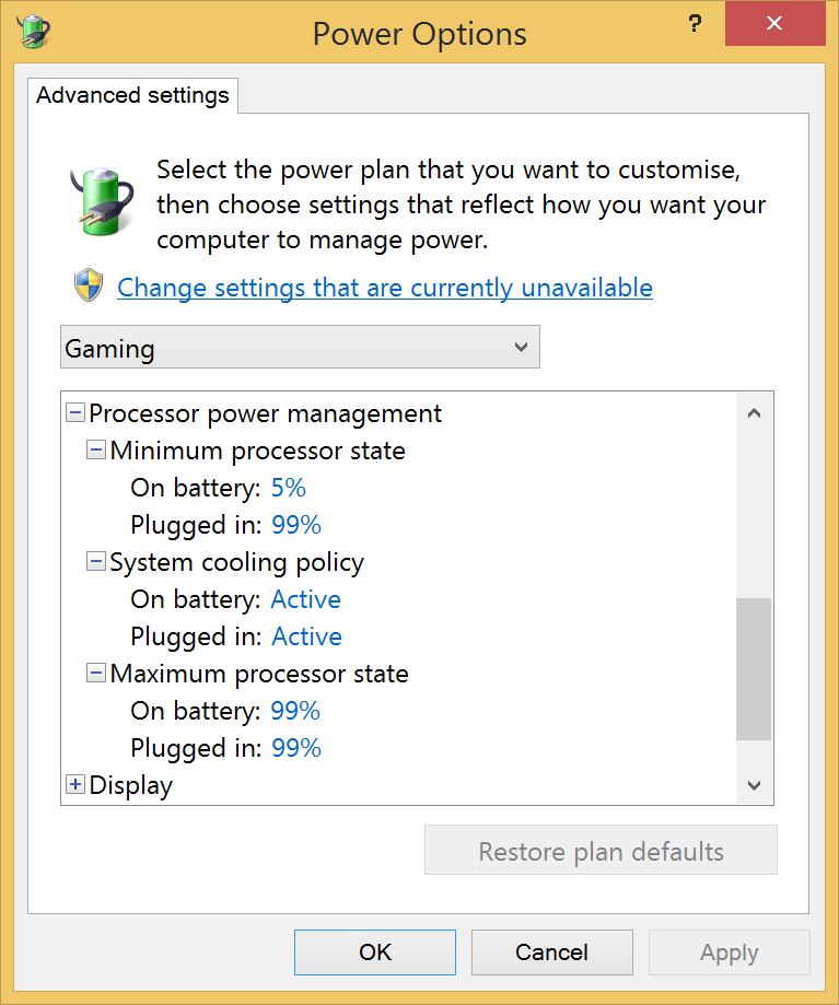

The mid 2014 MacBook Pro 15" Iris only is completely silent during gaming when using power options settings as shown below (disables the Turbo Boost up to 3.4Ghz that causes fan noise on CPU intensive games).
[ATTACH=CONFIG]12306[/ATTACH]

If you play a very cpu intensive game, the macbook will become very loud.
Disable turboboost is mandatory to keep it silent.
