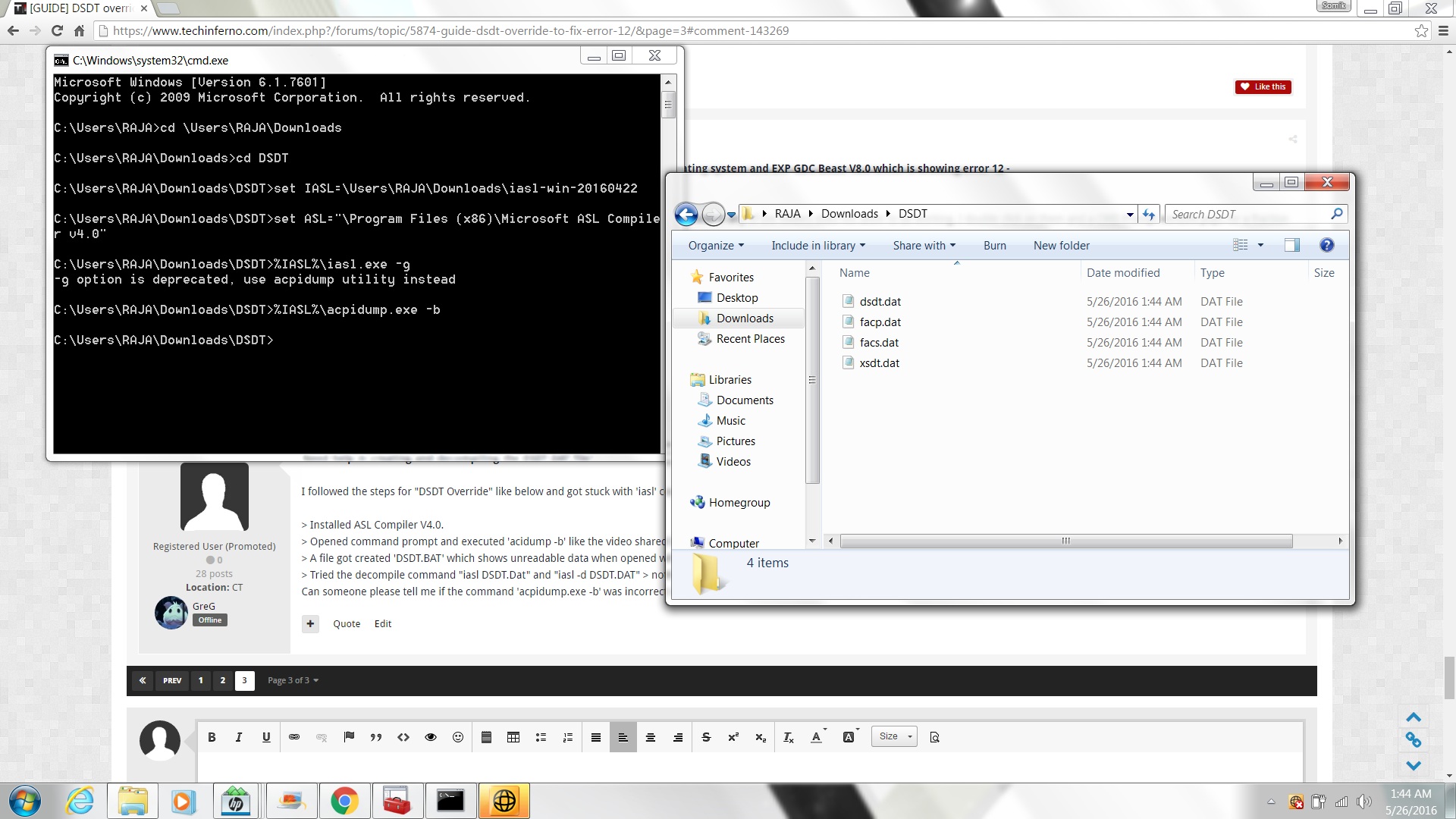

Hi All,
Need help in creating and decompiling the DSDT.DAT file?
I followed the steps for "DSDT Override" like below and got stuck with 'iasl' command.
> Installed ASL Compiler V4.0.
> Opened command prompt and executed 'acidump -b' like the video shared by Kizwan
> A file got created 'DSDT.BAT' which shows unreadable data when opened with Notepad++
> Tried the decompile command "iasl DSDT.Dat" and "iasl -d DSDT.DAT" > nothing happened. I didnt get the file 'DSDT.dsl'
Can someone please tell me if the command 'acpidump.exe -b' was incorrect or 'iasl dsdt.dat' was incorrect. How can i decomplie the file?
Edited by Somik

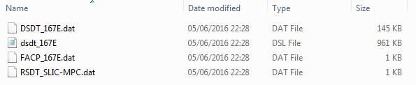

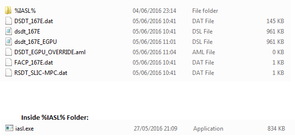

Hi, the steps which I followed was everything within the video I quoted,
the files which I used was:  (ive attached a screenshot image)
There was a .aml file produced to (called : DSDT_EGPU_OVERRIDE)
If needed i can re follow the tutorial (video) and screenshot the errors.

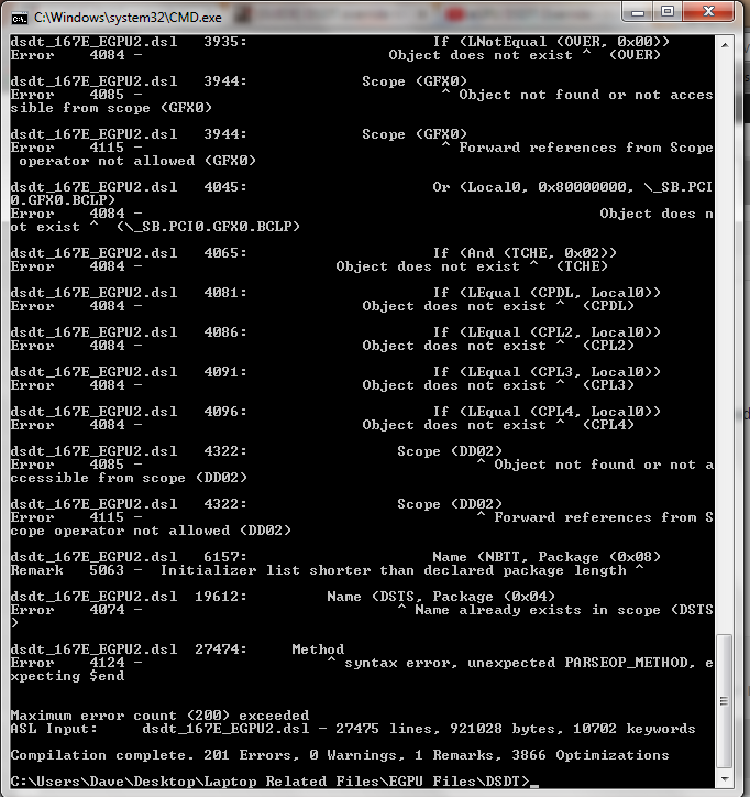

But when I was in cmd there was errors at the end. I will redo the DSDT Override via the video tutorial and take note of the errors. I will do this now and reply soon.

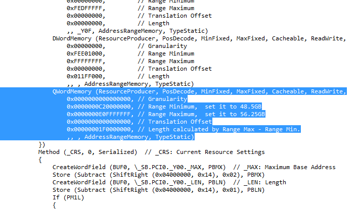

1 hour ago, utopian201 said:
I have just tried to do the DSDT Override again, but 201 errors appeared.
the code I have used is out of the guide you listed above:
QWordMemory (ResourceProducer, PosDecode, MinFixed, MaxFixed, Cacheable, ReadWrite,
             0x0000000000000000, // Granularity
            0x0000000C20000000, // Range Minimum,  set it to 48.5GB
             0x0000000E0FFFFFFF, // Range Maximum,  set it to 56.25GB
             0x0000000000000000, // Translation Offset
            0x00000001F0000000, // Length calculated by Range Max - Range Min.
                  ,, , AddressRangeMemory, TypeStatic)
this is what cmd outputted last:
 ScreenShot #a1.png#
thanks. + what page number is it you added extra info on the guide you mentioned above (so i can see your info).

dsdt.dsl   3745:                     Return (LNot (DRDY))
Error    4084 -                Object does not exist ^  (DRDY)
dsdt.dsl   3752:                         Sleep (ASLP)
Error    4084 -             Object does not exist ^  (ASLP)
dsdt.dsl   3765:                     Store (Arg0, CEVT)
Error    4084 -               Object does not exist ^  (CEVT)
dsdt.dsl   3767:                     If (LAnd (LEqual (CHPD, 0x00), LEqual (Arg1
, 0x00)))
Error    4084 -                    Object does not exist ^  (CHPD)
dsdt.dsl   3790:                         Store (0x00, CEVT)
dsdt.dsl   3798:                     Store (Arg0, TIDX)
Error    4084 -               Object does not exist ^  (TIDX)
dsdt.dsl   3804:                     Store (Arg0, CLID)
Error    4088 -                                     ^ Object is not accessible f
rom this scope (CLID)
dsdt.dsl   3810:                     Store (Arg0, CDCK)
Error    4084 -               Object does not exist ^  (CDCK)
dsdt.dsl   3816:                     If (LNot (ARDY))
Error    4084 -            Object does not exist ^  (ARDY)
dsdt.dsl   3818:                         Sleep (ASLP)
dsdt.dsl   3821:                     Return (LNot (ARDY))
dsdt.dsl   3826:                     If (LNot (And (TCHE, ShiftLeft (0x01, Arg0)
Error    4084 -                 Object does not exist ^  (TCHE)
dsdt.dsl   3838:                         If (CPFM)
Error    4084 -          Object does not exist ^  (CPFM)
dsdt.dsl   3840:                             And (CPFM, 0x0F, Local0)
dsdt.dsl   3841:                             And (EPFM, 0x0F, Local1)
Error    4084 -               Object does not exist ^  (EPFM)
dsdt.dsl   3846:                                     Store (0x06, PFIT)
Error    4084 -                               Object does not exist ^  (PFIT)
dsdt.dsl   3852:                                         Store (0x08, PFIT)
dsdt.dsl   3856:                                         Store (0x01, PFIT)
dsdt.dsl   3865:                                     Store (0x08, PFIT)
dsdt.dsl   3871:                                         Store (0x01, PFIT)
dsdt.dsl   3875:                                         Store (0x06, PFIT)
dsdt.dsl   3884:                                     Store (0x01, PFIT)
dsdt.dsl   3890:                                         Store (0x06, PFIT)
dsdt.dsl   3894:                                         Store (0x08, PFIT)
dsdt.dsl   3901:                             XOr (PFIT, 0x07, PFIT)
dsdt.dsl   3904:                         Or (PFIT, 0x80000000, PFIT)
dsdt.dsl   3905:                         Store (0x04, ASLC)
Error    4084 -                   Object does not exist ^  (ASLC)
dsdt.dsl   3911:                             Store (Arg1, BCLP)
Error    4084 -                       Object does not exist ^  (BCLP)
dsdt.dsl   3912:                             Or (BCLP, 0x80000000, BCLP)
dsdt.dsl   3913:                             Store (0x02, ASLC)
dsdt.dsl   3919:                                 Store (Arg1, ALSI)
Error    4084 -                           Object does not exist ^  (ALSI)
dsdt.dsl   3920:                                 Store (0x01, ASLC)
dsdt.dsl   3929:                     Store (0x01, ASLE)
Error    4084 -               Object does not exist ^  (ASLE)
dsdt.dsl   3935:                     If (LNotEqual (OVER, 0x00))
Error    4084 -                 Object does not exist ^  (OVER)
dsdt.dsl   3944:             Scope (GFX0)
Error    4085 -                       ^ Object not found or not accessible from
scope (GFX0)
Error    4115 -                       ^ Forward references from Scope operator n
ot allowed (GFX0)
dsdt.dsl   4045:                     Or (Local0, 0x80000000, \_SB.PCI0.GFX0.BCLP
 (\_SB.PCI0.GFX0.BCLP)
dsdt.dsl   4065:                     If (And (TCHE, 0x02))
dsdt.dsl   4081:                     If (LEqual (CPDL, Local0))
Error    4084 -              Object does not exist ^  (CPDL)
dsdt.dsl   4086:                     If (LEqual (CPL2, Local0))
Error    4084 -              Object does not exist ^  (CPL2)
dsdt.dsl   4091:                     If (LEqual (CPL3, Local0))
Error    4084 -              Object does not exist ^  (CPL3)
dsdt.dsl   4096:                     If (LEqual (CPL4, Local0))
Error    4084 -              Object does not exist ^  (CPL4)
dsdt.dsl   4322:                 Scope (DD02)
rom scope (DD02)
or not allowed (DD02)
dsdt.dsl   6157:                     Name (NBTT, Package (0x08)
Remark   5063 -                                             ^ Initializer list s
horter than declared package length
dsdt.dsl  19612:         Name (DSTS, Package (0x04)
Error    4074 -                  ^ Name already exists in scope (DSTS)
dsdt.dsl  27474:     Method
Error    4124 -          ^ syntax error, unexpected PARSEOP_METHOD, expecting $e
nd
Maximum error count (200) exceeded
ASL Input:     dsdt.dsl - 27475 lines, 921001 bytes, 10702 keywords
Compilation complete. 201 Errors, 0 Warnings, 1 Remarks, 0 Optimizations
C:\Users\Dave\Desktop\Laptop Related Files\EGPU Files\DSDT>
Any Ideas? (I guess I have to try and eliminate the errors to a total of 0?)
Many Thanks.

Hi, the output from %IASL%\iasl.exe -g
outputted the following:
Microsoft Windows [Version 6.1.7601]
Copyright (c) 2009 Microsoft Corporation.  All rights reserved.
C:\Windows\system32>cd C:\Users\Dave\Desktop\EGPU
C:\Users\Dave\Desktop\EGPU>mkdir DSDT
A subdirectory or file DSDT already exists.
C:\Users\Dave\Desktop\EGPU>cd DSDT
C:\Users\Dave\Desktop\EGPU\DSDT>set IASL=\Users\Dave\Desktop\EGPU\iasl-win-20120
620
C:\Users\Dave\Desktop\EGPU\DSDT>set ASL="\Program Files (x86)\Microsoft ASL Comp
iler v4.0"
C:\Users\Dave\Desktop\EGPU\DSDT>%IASL%\iasl.exe -g
Intel ACPI Component Architecture
ASL Optimizing Compiler version 20120620-32 [Jun 20 2012]
Copyright (c) 2000 - 2012 Intel Corporation
Table [RSDT] obtained from registry, 116 bytes
Table [RSDT] written to "RSDT_SLIC-MPC.dat"
There are 10 tables defined in the XSDT
Table [FACP] obtained from registry, 244 bytes
Table [FACP] written to "FACP_167E.dat"
Table [DSDT] obtained from registry, 147893 bytes
Table [DSDT] written to "DSDT_167E.dat"
Disassembly of DSDT
Pass 1 parse of [DSDT]
Pass 2 parse of [DSDT]
Parsing Deferred Opcodes (Methods/Buffers/Packages/Regions)
Parsing completed
Found 2 external control methods, reparsing with new information
Parsing completed
ACPI Warning: NsLookup: Type mismatch on HASH (RegionField), searching for (Buff
er) (20120620/nsaccess-731)
Disassembly completed
ASL Output:    dsdt_167E.dsl - 983583 bytes
that outputted the file: "dsdt_167E" (seen below)
I then edited that file in notepad (inputted the folowing in blue):
saved as  "dsdt_167E_EGPU.dsl"
(original file name: dsdt_167E.dsl)
I then inputted
%iasl%\iasl dsdt_167E_EGPU.dsl
into cmd and that then outputted:
, 0x11), PARM)
 not exist ^  (PARM)
dsdt_167E_EGPU.dsl   3672:                             Or (ShiftLeft (DerefOf (I
ndex (DerefOf (Index (CDCT, HVCO)), CDVL
Error    4084 -
                Object does not exist ^  (CDVL)
dsdt_167E_EGPU.dsl   3673:                                 )), 0x15), PARM, PARM
Error    4084 -                                   Object does not exist ^  (PARM
 (PARM)
dsdt_167E_EGPU.dsl   3674:                             Store (0x01, GESF)
Error    4084 -                                 Object does not exist ^  (GESF)
dsdt_167E_EGPU.dsl   3678:                         If (LEqual (GESF, 0x0A))
dsdt_167E_EGPU.dsl   3680:                             Store (0x00, PARM)
Error    4084 -                                 Object does not exist ^  (PARM)
dsdt_167E_EGPU.dsl   3681:                             Store (0x00, GESF)
dsdt_167E_EGPU.dsl   3685:                         Store (Zero, GESF)
dsdt_167E_EGPU.dsl   3691:                         If (LEqual (GESF, 0x00))
dsdt_167E_EGPU.dsl   3693:                             Store (0x00, PARM)
dsdt_167E_EGPU.dsl   3694:                             Store (0x000F87FD, PARM)
PARM)
dsdt_167E_EGPU.dsl   3695:                             Store (0x40, PARM)
dsdt_167E_EGPU.dsl   3696:                             Store (Zero, GESF)
dsdt_167E_EGPU.dsl   3700:                         If (LEqual (GESF, 0x07))
dsdt_167E_EGPU.dsl   3702:                             If (LEqual (PARM, 0x00))
dsdt_167E_EGPU.dsl   3704:                                 Store (CLID, Local0)
Error    4088 -            Object is not accessible from this scope ^  (CLID)
dsdt_167E_EGPU.dsl   3707:                                     And (CLID, 0x0F,
CLID)
CLID)
e ^  (CLID)
dsdt_167E_EGPU.dsl   3708:                                     GLID (CLID)
dsdt_167E_EGPU.dsl   3712:                             Store (Zero, GESF)
dsdt_167E_EGPU.dsl   3713:                             Store (Zero, PARM)
dsdt_167E_EGPU.dsl   3717:                         Store (Zero, GESF)
dsdt_167E_EGPU.dsl   3721:                     If (LEqual (GEFC, 0x04))
Error    4084 -                        Object does not exist ^  (GEFC)
dsdt_167E_EGPU.dsl   3723:                         Store (GBDA (), GXFC)
Error    4084 -                                Object does not exist ^  (GXFC)
dsdt_167E_EGPU.dsl   3726:                     If (LEqual (GEFC, 0x06))
dsdt_167E_EGPU.dsl   3728:                         Store (SBCB (), GXFC)
dsdt_167E_EGPU.dsl   3731:                     Store (0x00, GEFC)
dsdt_167E_EGPU.dsl   3733:                     Store (0x00, GSSE)
Error    4084 -                         Object does not exist ^  (GSSE)
dsdt_167E_EGPU.dsl   3734:                     Store (0x00, SCIE)
Error    4084 -                         Object does not exist ^  (SCIE)
dsdt_167E_EGPU.dsl   3740:                     If (LNot (DRDY))
dsdt_167E_EGPU.dsl   3742:                         Sleep (ASLP)
dsdt_167E_EGPU.dsl   3745:                     Return (LNot (DRDY))
dsdt_167E_EGPU.dsl   3752:                         Sleep (ASLP)
dsdt_167E_EGPU.dsl   3765:                     Store (Arg0, CEVT)
dsdt_167E_EGPU.dsl   3767:                     If (LAnd (LEqual (CHPD, 0x00), LE
qual (Arg1, 0x00)))
dsdt_167E_EGPU.dsl   3790:                         Store (0x00, CEVT)
dsdt_167E_EGPU.dsl   3798:                     Store (Arg0, TIDX)
dsdt_167E_EGPU.dsl   3804:                     Store (Arg0, CLID)
dsdt_167E_EGPU.dsl   3810:                     Store (Arg0, CDCK)
dsdt_167E_EGPU.dsl   3816:                     If (LNot (ARDY))
dsdt_167E_EGPU.dsl   3818:                         Sleep (ASLP)
dsdt_167E_EGPU.dsl   3821:                     Return (LNot (ARDY))
dsdt_167E_EGPU.dsl   3826:                     If (LNot (And (TCHE, ShiftLeft (0
x01, Arg0))))
dsdt_167E_EGPU.dsl   3838:                         If (CPFM)
dsdt_167E_EGPU.dsl   3840:                             And (CPFM, 0x0F, Local0)
dsdt_167E_EGPU.dsl   3841:                             And (EPFM, 0x0F, Local1)
dsdt_167E_EGPU.dsl   3846:                                     Store (0x06, PFIT
 (PFIT)
dsdt_167E_EGPU.dsl   3852:                                         Store (0x08,
PFIT)
t ^  (PFIT)
dsdt_167E_EGPU.dsl   3856:                                         Store (0x01,
PFIT)
t ^  (PFIT)
dsdt_167E_EGPU.dsl   3865:                                     Store (0x08, PFIT
 (PFIT)
dsdt_167E_EGPU.dsl   3871:                                         Store (0x01,
PFIT)
t ^  (PFIT)
dsdt_167E_EGPU.dsl   3875:                                         Store (0x06,
PFIT)
t ^  (PFIT)
dsdt_167E_EGPU.dsl   3884:                                     Store (0x01, PFIT
 (PFIT)
dsdt_167E_EGPU.dsl   3890:                                         Store (0x06,
PFIT)
t ^  (PFIT)
dsdt_167E_EGPU.dsl   3894:                                         Store (0x08,
PFIT)
t ^  (PFIT)
dsdt_167E_EGPU.dsl   3901:                             XOr (PFIT, 0x07, PFIT)
IT)
dsdt_167E_EGPU.dsl   3904:                         Or (PFIT, 0x80000000, PFIT)
FIT)
dsdt_167E_EGPU.dsl   3905:                         Store (0x04, ASLC)
dsdt_167E_EGPU.dsl   3911:                             Store (Arg1, BCLP)
dsdt_167E_EGPU.dsl   3912:                             Or (BCLP, 0x80000000, BCL
P)
P)
  (BCLP)
dsdt_167E_EGPU.dsl   3913:                             Store (0x02, ASLC)
dsdt_167E_EGPU.dsl   3919:                                 Store (Arg1, ALSI)
SI)
dsdt_167E_EGPU.dsl   3920:                                 Store (0x01, ASLC)
LC)
dsdt_167E_EGPU.dsl   3929:                     Store (0x01, ASLE)
dsdt_167E_EGPU.dsl   3935:                     If (LNotEqual (OVER, 0x00))
dsdt_167E_EGPU.dsl   3944:             Scope (GFX0)
ible from scope (GFX0)
operator not allowed (GFX0)
dsdt_167E_EGPU.dsl   4045:                     Or (Local0, 0x80000000, \_SB.PCI0
.GFX0.BCLP)
t exist ^  (\_SB.PCI0.GFX0.BCLP)
dsdt_167E_EGPU.dsl   4065:                     If (And (TCHE, 0x02))
dsdt_167E_EGPU.dsl   4081:                     If (LEqual (CPDL, Local0))
dsdt_167E_EGPU.dsl   4086:                     If (LEqual (CPL2, Local0))
dsdt_167E_EGPU.dsl   4091:                     If (LEqual (CPL3, Local0))
dsdt_167E_EGPU.dsl   4096:                     If (LEqual (CPL4, Local0))
dsdt_167E_EGPU.dsl   4322:                 Scope (DD02)
cessible from scope (DD02)
ope operator not allowed (DD02)
dsdt_167E_EGPU.dsl   6157:                     Name (NBTT, Package (0x08)
Remark   5063 - Initializer list shorter than declared package length ^
dsdt_167E_EGPU.dsl  19612:         Name (DSTS, Package (0x04)
dsdt_167E_EGPU.dsl  27474:     Method
pecting $end
ASL Input:     dsdt_167E_EGPU.dsl - 27475 lines, 921010 bytes, 10702 keywords
Compilation complete. 201 Errors, 0 Warnings, 1 Remarks, 3866 Optimizations
