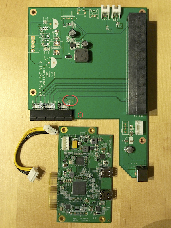

Arclite Posted August 25, 2014 Share Posted August 25, 2014 Where can 12V and GND be soldered onto the PCIe board as a ATX PSU compatible molex plug so a PCIe riser isn't used? Firstly, soldering onto any part of the AKiTiO internals isn't for everyone. You'd pretty much be blowing your warranty away. So as a service for those who aren't fazed by warranty loss, pls proceed to: - check if the 12V PCIe slot pins are all tied together. If not, use only the 12V pins that are registering 12V on them for continuity tests. - from the 12V pins do continuity tests against pads on the PCIe board to find suitable tap off pads. There are some silkscreen outlines headers on the upper left corner and top of the picture you posted (above) which would be a good place to start. Once you find the 12V points, check nearby locations for GND pins. According to the PCI spec pins 2,3 on side A and pins 1,2,3 on side B provide +12V to the PCIe connector. Pin 4 on side A and pin 4 on side B are ground pins. So, basically all +12V pins (2,3 side A; 1,2,3 side should be wired to the yellow cable on the molex connector and the ground pins (4 side A, 4 side should be wired to the black cable on the molex connector. That means we should identify where are these pins on the back side of the board. I highlighted the region where these pins should be. @Tech Inferno Fan Is this correct? Also, maybe there is another option. It is a little far fetched but I'd like to discuss it here. I'm thinking to create a female-female PCIe 4x to x16 powered riser. In order to do that I want to combine a male-female x16 to x16 powered PCIe riser and a male-female x4 to x4 PCIe riser so that the final adapter has only female-female connectors. Will such an adapter work ? On the AKiTiO board there are a lot of other components which I have no idea what is their purpose. Maybe there is a clock there, which provides the frequency for the whole board. If so, using a female-female adapter will not be possible as there is no clock. What are you thoughts about this? Quote Link to comment Share on other sites More sharing options...

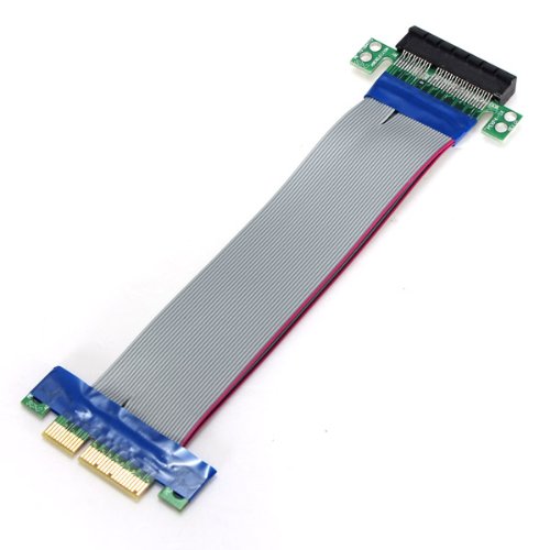

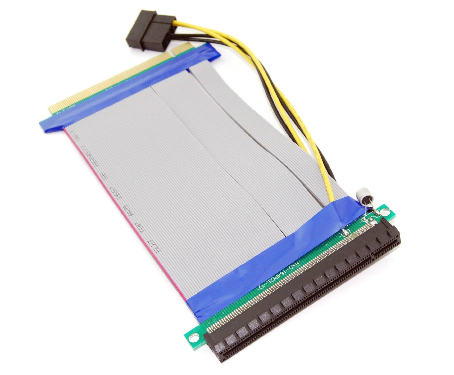

Tech Inferno Fan Posted August 25, 2014 Author Share Posted August 25, 2014 Also, maybe there is another option. It is a little far fetched but I'd like to discuss it here.I'm thinking to create a female-female PCIe 4x to x16 powered riser. In order to do that I want to combine a male-female x16 to x16 powered PCIe riser and a male-female x4 to x4 PCIe riser so that the final adapter has only female-female connectors.[ATTACH=CONFIG]12312[/ATTACH][ATTACH=CONFIG]12313[/ATTACH]Will such an adapter work ?On the AKiTiO board there are a lot of other components which I have no idea what is their purpose. Maybe there is a clock there, which provides the frequency for the whole board. If so, using a female-female adapter will not be possible as there is no clock.What are you thoughts about this?There you are assuming the edge connector used to plug the TB board into the PCIe board is using a x4 type PCIe connector. Certainly if it is then your proposed solution of making a powered x4 female to x16 female would alleviate having to do any soldering. You'd plug the TB board on the x4 end and the eGPU into the x16 end and away you go. No chassis space used up by a PCIe riser board and no warranty-voiding soldering either. Someone with the AKiTiO board would need to verify the edge connector used to install the TB board has a x4 compatible electrical and physical connector. Quote Link to comment Share on other sites More sharing options...
Arclite Posted August 25, 2014 Share Posted August 25, 2014 There you are assuming the edge connector used to plug the TB board into the PCIe board is using a x4 type PCIe connector. The only verification I did is counting the pins, there were 21 pins and as per PCIe spec, 21 pins equals a x4 connector. I understand that is not enough to prove it is a x4 PCIe connector. It proves that only it is a compatible physical connector with PCIe x4 but no an electrical too. Hope it is compatible electrically too Quote Link to comment Share on other sites More sharing options...
euqlaog Posted August 25, 2014 Share Posted August 25, 2014 The only verification I did is counting the pins, there were 21 pins and as per PCIe spec, 21 pins equals a x4 connector. I understand that is not enough to prove it is a x4 PCIe connector. It proves that only it is a compatible physical connector with PCIe x4 but no an electrical too.Hope it is compatible electrically too Interesting idea. There still can be a power limiting fuse somewhere after the "x4" edge slot however. Assuming that it is also electrically x4, is there any risk to break some components when feeding too much amperes to the slot Tech Inferno Fan? One drawback would be that the TB card is loose and more cables, but maybe they fit inside the enclosure. Quote Link to comment Share on other sites More sharing options...
Tech Inferno Fan Posted August 25, 2014 Author Share Posted August 25, 2014 Interesting idea. There still can be a power limiting fuse somewhere after the "x4" edge slot however. Assuming that it is also electrically x4, is there any risk to break some components when feeding too much amperes to the slot Tech Inferno Fan? One drawback would be that the TB card is loose and more cables, but maybe they fit inside the enclosure. Arclite would be mating the powered x16 female end to a x4 female end to attach directly to the TB board. It would eradicate the whole AKiTiO PCIe board altogether and feed 12V directly to the slot. Any fuses on the TB board would be circumvented. Quote Link to comment Share on other sites More sharing options...
euqlaog Posted August 25, 2014 Share Posted August 25, 2014 Arclite would be mating the powered x16 female end to a x4 female end to attach directly to the TB board. It would eradicate the whole AKiTiO PCIe board altogether and feed 12V directly to the slot. Any fuses on the TB board would be circumvented. Ok, I misunderstood it. 4-pin yellow/black cable has to be in place even if using a normal powered x16 PCIe riser and without barrel plug. Otherwise GPU is never detected in device manager. Continuity tests also showed that there is a very short signal going through to the 2nd PCIe pin from near the tests points of DC jack(when testing without TB card), but not straight 12V line. Therefore I think that PCIe board has a bigger role and we cannot bypass it. But I may be wrong. I could play a little more with the multimeter if I know what to do... Quote Link to comment Share on other sites More sharing options...
Tech Inferno Fan Posted August 25, 2014 Author Share Posted August 25, 2014 Ok, I misunderstood it. 4-pin yellow/black cable has to be in place even if using a normal powered x16 PCIe riser and without barrel plug. Otherwise GPU is never detected in device manager. Continuity tests also showed that there is a very short signal going through to the 2nd PCIe pin from near the tests points of DC jack(when testing without TB card), but not straight 12V line. Therefore I think that PCIe board has a bigger role and we cannot bypass it. But I may be wrong. I could play a little more with the multimeter if I know what to do... Yes, please do play more with the multimeter. We are looking for 12V solder points on the AKiTiO PCIe board that have continuity with the PCIe slot 12V pins. If/when found, look for a nearby GND point. The 12V-GND pair then being a location where a molex plug could be soldered to the pads to bypass the need for the PCIe riser in order to supply 75W slot power. Quote Link to comment Share on other sites More sharing options...

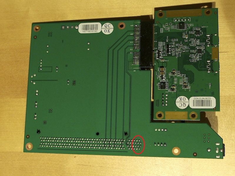

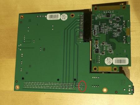

euqlaog Posted August 25, 2014 Share Posted August 25, 2014 Yes, please do play more with the multimeter. We are looking for 12V solder points on the AKiTiO PCIe board that have continuity with the PCIe slot 12V pins. If/when found, look for a nearby GND point. The 12V-GND pair then being a location where a molex plug could be soldered to the pads to bypass the need for the PCIe riser in order to supply 75W slot power. Now very promising news! B1 connector (rear side J10) on the right corner of "x4": 8 small holes through the board, 7 of them gave continuous beep sound with PCIe 2nd pin, one is different but couldn't get GND continuity to it. The nearest GND is marked on the picture, that point is very small, but I was able to get continuous beep when paired with a screw hole. EDIT: Voltage metering also proved that this is the right place to feed extra power. All those 7 points gave +12V. Is this a standard size power connector? 2 Quote Link to comment Share on other sites More sharing options...
Tech Inferno Fan Posted August 25, 2014 Author Share Posted August 25, 2014 Now very promising news! B1 connector (rear side J10) on the right corner of "x4":[ATTACH=CONFIG]12324[/ATTACH]8 small holes through the board, 7 of them gave continuous beep sound with PCIe 2nd pin, one is different but couldn't get GND continuity to it. The nearest GND is marked on the picture, that point is very small, but I was able to get continuous beep when paired with a screw hole.Some welcomed news.Did you want to check the pins on just the right side of mechanical key of the "x4 connector" to see if you have matches for 12V, GND and 3.3V using this as a reference: :: ST-Service ( ? The vicinity of those 12V points you found certainly looking like it. This would then give inclination that it is *electrically* a x4 slot. This test could then be used by those unconcerned about warranty to solder a molex lead straight onto the 12V/GND pins there.Can you then visually inspect if the pin pitch matches that of say a pci-e video card you have there by pretend sliding it in. Of course, not being a open-ended x4 slot will mean it won't go in. That would then give some assurance it is *physically* a x4 slot. This would then give reason for those concerned about warranty to researching for the the same x4 female to x16 female board as exists on the existing AKiTiO PCIe board. Maybe AKiTiO could even sell that board as a part for direct 12V/GND soldering at a reasonable cost? Quote Link to comment Share on other sites More sharing options...

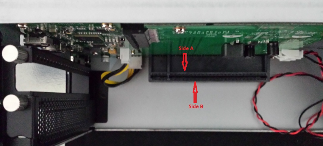

Arclite Posted August 25, 2014 Share Posted August 25, 2014 A powered PCIe riser has pins 1,2,3 on side B and pins 2,3 on side A connected to 12V. I illustrated in the picture below which side is A and which is B. Also pin 4 on side A and pin 4 on side B are grounds. Can you do a continuity test for all these pins too? Thank you very much Quote Link to comment Share on other sites More sharing options...
euqlaog Posted August 25, 2014 Share Posted August 25, 2014 Some welcomed news.Did you want to check the pins on just the right side of mechanical key of the "x4 connector" to see if you have matches for 12V, GND and 3.3V using this as a reference: :: ST-Service ( ? The vicinity of those 12V points you found certainly looking like it. This would then give inclination that it is *electrically* a x4 slot. This test could then be used by those unconcerned about warranty to solder a molex lead straight onto the 12V/GND pins there. Can you then visually inspect if the pin pitch matches that of say a pci-e video card you have there by pretend sliding it in. Of course, not being a open-ended x4 slot will mean it won't go in. That would then give some assurance it is *physically* a x4 slot. This would then give reason for those concerned about warranty to researching for the the same x4 female to x16 female board as exists on the existing AKiTiO PCIe board. Maybe AKiTiO could even sell that board as a part for direct 12V/GND soldering at a reasonable cost? I checked the first 11 golden fingers of the TB card (upper side) and 12V, GND and 3.3V all matches the x16 electrical specification (Side A). Visually it is also like a x4 connector Should I check the rest GND fingers from 11 till the end to be sure? EDIT: Already checked from the both sides and they all match! A powered PCIe riser has pins 1,2,3 on side B and pins 2,3 on side A connected to 12V. I illustrated in the picture below which side is A and which is B. Also pin 4 on side A and pin 4 on side B are grounds. Can you do a continuity test for all these pins too? Thank you very much Yep. Both sides (A & 12V golden finger of PCIe riser had a correct continuity to the test point (one of the 7 holes). Quote Link to comment Share on other sites More sharing options...
Arclite Posted August 25, 2014 Share Posted August 25, 2014 That is great news gualque, thank you very much for your testing It looks like we've got a x4 PCIe connector there, but just to be sure, let's wait for Tech Inferno Fan's conclusion Quote Link to comment Share on other sites More sharing options...
