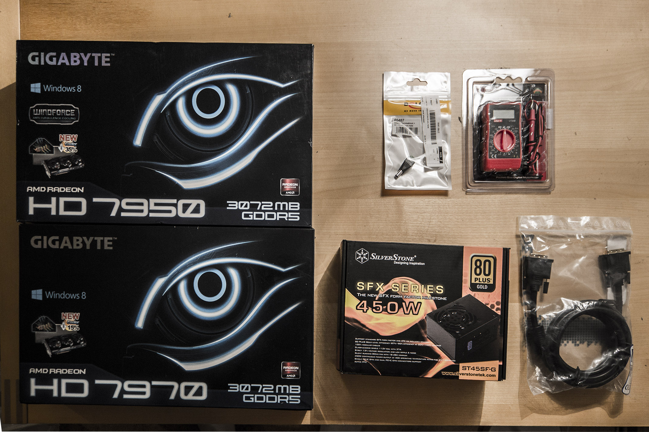

I got an opportunity to buy both these cards at an attractive price, about 200€ for the both of them.
As you said, I figured I could try daisy-chaining two AKITIO enclosures if this little experiment works out. That will have to wait though, right now my focus is on trying to get just one of them to work. The AKITIO is estimated to arrive here on Tuesday.
My Mac has the following specifications:
15" MBP 2011, 2,2 ghz i7, 16 GB RAM, AMD HD 6750M, 256 GB Crucial M4 SSD, and the "Hi-res" screen. Still quite a performer apart from the graphics.
Dual GPUs with either AKiTiO+PCIe cluster or daisy-chained AKiTiOs would be pretty cool but keep in mind that a ST45F-G (450W at 87% efficiency = 397W) doesn't have enough juice to power both a 7950 and a 7970 simultaneously in a stable manner (240W + 300W TDP respectively). You'll need a >600W ATX PSU - I don't think the SilverStone SX600-G will cut it either.
Wait, are you saying I could power two AKITIO's with a single PSU, granted its powerful enough?
In principle, yes. You could wire them up in a couple different ways: you could either make two separate boxes, each of them with its own AKiTiO + PSU and connect them using two TB cables in a daisy chain or instead go for a large box with a single PSU + two GPUs + single AKiTiO with PCIe cluster or two AKiTiOs. Either way could work. One key question is whether it's possible to set up SLI/Crossfire between GPUs hooked up to different TB-to-PCIe adapters - AFAIK all SLI/Crossfire eGPUs reported here used a single TB device (Sonnet or Netstor) connected to 2 or more GPUs but that doesn't necessarily mean it isn't possible.

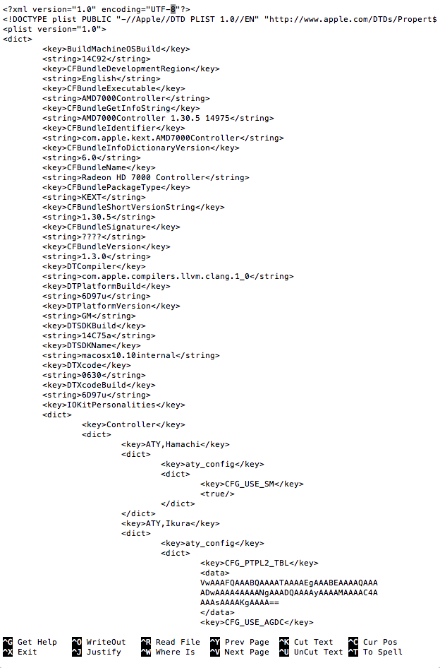

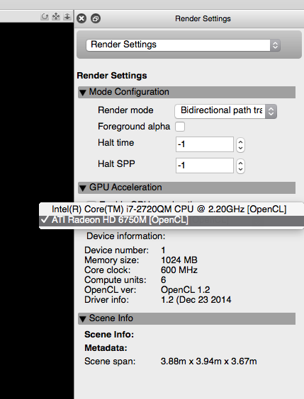

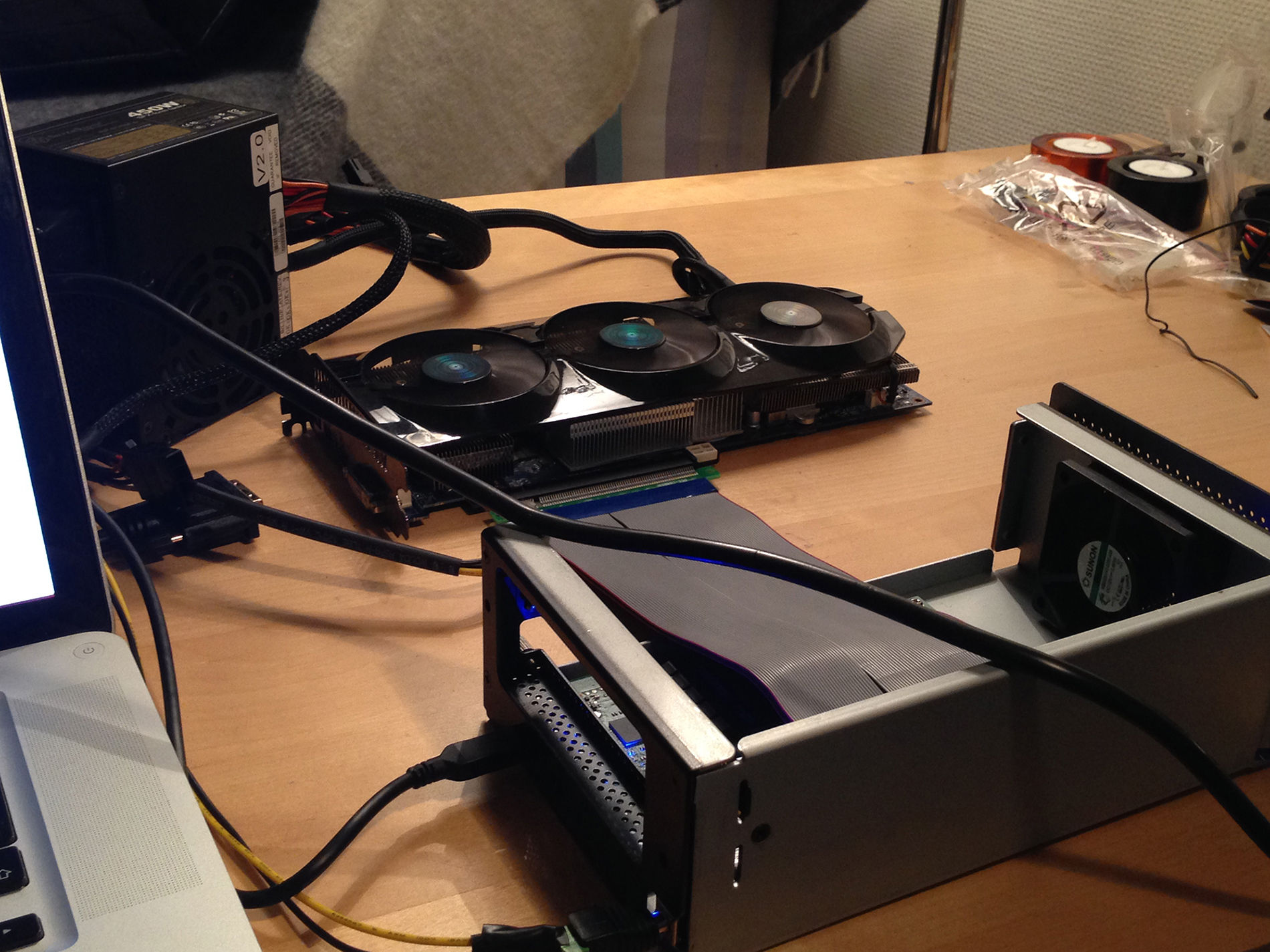

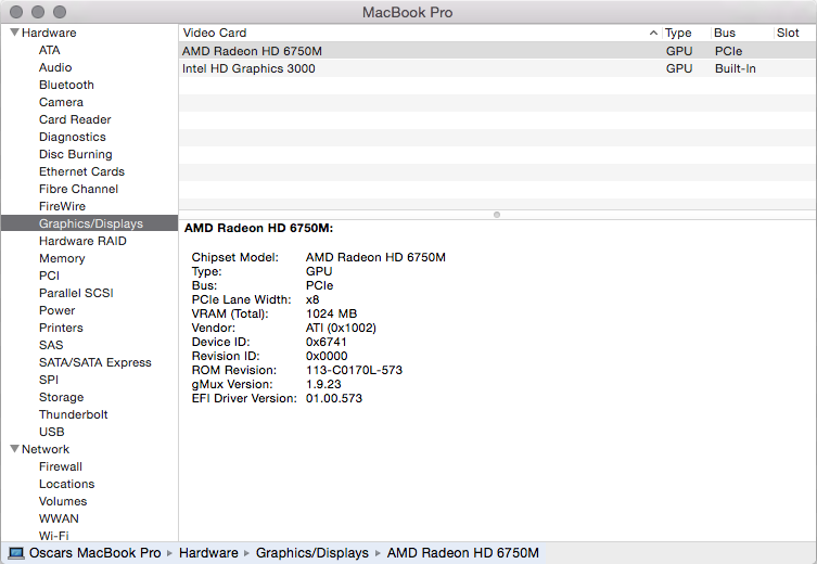

So everything seems to be running fine (the fans are running both in the PSU, the AKITIO and the GPU), except for the fact that I can't find the graphics card in System information or Indigo. Do I need to connect an external display to the graphics card in order to make it able to show up in the System profiler and accelerate OpenCL apps? Or do I need to modify and kexts or perform any other commands?
Great work! I am happy to give some advice. Your eGPU does not automatically show up under OS X system report. Modify the kext files for Tahiti series cards according to my guide:
http://forum.techinferno.com/implementation-guides/8585-%5Bguide%5D-2014-15-macbook-pro-2x-r9_280x%4016gbps-tb2-netstor-na211tb-win8-1-osx.html
External monitor is not necessary in order to run OpenCL apps.

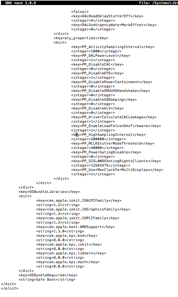

Thanks! Please have in mind that I'm not an experienced programmer. You describe a place in the kexts where it says "/dict". However when I open the kexts there are many places where it says that. How do I know where to paste your lines?
Start of the 7000Controller kext:
End of it:
