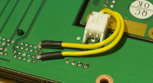

Yes, I'd suggest performing the 75W PCIe slot power mod outlined (solder 2 wires + isolate 6 pins) to see if you can get stability with your R9 280x. From your ATX PSU you also need a molex-to-DC barrel connector to attach to the DC input jack as well as the PCIe power leads to attach to the video card. Then it's all good to test.
The difference there as opposed to using a powered PCIe riser you are already using is you are getting a better quality Gen2 signal between the TB bridge and the AMD card. If the signal is noisy and can't maintain Gen2 speed then I suspect the TB-TB driver will crash in a similar way to what you are describing. That could be a signal integrity issue.

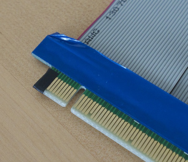

The 6pin taping trick can be applied to the powered riser instead - the male side that slots into the AKiTiO. Then 12V input at the PCIe riser and the 12V input via the barrel adapter are kept separate. Easier than dismantling the AKiTiO.
Applying the soldering method means you can get rid of the powered riser and instead, slot the video card directly into the AKiTiO Thunder2.

I mean if you are using a powered PCIe riser like the one shown below I refer to cellophane taping the left (male) side that slots into the AKiTiO. Apply cellophane to the first 6 pins on the left. That's 3pins on each side. That doing the same thing as applying cellophane to the AKiTiO board's 6pins as I described earlier but is easier to.
That then separates the 12V input via the molex on the riser and the 12V input to the AKiTiO Thunder via the DC barrel adapter to increase power stability.
That did the trick! 3DMark11 test passed twice in a row with a single 450W PSU + taped 6pins of the powered riser + molex-to-barrel adapter. This has never happened before with a single PSU. The third time almost went through, struggling with very low FPS during physics, the whole eGPU system took over 110W but at the end of the physics test, it showed blank white screen. When the physics test was passed those two times, energy meter displayed only 47-49W. I rebooted to confirm that this wasn’t just a coincidence, and it passed physics again, but only once this time. However, that’s significant improvement, because without taping, it was 100% crash. Maybe we can achieve 100% stability for the R9 280X by soldering :)

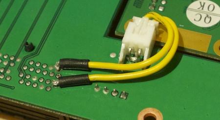

I got excited and bypassed the barrel connector by soldering 4 thick wires (two yellow 12V + two black GND) from a 4-pin molex connector. Heat shrink tubing tightened them together. I still use the x4 slot taping trick + 2-pin socket on the rear side of the J6 to provide 75W for the x16 slot.
By doing this, I have the most stable AMD eGPU system so far and no need for a barrel adapter or a powered riser. However, the maximum physics pass count with R9 280X is 2. I also disabled the ULPS (Ultra Low Power State) by modifying windows registry values, but maybe this only concerns CrossFire setups.
Furthermore, I soldered an additional capacitor at C3 (used one from my powered risers). Not sure how much that improved stability.
My conculsion is that the taping trick is the most important modification - not mixing 12V_filtered and 12V_ATX. I suppose the problem is how the R9 280X utilises the PCIe slot power when the GPU has nothing to do during physics. Earlier, without taping trick, R9 280X crashed often at idle, but now it doesn’t seem to happen.
With this setup, HD 7970 has no problem going through 4 sequential rounds of 3DMark11 test (didn’t try more). I just need a new and quieter cooler as the blower fan is very loud during graphically intensive tasks. Another good thing about HD 7970 is that Iris Pro is always detected without error code. If you want the same with R9 280X, you have to plug in the display cable a little more later after starting the computer.
