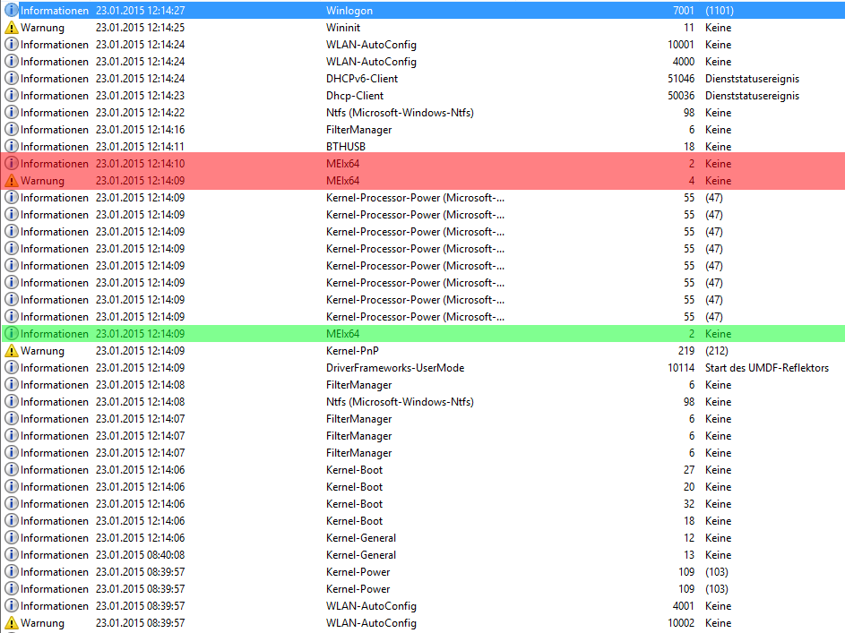

Hello Akitio Thunder2 users and @Tech Inferno Fan,
there are users whose setup isn't stable and crashes randomly. I was one of them and had kind of an odyssey until I got a stable system(again).
If you want to know about the stuff I experienced, read the background story(a bit longer):
I bought a MBPr 15" 2014 Iris Pro only base model in October '14 and received my Akitio Thunder2 PCIe box 2 weeks later. I already owned a GTX 480 and a ATX PSU which were used in my computer.
I started using the GTX 480 as eGPU and it worked out of the box really well. Though the performance was still good I already planned on replacing it some time before and finally got a good deal for a used GTX 780 some days before christmas.
Happily I replaced the GTX 480 and went on the same as before. Some time onwards I experienced a crash while gaming which showed up by stuttering sound and input being followed by a black screen.
The first time it happened I just thought it was bad luck but it showed up again and again. So I thought the card may get too hot in the case I had put it into and placed everything in the open on my desktop. While testing it happened again and again. I got confused. While reading on this board in the Macbook experiences thread I saw someone posting exactly those symptoms I had. He "fixed" it by switching his GTX 770 for a GTX 760. So I thought it may be a power consuming thing although my GTX 480 had 6+8 pin slots as well and is clearly known as a power hungry heater.
I had read that AMD cards could be used on external screens in OS X so I bought an Asus R9 280 Strix(6+8 pin too, unfortunately) to test this once, too. I cleaned drivers using DDU and installed Catalyst drivers. I tested and tested and then it happened again, same procedure but a white screen instead of black screen. Now I got tired of this stuff. I still thought of the PSU as a problem(it's more than 5 years old, multi rail) and bought a new single rail one.
Of course the same things happened again. I had put the R9 280 away so I could sell it again. If I'd find a solution I'd be using the GTX 780 anyway as it is the more powerful card.
In the following time I tried the following:
Akitio board - powered riser - 90 degree pcie angle - GTX 780 | ATX PSU only
Akitio board - powered riser - GTX 780 | ATX PSU only
Akitio board - GTX 780 | Akitio + ATX PSU
None of these combinations worked out to be stable.
I had replaced the powered riser already some time ago so this wasn't a reason either.
So I got: 2 ATX PSU, 2 powerful graphics cards, 2 risers, various combinations.
What I didn't replace was the thunderbolt cable and the adapter. Both didn't seem to be responsible for the symptoms in my view and I didn't want to buy another adapter.
So the GTX 960 was announced and appeared in stores some times later. It only needs a single 6 pin plug. I still thought it might be a power consumption issue although it did not seem plausible to me because full load was possible even with the GTX 780. The crashes appeared absolutely random and weren't reproducable.
Against my own common sense I bought a Gigabyte GTX 960 Mini OC in an online shop. In Germany we're able to send products back to the shop in between 14 days after receiving the good without a reason and we get our money back(if the good isn't obviously used and/or damaged, of course). I'd only need one day anyway because a day without a crash wasn't possible to achieve.
I received the card today and plugged it into the Akitio slot directly powering it with the Akitio PSU. The additional 6 pin plug was taken from the ATX PSU of course.
Good news: Not a single crash this day.

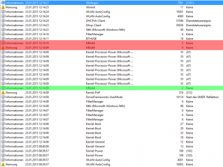

I had previously watching the system tab of the event viewer in Windows, which shows starting components, crasing drivers etc., while trying to find a reason for the crashes.
Back then I noticed the "Intel Management Engine Interface driver" being started at one point and then the same was being disabled and enabled again a short moment later. This only occured when the eGPU with the GTX 780 was plugged in and running.
It was the same for the R9 280.
Now guess what? My new GTX 960 doesn't produce those two entries and I'd say the GTX 480 didn't produce them as well. Unfortunately I had reinstalled Windows some days ago so my event viewer logs of the time when the GTX 480 was in use are gone. I hadn't thought about checking this before even though I noticed the stuff described above.
I asked @Dschijn if he had the same single entry only, because he was one of the users with a powerful card, Akitio Thunder2 and reportedly stable connection and he confirmed the single entry for his setup.
This would indicate that the issue isn't caused by power consumption but is a software or bios/efi(gpu) issue at boot. Even though the unstable systems crashed they could be put on high load and even overclocking wasn't an issue.
Otherwise I've only got a theory and at this point I need your help :)
If this can be confirmed by more users one can at least determine if the card will be either stable or crashing the system. It won't provide a solution to get a stable system with an unstable card for now though.
So, for all those of you having an Akitio Thunder2 in use and either have a stable or unstable system, do this:
Move to Control Panel - Administrative Tools - Event Viewer - (left panel) Windows Logs - System and watch for the following lines:

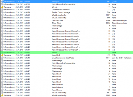

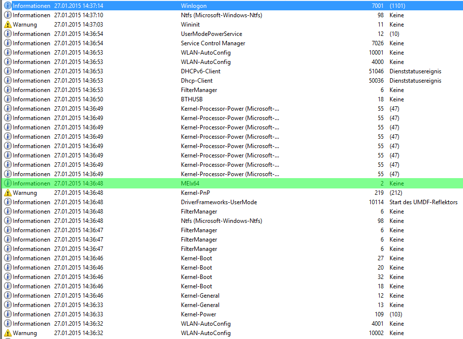

If you've got a stable system, only expect one line(green):
If you've got an unstable system, one line first(green), then two lines right after another(red), one warning, one information:
If you've got a stable system but the second set of entries, well then you've either been lucky or my theory is wrong.
All of this has been experienced in Windows 8.1 Pro, though Pro or not shouldn't result in a difference. If you use Windows 7, you may provide the screens or informations, too.
Thank you very much.

My event log showed only one MEIx16 row, and what is very weird AKiTiO + R9 280X combo passed 3DMark11 physics test today for the first time! I decided to play very intensive BF4 64 players Team DM and guess what… with the high quality settings it showed mostly > 60FPS on the external 1080p monitor. And that GPU was only 189€ as used. No crash after 4 complete rounds and my system was stable at least an hour. 3DMark13 test was passed as well. I just used a powered riser and a 450W PSU, nothing plugged into the DC jack.

Your event log showing only one MEIx16 row and the system being stable is a good sign for my "theory".
@all: Please provide more information! It doesn't even take 5 minutes to see what the log shows. No matter if you've experienced difficulties or everything went smooth from the beginning.
