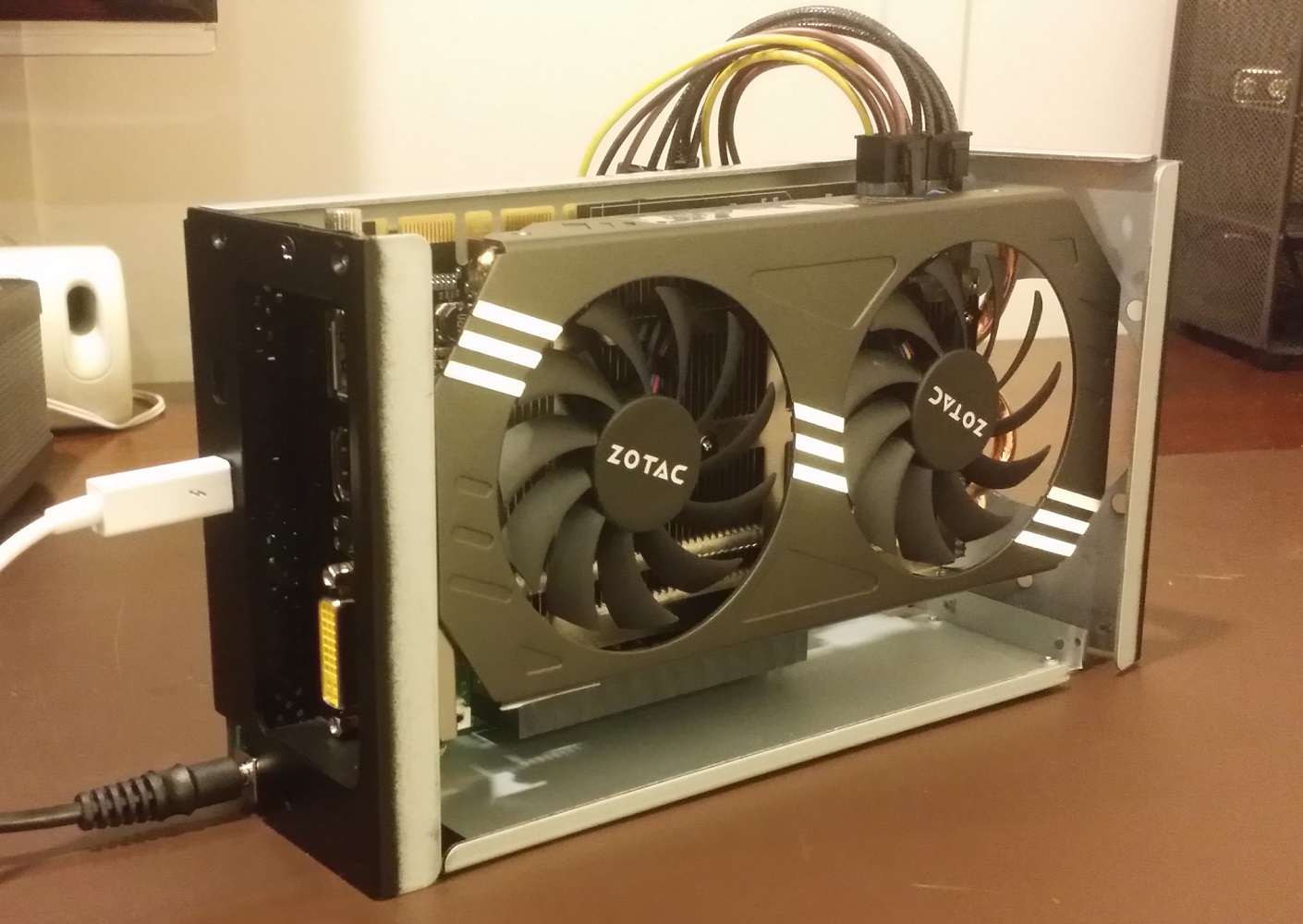

Slovedon Posted October 4, 2014 Share Posted October 4, 2014 Despite what I thought would be a TB-enabled G46VW, I "won" the lottery and got the only rev 2.2 mobo without a TB chip In better news, the Zotac 970 fits very nicely into the Akitio! The back only had to be bent slightly to accommodate the cooler. And since I don't know if I'm patient enough to wait another 1-2 weeks to test this thing, I may try to get it running on our 2013 rMBP. Plus I could do some TB2 vs. TB1 testing or anything else if it would be helpful information. Problems: it is NOT the Iris pro graphics version (650M), it runs BIOS windows 8 instead of EFI, I never do anything technical on Mac systems, and this is my first eGPU implementation - so any advice or links to the most relevant guides for this situation would be much appreciated. 2 Quote Link to comment Share on other sites More sharing options...

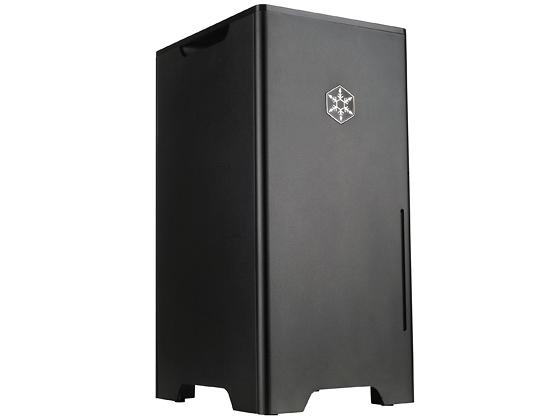

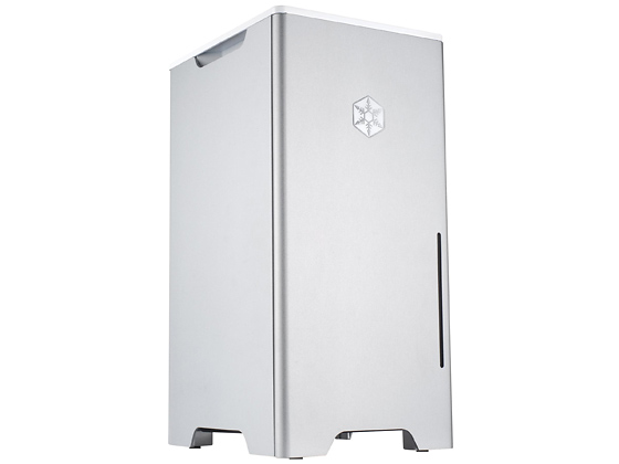

Sachin10 Posted October 8, 2014 Share Posted October 8, 2014 Right now, I'm trying to figure out how to make this more portable. I don't really want to put it into a small atx case, so I'm thinking of constructing something to enclose it. Most mini-ITX cases are quite big and ugly but I like the Silverstone Fortress FT03-MINI. It doesn't have a large footprint and I realy like the aluminium enclosure. I want to put in on my small desk table in the living room next to my 13 rMBP. Normally they recommend the reference coolers for graphics cards to blow out the hot air and a SFX power supply. But without a CPU you might be able to use other graphics cards and larger power supplies. But the card length is limited to 10" so some GTX 970 cards will work but I think most GTX 980 cards are too long. This is my current wishlist: * EVGA GeForce GTX 970 4GB Superclocked (04G-P4-1972-KR - 2x6 pin) * Silverstone Fortress FT03-MINI * Silverstone SFX 450W Bronze (300W should be enough but I might build a PC with this hardware) * Paperclip trick * Powered riser * 500 GB S-ATA drive (for my Steam library) * S-ATA to USB 3.0 adapter Quote Link to comment Share on other sites More sharing options...
