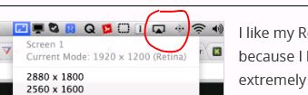

entzoe Posted September 12, 2014 Share Posted September 12, 2014 Hey there,[ATTACH=CONFIG]12491[/ATTACH] that's what I got and yes I have plugged two monitors to the GTX and they are working. Try this, work on your external display, and try if you can find the following icon (box or square with a black up-arrow ) on your menu? Can you try to click on it and select one of your External Monitor? After that, check your System settings (About MacBook) if the current GPU points to your eGPU. Quote Link to comment Share on other sites More sharing options...
SmutjeHannes Posted September 12, 2014 Share Posted September 12, 2014 Try this, work on your external display, and try if you can find the following icon (box or square with a black up-arrow ) on your menu?Can you try to click on it and select one of your External Monitor? [ATTACH=CONFIG]12492[/ATTACH]After that, check your System settings (About MacBook) if the current GPU points to your eGPU.I can't find that icon. Do I have to change settings somewhere to make it appear? Quote Link to comment Share on other sites More sharing options...

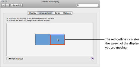

entzoe Posted September 12, 2014 Share Posted September 12, 2014 I can't find that icon. Do I have to change settings somewhere to make it appear? Can you try these steps? 1. Choose Apple menu > System Preferences > Click Displays. Can you Tell me what is it showing (3 displays? 2 monitors and your MBP monitor?) Can you show the screen shot? 2. Is there an Arrangement tab? 3. Can you check the mirror display icon? Quote Link to comment Share on other sites More sharing options...
SmutjeHannes Posted September 12, 2014 Share Posted September 12, 2014 Can you try this steps? 1. Choose Apple menu > System Preferences > Click Displays. Can you Tell me what is it showing (3 displays? 2 monitors and your MBP monitor?)2. Is there an Arrangement tab?3. Can you check the mirror display icon?Aperture 3 User ManualJep, it shows 2 monitors and the MBP monitor and there is an Arrangement tab and I checked the mirror display icon so all 3 displays show the same Quote Link to comment Share on other sites More sharing options...
entzoe Posted September 12, 2014 Share Posted September 12, 2014 Jep, it shows 2 monitors and the MBP monitor and there is an Arrangement tab and I checked the mirror display icon so all 3 displays show the sameCan you change the resolution under the Systems Preferences>Display? Can you play around on that setting?As you click the drop down of the Display option, can you post a screen shot? Quote Link to comment Share on other sites More sharing options...
SmutjeHannes Posted September 12, 2014 Share Posted September 12, 2014 Can you change the resolution under the Systems Preferences>Display? Can you play around on that setting?As you click the drop down of the Display option, can you post a screen shot? I tried several resolutions and re-checked (closed it and opened it again) the About this mac / graphics tab... still the same Quote Link to comment Share on other sites More sharing options...
entzoe Posted September 12, 2014 Share Posted September 12, 2014 [ATTACH=CONFIG]12495[/ATTACH]I tried several resolutions and re-checked (closed it and opened it again) the About this mac / graphics tab... still the sameDon't chose the built-in display. Choose one of your monitor and make sure to check the 'mirrored' check-box Quote Link to comment Share on other sites More sharing options...
SmutjeHannes Posted September 12, 2014 Share Posted September 12, 2014 Don't chose the built-in display. Choose one of your monitor and make sure to check the 'mirrored' check-boxMy computer crashed after I tried to open Premiere (which wanted to use GPU with CUDA which is the eGPU). After restart I switched between displays and set the resolution for one of the external displays and now the 780 TI is being used! thank’s a lot man!I was a little buzzed to have my 3 different displays all show the same. But then in the Arrangement tab I relocated the menu bar to one of the external sceens and now I don’t have to mirror displays and my GTX is till being used. Great!I will do some testing now. But it looks good so far.Thank you so much, manCheers,Hannes Quote Link to comment Share on other sites More sharing options...
entzoe Posted September 12, 2014 Share Posted September 12, 2014 My computer crashed after I tried to open Premiere (which wanted to use GPU with CUDA which is the eGPU). After restart I switched between displays and set the resolution for one of the external displays and now the 780 TI is being used! thank’s a lot man!I was a little buzzed to have my 3 different displays all show the same. But then in the Arrangement tab I relocated the menu bar to one of the external sceens and now I don’t have to mirror displays and my GTX is till being used. Great!I will do some testing now. But it looks good so far.Thank you so much, manCheers,HannesAwesome! Enjoy!!! Quote Link to comment Share on other sites More sharing options...
