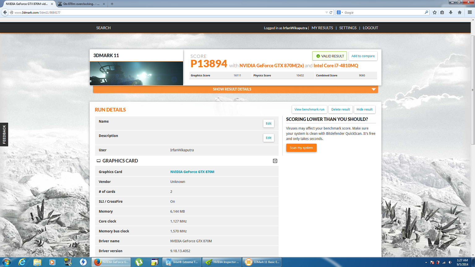

Hi klem, i hope you are still around this thread
i have clevo p377SM-A with gtx 870M SLI
Would i be able to use your vbios mod to overclock?
also, i have problem with my cpu score, the same problem kingkaan has
please help sir
Yes, you can use my mod vbios for your laptop.
And if you have problem with CPU score, then try to use power supply (power brick) with more power.
