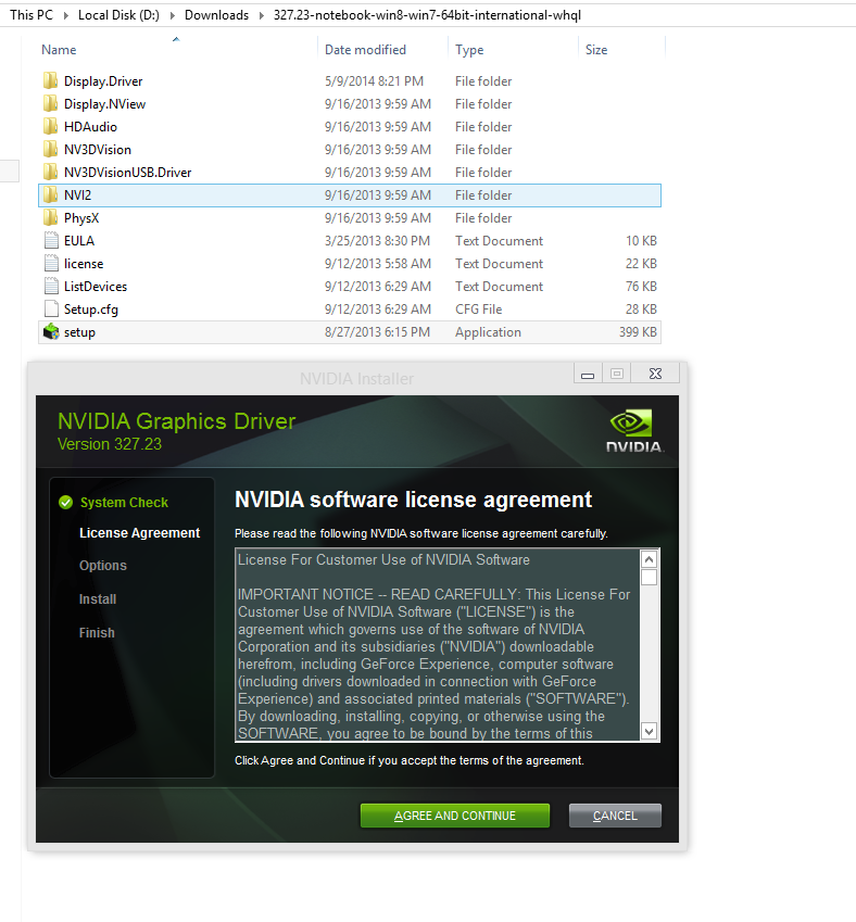

Nvidia Inspector
Nvidia 327.23...International folder\ delete the following folders -> Display.Optimus -> Display.Update -> GFExperience -> GFExperience.NvStreamC -> GFExperience.NVStreamSrv -> MS.NET -> NVVAD
Installation don't want continu : essential files are missing
No problem, you could try creating a restore point (DDU) and install v331.61. If it still fails just restore to previous driver, giving up...:P or it will be a lonely night...;)

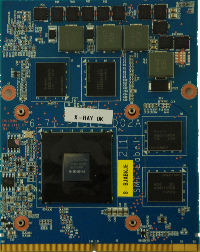

Just been reading this thread this morning. I reckon it's not a software or vBIOS problem Manu369 is having. Maybe one of his components on the MXM board is heating up too much & causing the crashing: considering it happens after about 5 mins of gaming. This would be a component that does not have a temperature sensor associated with it, as I see his GPU core temperatures are OK. I would guess that it might not be padded up properly & one of the critical components on the board is not in contact with the heatsink at all. j95 provided a good picture to show the depth & position of the pads, if I was Manu369 I would double check the pad placement.
Hello I checked and all pad are correctly placed and I tried to load game with a big fan under the laptop (33cm fan) the temperature remained low but the laptop continu to crash after few minutes, sometime after 2mn , sometime more.

Hmmm, weird, but I don't get how it can run a game for pretty much always 5 mins and then crash. That just seems to me to really smack of something just gradually heating up & then overheating over time. Well, you've said you checked all the pads are contacting all the chips, but I am surprised. Good luck with it though, hope you can solve it, I don't have any other suggestions bar what's already been mentioned in this thread.
EDIT: just a thought on pad placement. Maybe you have a different heatsink to j95, and his pad depth guides might not be suitable if that's the case. You said you had the 660M I think, so maybe the 660M heatsink for the R4 is different to whatever j95 was using.

So you didn't move the pads around on the heatsink to match your 880M, you just left them as they were?! If that's the case, then you're almost certainly got one or 2 components on there that aren't covered, so I think it's overheating if that's the case. Your big air flow test also supports what I'm saying. It's important to pad up all the components.
@Manu369, so you didn't follow my instructions...:Banane13: The 660m thermal pad layout is completely different, not 1 or 2 but many components. That also explains the core High temperature...:D

Yes :D just seen that the 2 parts (1 mm on the right) are not covered.
I though that all was good because the original pads are huge and cover all the rest, but I don't seen the 2 little parts. Monday, I go order some new pads at my electronic market, I hope it will resolve the problem.

DOH! Looks like we've gotten to the root of the problem then! Don't use your GPU heavily until you re-pad it. Actually, you're probably better off not using your laptop, or putting back your old card until the new pads arrive, you don't want to risk damaging any of the components on the GPU board. And from what j95 knows about the differences between 660M and 880M it looks like it's probably more than just those 2 little chips that you have that aren't covered properly, so don't just wack a couple of pads on those & then think it's done.
