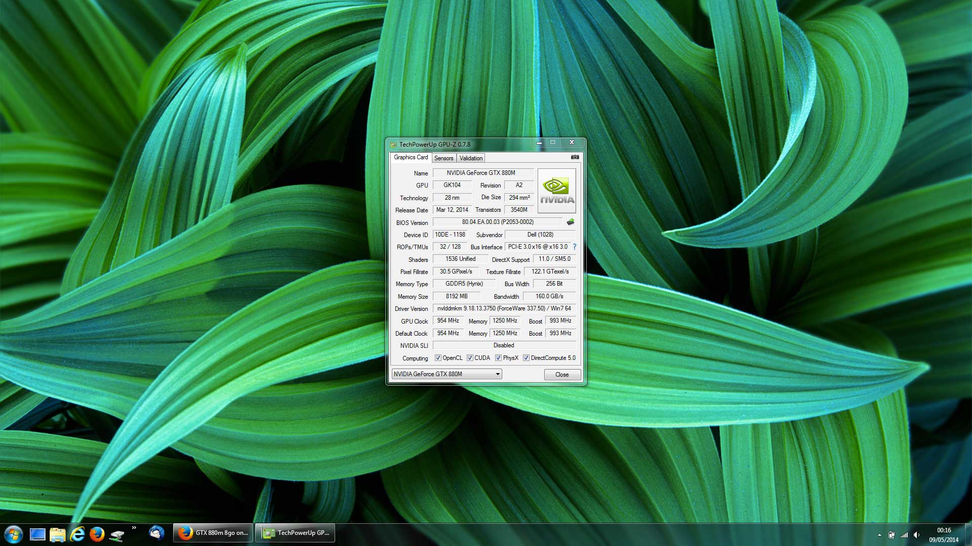

Driver installation ok and now the current control panel indicated that graphic card is 880m, Nvidia inspector also indicated that it is the 880m installed.

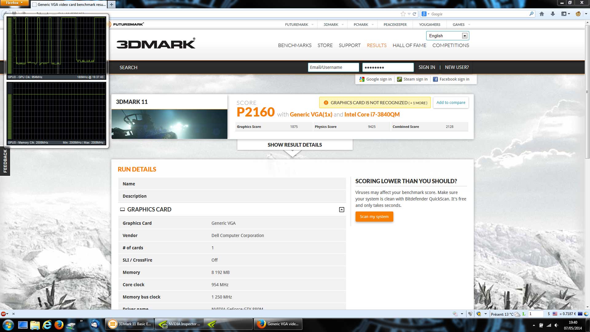

this is the result with 3dmark :
http://www.3dmark.com/3dm11/8306463
The 780m seem work good on R4, 880m is the same card, just frequency and ram quantity are changed.
People who use 780m in R4, do you have generic vga device in 3D mark ?

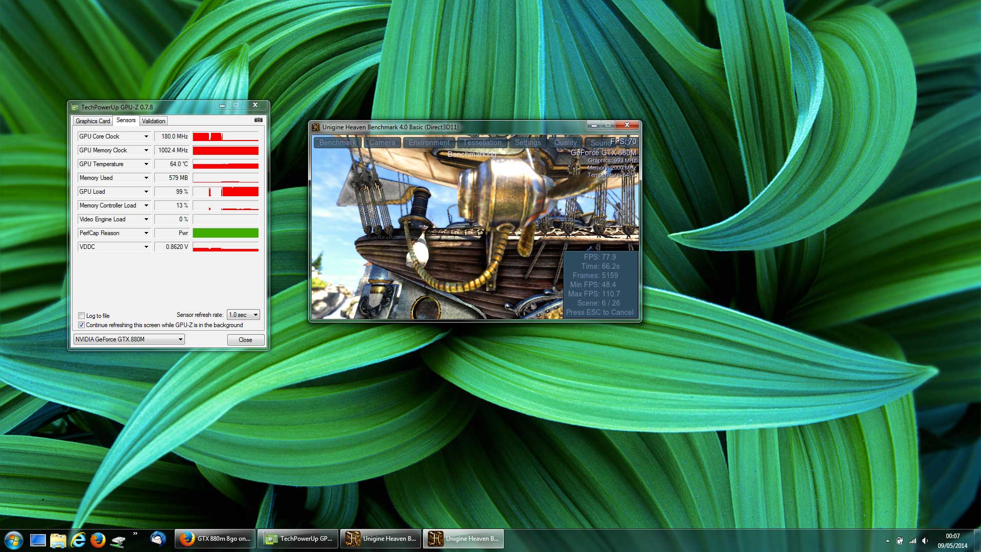

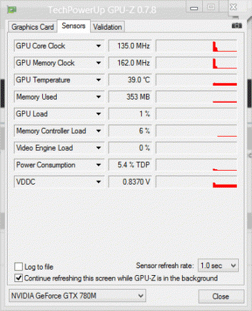

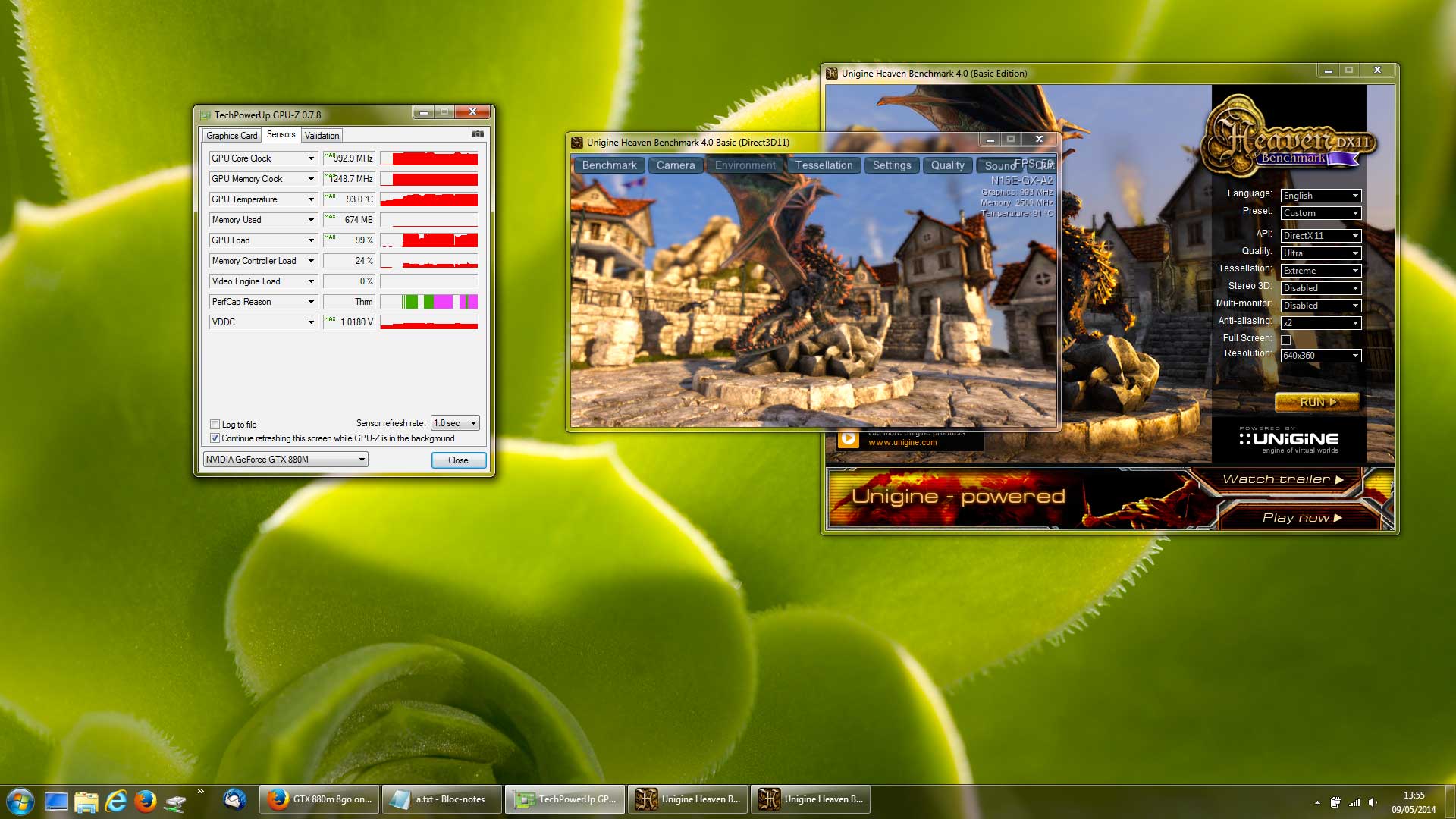

here the benchmark with GPU-Z by default.
Clearly when I start the benchmark, frequency of the GPU dropped very low, see pictures :
That's severe throttling, Core 180MHz/P8 0.8620v 64C, Heaven 993MHz/P0...strange. PSU issue ? @svl7 or @johnksss any ideas ?... :)

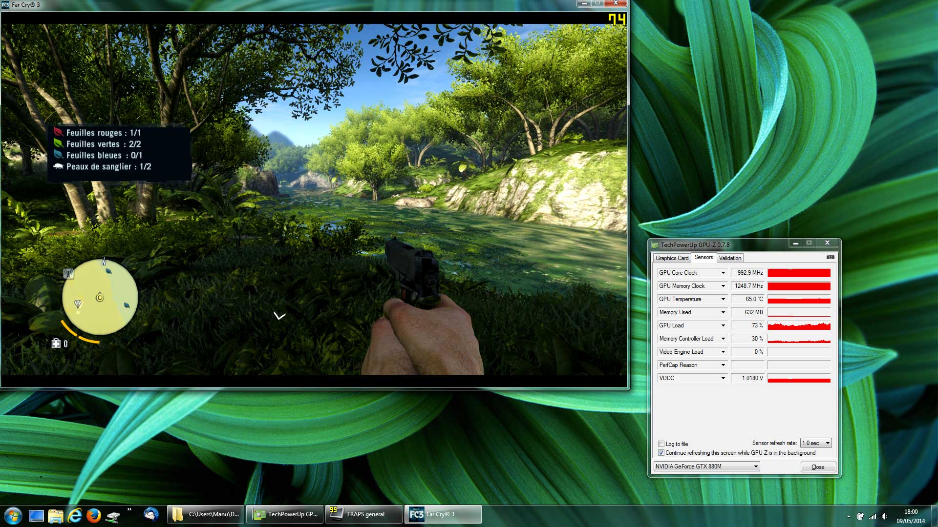

So I also tried to open benchmark and game in a windows and not full screen, it's always the same, after 5mn the driver crash.

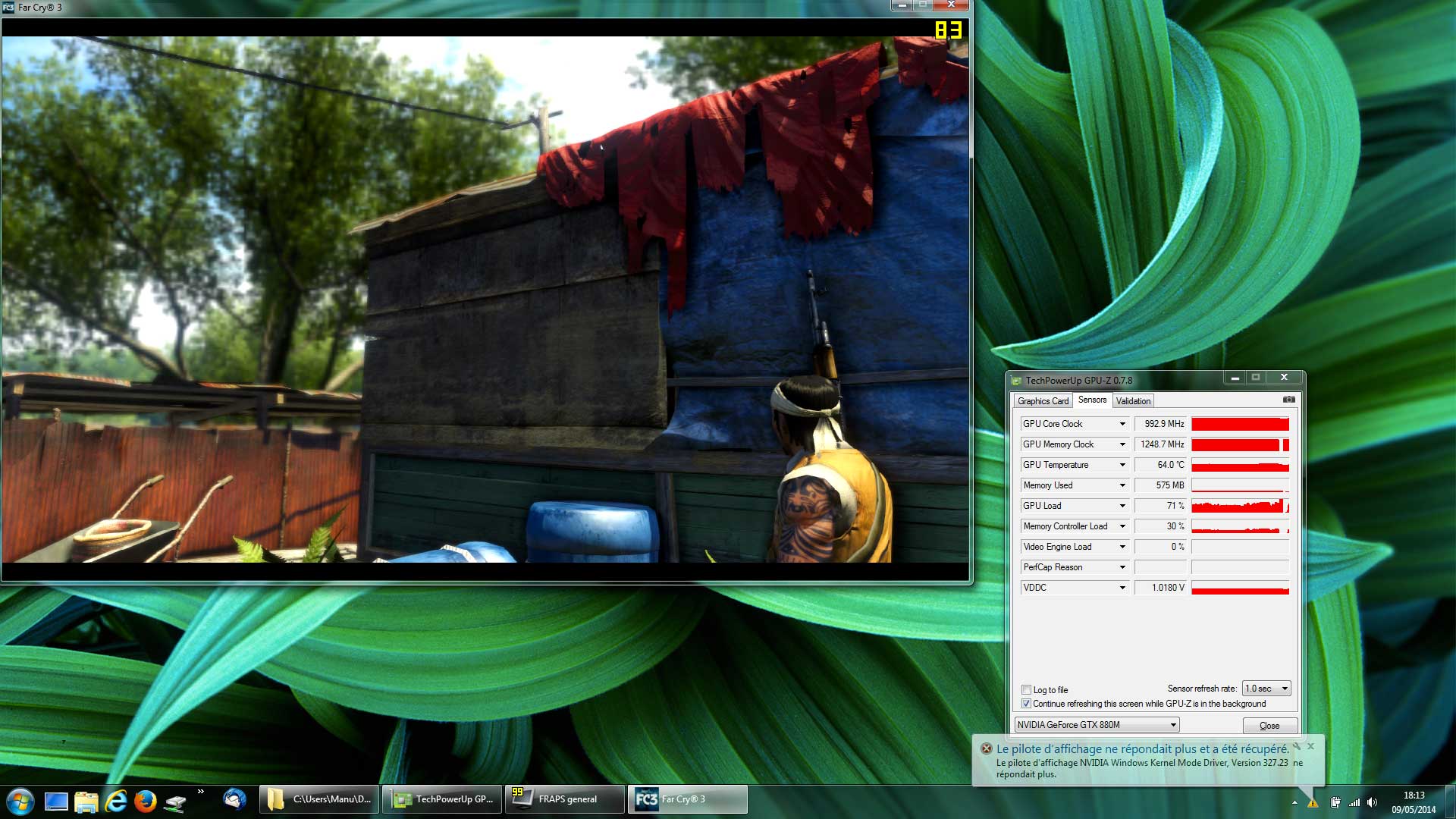

I captured picture just before crash and after.
This crash appear only when I stress the Graphic card with benchmark or with a game.
It is possible problem come from the driver ? maybe I must test with other driver for check is the problem is always here.
in most cases, the screen freeze and I must restart the laptop, here I was able to take screen after nvidia driver was reload.

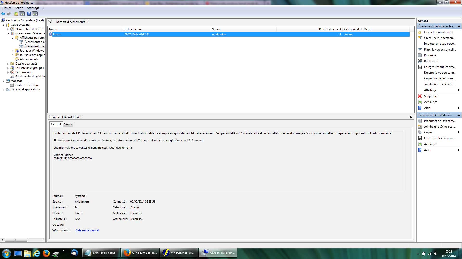

About crash report :
http://nsp18nhawf.1fichier.com/
translation :
The description for Event ID 14 in the source nvlddmkm can not be found. The component that raises this event is not installed on the local computer or the installation is corrupted. You can install or repair the component on the local computer.
If the event originated on another computer, the display information had to be saved with the event.
The following information was included with the event:
\ Device \ Video7
008b (4148) 00000000 00000000
the file nvlddmkm.sys seem be the problem.
0x116 = Video TDR timeout
IRQL_NOT_LESS_OR_EQUAL, Driver corruption (nvlddmkm.sys), RAM not likely since previous card was working fine.
