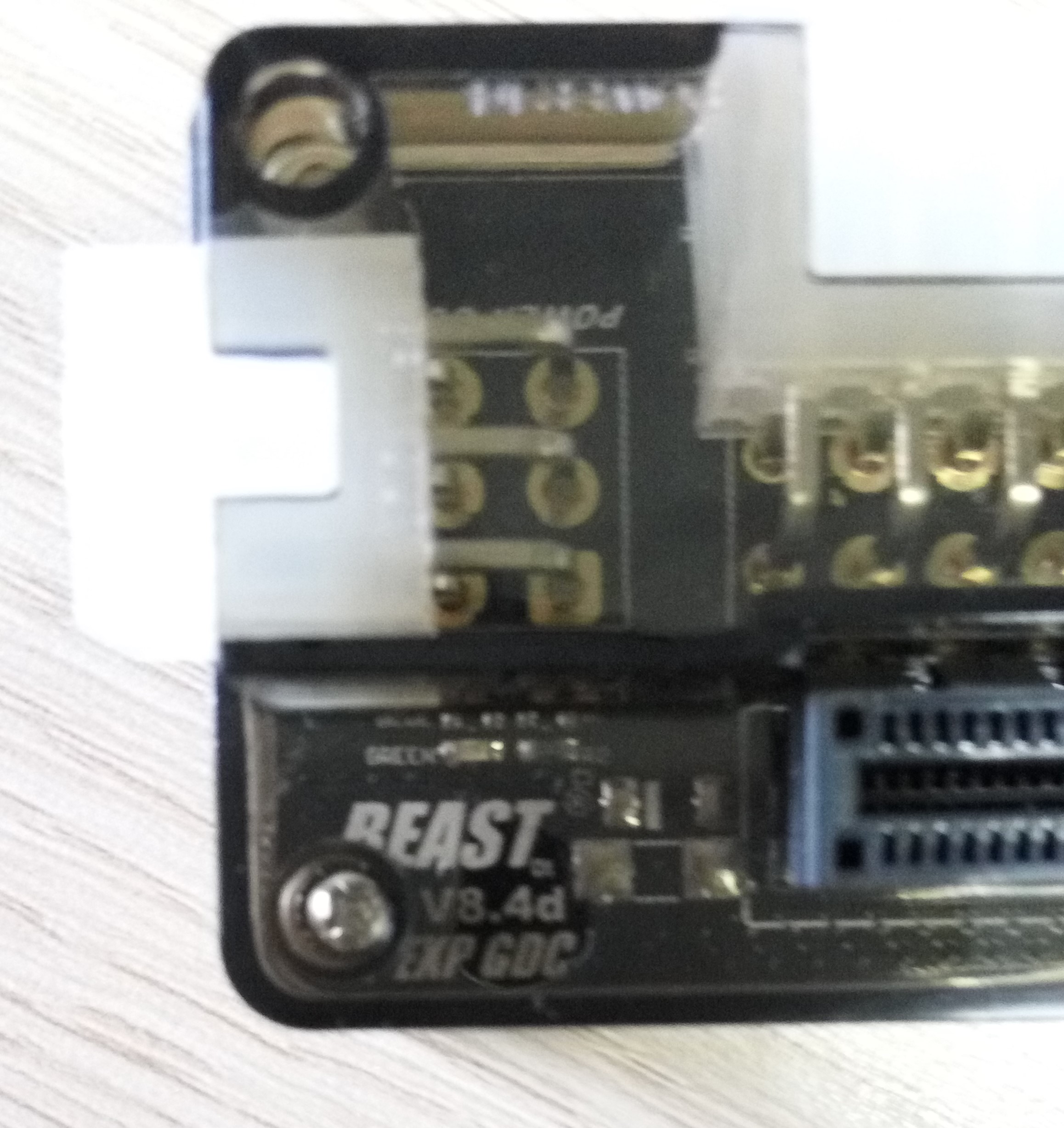

Guys I need help badly. I have purchased the EXP GDC beast v8, recieved it today and it is a bit different, the mPCIe connector looks a bit smaller that what I have seen and inside the grey box I see the name says it is an beast v8.4d EXP GDC. When I hooked up everything and try to boot, nothing shows up on the external monitor. I am using an NVIDIA 9500gt as a test card before I recieve my gtx 950. What can I do to fix this issue, I don't have $25 dollars to spend on that setup 1.3 software thing. Please help.
System: Dell xps 15 L502x (site said it is compatible with my laptop)
Bios: a12 (stock)
If you guys need any other info, just ask.
Nevermind, I figured it out, check my following post to see.
Edited by Mr_Western

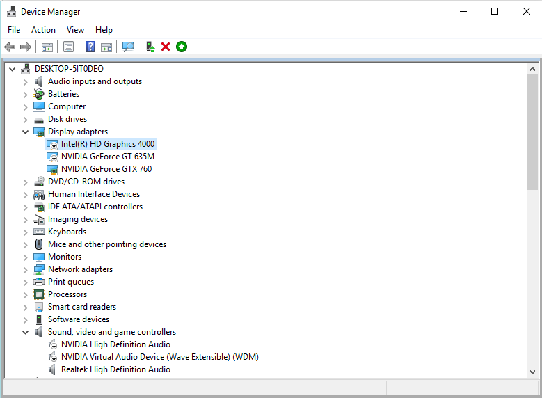

Hi everyone
I have exp gdc v8 and my specs
Dell N5110
i7 2670qm
8gb ram
gt525m@hd3000
egpu@EVGA GTX 760
HM67 chipset

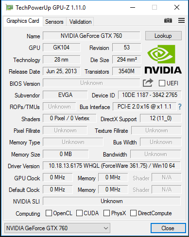

My problem m-pcie slot work only 1.1 speed
I tried force gen2 speeds but card doesn't work.

On 14.10.2016 at 10:07 PM, Mr_Western said:
@sulocanx
Is there any major performance issues, is your card not performing as expected at this setting? Also try clicking on the question mark next to the bus interface and start the render test, see if changes.
Yes, performance is bad with this settings, bus interface not change works only x1 1.1 gen1 speed.
I tried force gen2 on egpu setup 1.30 but card dosen't work.
Fire strike score: 4730 (graphic score 5344)
3DMark11 score: P6334 (graphic score 6565)
Tested on external screen.

@sulocanx
hmmm that looks like scores within reason. Maybe you should give me some of your gaming numbers as these synthetic tests don't always show the bigger picture.
According to 3DMark website, a GTX760 and and i5-3570 gets:
3Dmark11: P9588
and
Firestrike 1.1: 6091
Just remember we are using a mPCIe slot to operate a GPU, so getting what desktop gets won't be possible.
However, if in games it isn't performing as how it should (even taking into account the above) then try disabling some stuff that is on the PCIe bus (create a restore point before attempting this). Maybe some other things is saturating the bus and not giving optimal performance. You can try disabling a few things under the Network adapter or making sure your old GPU is disabled as well (even if the drivers for it is uninstalled).
Crap I was watching the wrong persons image, sulocanx, you are already operating at 2nd gen mode, that's what the 2.0 stands for. the 1.1 is the bus width (you can't do anything about that, its the physical size of the actual slot). Post some of your game scores and settings, maybe it might shed a bit of light for me as to your concerns.

@sulocanx
I checked the video for outlast 2, that is performing wonderfully. I checked other people's gameplay of outlast 2 on their GTX 760 and they were (strangely enough) on par with your results. When I checked your video for battlefield one, I am seeing your GT 525m present, are you switching between the GT 525 and GTX 760? if that is the case, your PCIe bus must be saturated; however, look at the Bus interface, it is the same as your GTX 760 so there isn't anything you can really do about that. And once again with your witcher 3 gameplay is right around where I'd expect it to be, you were using your internal screen after all.
Some stuff you can try are disabling and removing the drivers for the gt 525m (together with some other stuff that may saturate the bus), using an external monitor and if your monitor support sound output, use the sound on your monitor or the headphone jacks on your monitor, this is because you are again saturating the PCIe bus with audio transfers from GPU to CPU and then to speakers on the laptop (GPU processes the audio with its APU [Audio Processing Unit]).
