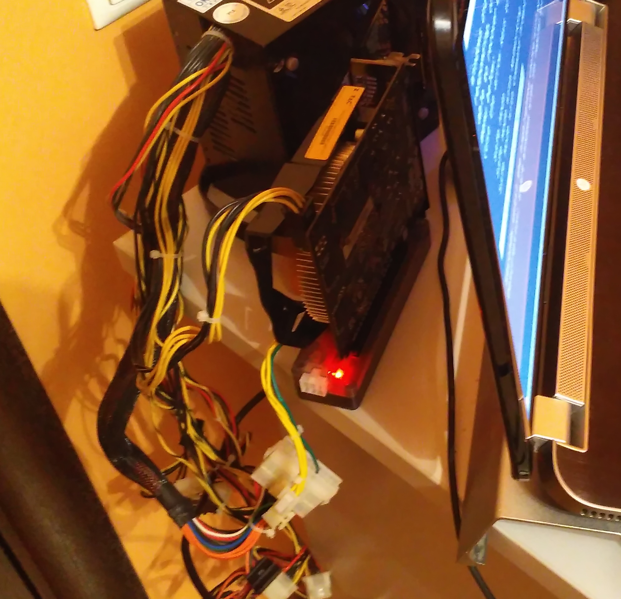

ShOOm Posted July 26, 2016 Share Posted July 26, 2016 Hi people! Tell me please what color of the indicator must be on the adapter? On the video it shows blue, but when I plug everything my adapter is red. Smth wrong or its normal? Quote Link to comment Share on other sites More sharing options...
Another Tech Inferno Fan Posted July 28, 2016 Share Posted July 28, 2016 Mine is red. Always has been, always will be. There is also only one LED mounted on the PCB, so either I am missing something and being an idiot, or red light is the only light you'll ever see. Quote Link to comment Share on other sites More sharing options...

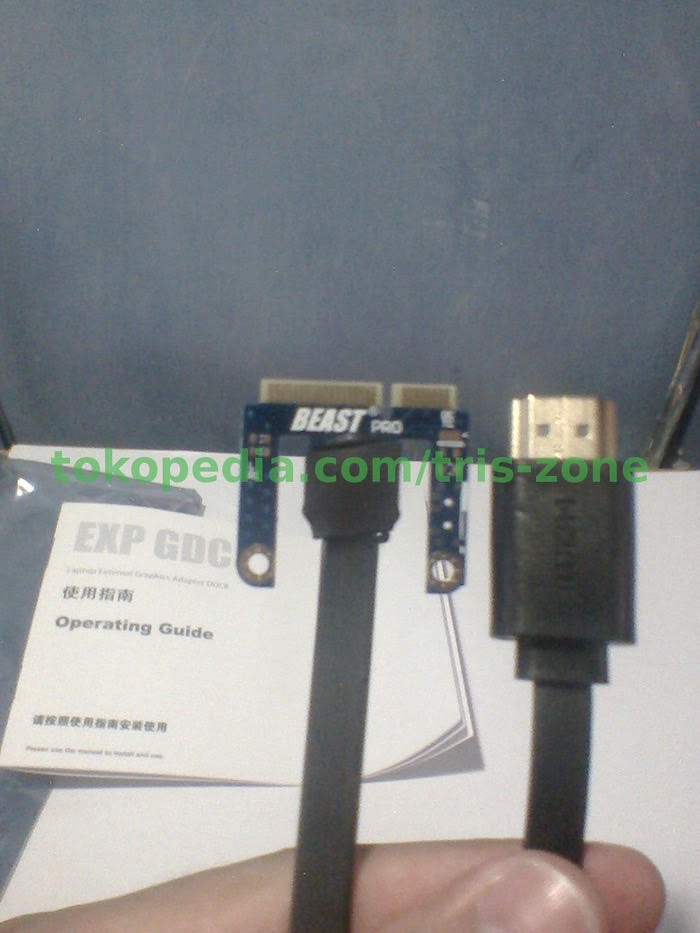

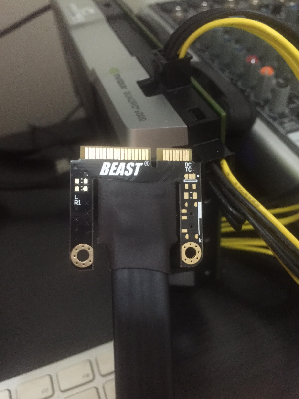

ssamydla Posted August 14, 2016 Share Posted August 14, 2016 (edited) my LED on v8 is BLUE. I've never seen any EXP GDC with RED LED before (perhaps new version?) I couldnt find v8.3 either. Bangood doesnt reply me. They still using same old product photos. But i can confirm you that there are new version on the mPCI signal cable. This could be easily identify by its physical form: - Smaller/Thiner cable - It has 'BEAST Pro' logo on mPCIe end - There's no PTD switch - 8 pin power connector slightly different Beast Pro Mine: Blue LED On Edited August 14, 2016 by ssamydla photos unloaded Quote Link to comment Share on other sites More sharing options...

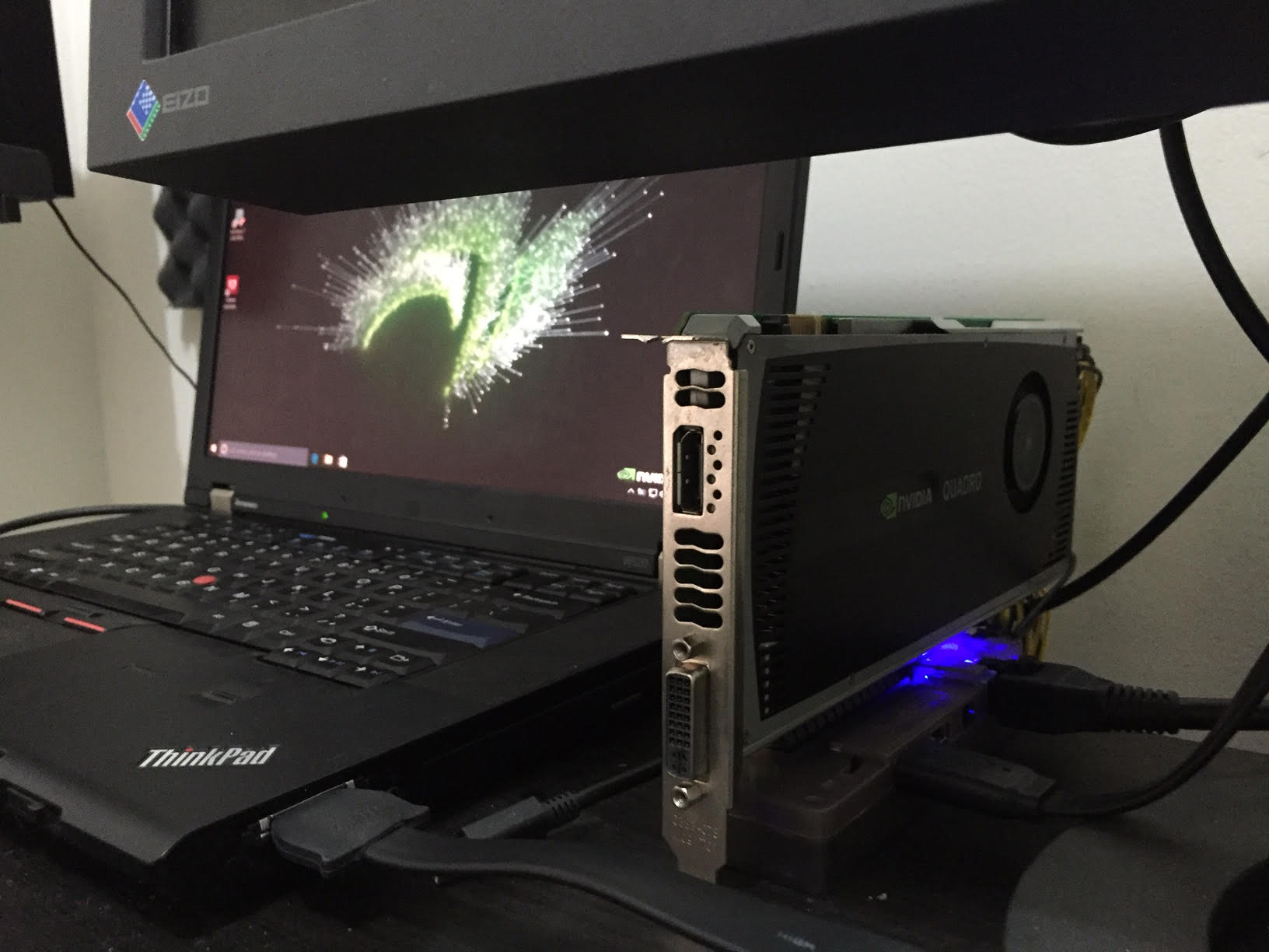

balonik Posted August 14, 2016 Share Posted August 14, 2016 4 hours ago, mrdatamx said: The version is written in the circuit board of my adapter. It is visible through the plastic enclosure if I take a look at it from the top. It is located near the PCIe slot . You are right, didn't see it with the card on as the plastic is scratched over it. Mine says v8.4d I have PTD switch (off/7s/15s) and green led Some experience with it over past two weeks. My setup HP 8460p, 8GB RAM, no dGPU, Intel HD 3000 Win 10 EXP GDC Beast V8.4d with EC Setup 1.30 (DSDT and PCI Compact) I am using External Monitor. BIOS latest and all the other drivers as well. I tried 3 GPUs, GTX 560 Ti, GTX 760 and GTX 750 Ti. I was not able to get EC Gen2 working for GTX 560 Ti and GTX 760, both cards report that only x1.1 as supported after I install NVidia drivers. Tried 3 different versions of drivers, all the same. screenshot of gpu-z here - However, I got x1.2 using the GTX 750 Ti using latest drivers without any issue. Of course, GPU-z reports x1.1 first, but quickly switch to x1.2 when card is under load. Whenever I switch EC to Gen2, the two first cards are even not detected, Win doesn't boot at all or everything is freezing after boot and PC eventually turns it self off. When I uninstall NVIDIA drivers (using DDU), PC works fine even with EC to Gen2, but thats useless Is there some trick to get those 2 cards working x1.2 or they just won't do it with EXP GDC? Quote Link to comment Share on other sites More sharing options...
