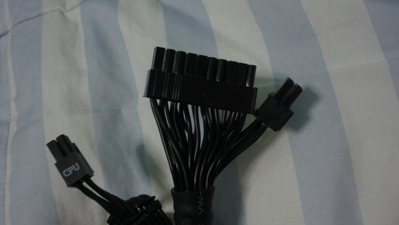

Above: Doing that shorts out multiple rails on the PSU which causes it to shut off due to SCP.
You are supposed to use the 4pin CPU connection, NOT the 4pin segment of the 20+4pin ATX connection.
 Thanks a lot for your reply.. I am totally new to the terms and trying to relate to the things which I have. Are you saying that the 4 PIN from GPU should remain without connection , whereas I must use a "4 PIN cpu connection".. I didn't get any 4 PIN cpu connection with the GPU Beast Adapter - have only the 20+4 PIn which I have used the way in the pic..

Thanks a lot for the pic.. It makes perfect sense now ... Though i have made a idiotic mistake and coupled the 4 pin from GPU to the wrong pin of PSU. And now the two jacks are somehow so badly coupled that i cannot open them up. Do you have any suggestion how i can open it up? :( Appreciate all the help you have done so far. You are really a life saver.

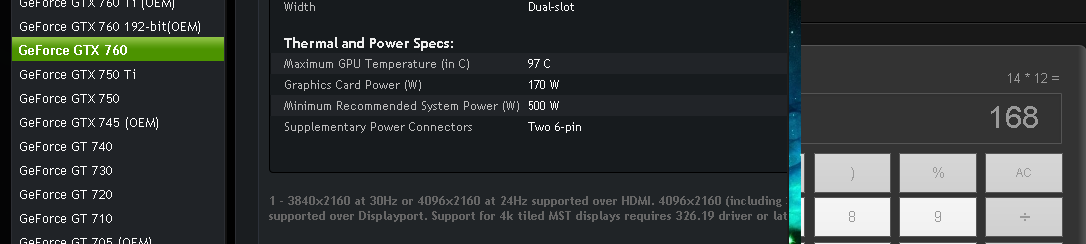

2 hours ago, Overlordik said:
Hello. My exp gdc turns off but laptop continues to work. I use GTX 760 and PSU 500w - 14a on 12v power line. Different versions of drivers I've tried - nothing. Plz Help me.
Do you see what your problem is?
Also, cheapo PSUs tend to have crappy power quality that causes hardware unreliability. Use something that was built better. Like a Silverstone or a Delta.

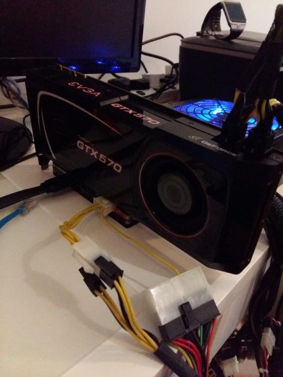

All my items are 2nd hand, and I am trying for some days now to get the egpu to be detected by the my laptopbut with no success.
I am not able to see the the GPU in my driver manager.
Here is gist of what i have and had done:
Setup:
I am trying with 2 laptops (both have an internal geforce gpu) both came out with the same failure.
Sony VAIO VPCS125FG using express card and ASUS X550LC using mpcie (plug to the place where the wifi was before)
Both using Windows 10, Sony is home version and Asus is Pro version
External PCI dock is EXP GDC Beast version 7.0, GPU Is evga gtx 570 and PSU is coolermaster gtx 650 w (52A on 12 v rail)
i've plug in 8 port to the Beast from the PSU and plug in from PSU 2 x 6 ports the top of the gtx 570.
Both laptop when i powerup PSU kicks in and the GPU fan starts and eGPU dock has redlight but on both occasions nothing got detected in my driver manager.

1 hour ago, pcctmudza said:
On the expresscard, tried to start the PC then plug in (GPU and PSU fan stop and start with no problem)
I believe you are supposed to plug in the EC part, then boot up the PC.
By "fan stop and start" do you mean they just spin for a split-second and then stop? If that's the case, you may have some PSU-related connection that's wrong, but from your pic I don't see any problems.
I had a similar problem when I first setup my GTX 580 eGPU. It turns out the GPU was so heavy that it tilted to one side of the adapter, and wasn't making good contact. So I stuck an eraser in between the card and the adapter to keep it on straight.
If there are any 8pin power connectors on your card, you have to plug in the additional 2-pin segments as well.
Wow didnt realise that GPUs can be that sensitive, you are right that it is tilted at one side as it is heavy, I will try this later today. This is a good tip thanks for this!
I suspected as well that lack of power on the GTX 570 but it has 2 x 6 pin
One other thing I was thinking, reading ady's message on the low cable quality, it could be the case on my beast cable to the ASUS laptop.
EDIT (2):
Tested EXP GDC Beast version 7.0 with GTX 750 ti using express card to the Sony Vaio VPCS125FG today and the Sony laptop was able to detect it with no issues through plug and play.
With this test, I can confirm that the EVGA GTX 570 is cause of the problem of not able to detect  eGPU in device manager through the Beast.
