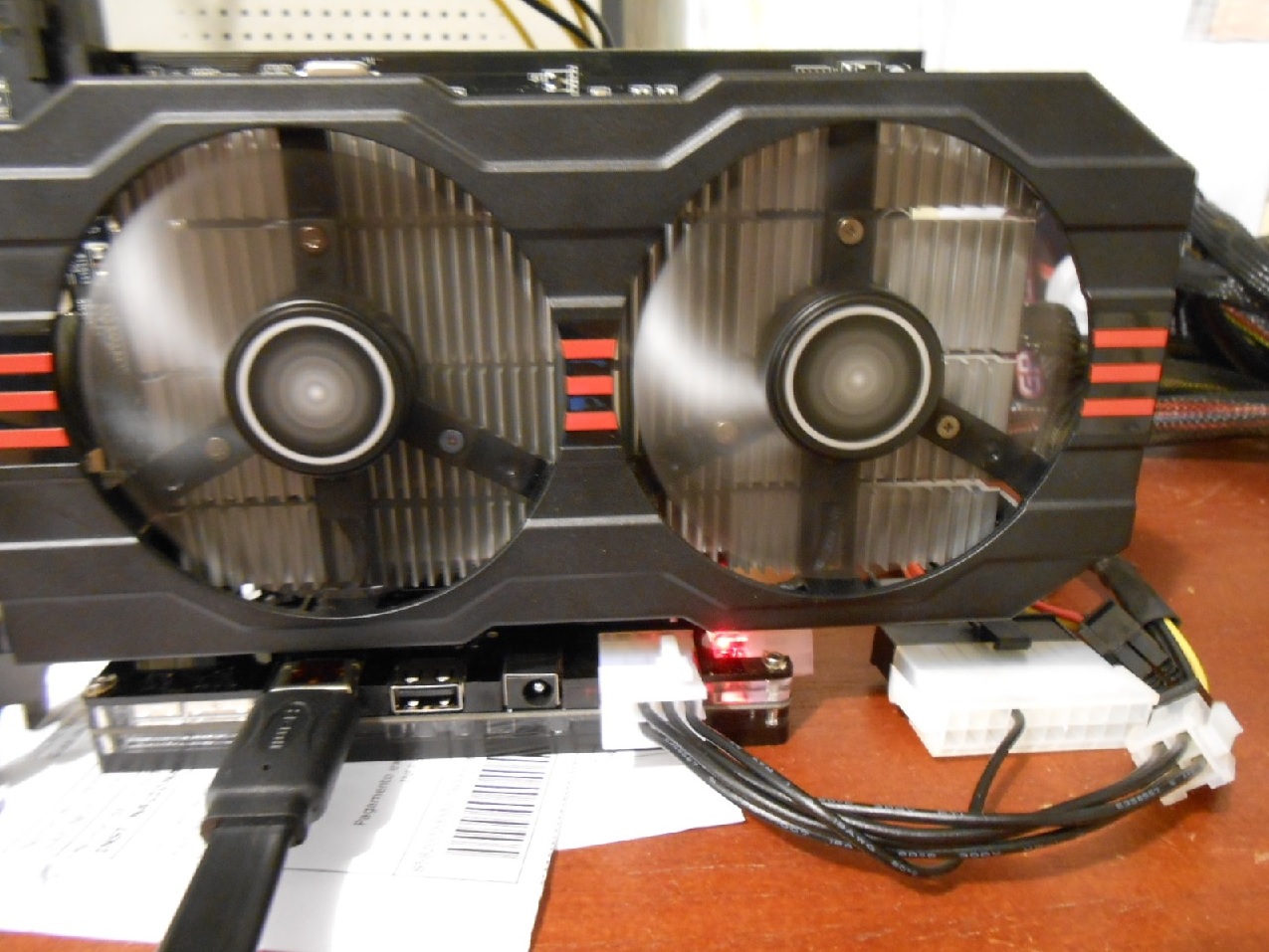

co11ider Posted September 26, 2015 Share Posted September 26, 2015 Everything is working kind of fine for me. Dell N4050, 2nd gen i3, Sandy bridge, 560Ti. First it was not working for me because I have been connecting the wrong 4 pin to the EXP GDC. I was the connecting the 4 pin in the (20+4) pin. When I realized I'm an idiot and connected the other 4 pin it booted fine and started working. But, still the PSU is a cheap 450 watts with 20A on 12V, which means it should provide 240 watt on 12v. But, PC is shutting off the instant I load furmark, which means card is consuming much more than 240 watts at peak. Thanks for the help everyone and I should try to get a proper PSU with 30amps+ on 12V, not DA2 or any cheap one.- - - Updated - - -Atleast I can play low intensive games smooth without PC shutting off. Quote Link to comment Share on other sites More sharing options...

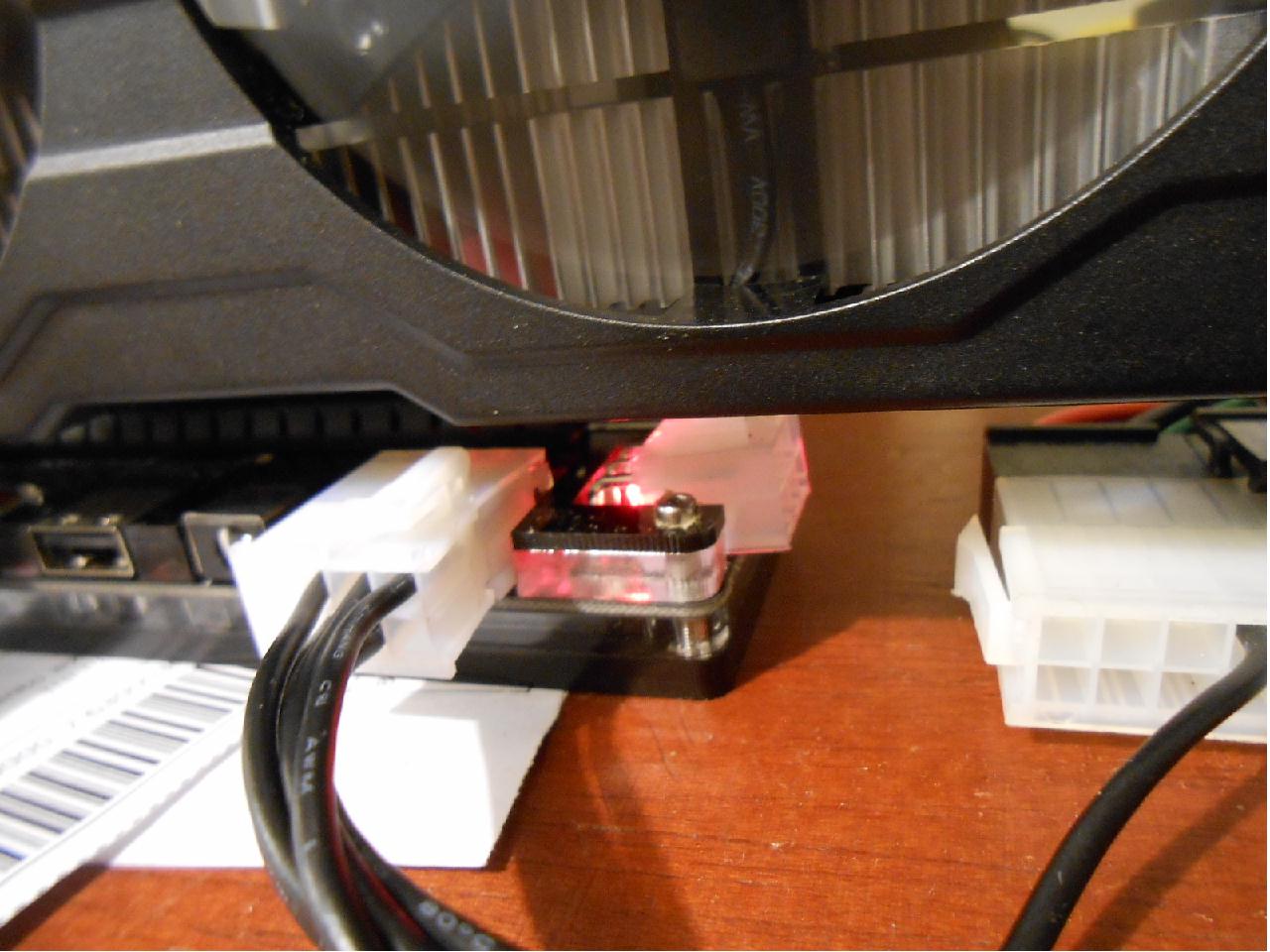

GPTeles Posted September 28, 2015 Share Posted September 28, 2015 Sorry bother you guys again, but i would love to know what does this red ligh means: Thank you again guys Quote Link to comment Share on other sites More sharing options...
co11ider Posted September 30, 2015 Share Posted September 30, 2015 Sorry bother you guys again, but i would love to know what does this red ligh means:It means its working (Its getting the power). All in order. Quote Link to comment Share on other sites More sharing options...

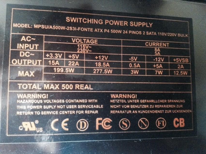

haniabaya Posted September 30, 2015 Share Posted September 30, 2015 Good Day,Unfortanly the EXP GDC Beast not working properly. I did everything like in the Tutorial and Still not Working I search the whole google and I couldn't solve the Problem. I put some pictures to show you what i did and where the problem is.EXP GDC - Album on Imgurmy Laptop: Acer Aspire V3-772G. Some people have the same laptop as mine and it worked.I did everything like in the tutorial and at the Boot i get a Black Screen just black and it stay like that.I even Disabled AND Uninstalled my graphic card from the Device-Manager in the Laptop (I have two, One [intel ..] and another one [From Nvidia..]) and deleted everything from Nvidia and still the same. The new Graphic Card that i bought is MSI Geforce Gtx 970.It turn on and everything work fine even the red lamp at the EXP is on but I still getting the Black screen.I hope you can help me, because I don't know what to do more.I have more pictures but I couldn't send all of them at once.Thanks Quote Link to comment Share on other sites More sharing options...
sangemaru Posted September 30, 2015 Share Posted September 30, 2015 Psu is rated to deliver around 160w per 12v rail. That's not enough. Find a connector to use both rails to plug into the exp gdc power cable. You might also need a DSDT override, since i doubt you have enough pci address space to run the card. Set PTD switch to 7s.Also, try hotplugging. Get to windows without exp gdc, sleep computer, plug in, resume from sleep. Does your bios allow you to disable the integrated nvidia gpu? If not, you might need @Tech Inferno Fan's setup 1.30 program. Sent from my Neken N6 using Tapatalk Quote Link to comment Share on other sites More sharing options...
haniabaya Posted September 30, 2015 Share Posted September 30, 2015 Psu is rated to deliver around 160w per 12v rail. That's not enough. Find a connector to use both rails to plug into the exp gdc power cable. You might also need a DSDT override, since i doubt you have enough pci address space to run the card. Set PTD switch to 7s.Also, try hotplugging. Get to windows without exp gdc, sleep computer, plug in, resume from sleep. Does your bios allow you to disable the integrated nvidia gpu? If not, you might need @Tech Inferno Fan's setup 1.30 program. Sent from my Neken N6 using TapatalkFirst of all thank you very much for the fast answer, finally some help.please step for step. So u mean i must change the ATX i must change the Power Supply with something bigger ( can you tell me with what or how much watt should i buy ?) what do you mean by find a connector to use both rails?Well i connected from the EXP GDC 6 Pin to the Graphic Card 2x- 6 pin everything in plugged in. is that what you mean ?I want to do DSDT http://forum.techinferno.com/diy-e-gpu-projects/3539-guide-dsdt-override-simultaneous-igpu-dgpu-egpu.html already checked that. but he do everything after he installed the new graphic. iam not even coming to windows at the boot i have black screen. Or i can already DSDT without the exp gdc ?i already switched the PTD to 7 and still same problem. but as you mentiod before when the PSU is not compatible then i must get new one and then try one more time to change the PTD to 7s.No my Bios dont aloow that i searched for every option in there but coudnt find anything. so i just uninstall everything form Nvidia and disabled the graphic card. but i dont know if that good enough.another question, i have an ssd and win 7 and i removed my cmos-battery so i dont need to flash bios every time something goes wrong so i just unplug the power and thats it. and everytime i do that i must change from Ufea to Legacy. do that have anything to do with the black screen ? thanks for the help i appreciate it really Quote Link to comment Share on other sites More sharing options...
sangemaru Posted September 30, 2015 Share Posted September 30, 2015 Unfortunately i'm writing from phone so it's hard to be too detailed. Your PSU should have two sets of 12V cables. You need to purchase a cable that unites those two rails into one and plug that into the exp gdc power cable, instead of using just one of the PSU cables. You can and should do the dsdt override before you set up the egpu adapter. I think win7 might not allow hotplugging and the use of more than one video card. I suggest you make a temporary win 8.1 install on a secondary media just to test egpu on it. Uefi/legacy should not influence the black screen as far as i know. Sent from my Neken N6 using Tapatalk Quote Link to comment Share on other sites More sharing options...
