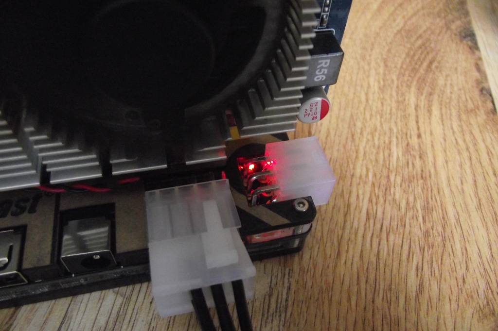

pony81 Posted June 26, 2015 Share Posted June 26, 2015 Hello! Recently I have bought EXP GDC Beast adapter with Mini PCI-E interface and I have a problem with it. I hope someone could help me. My specs. Asus K50IJ Windows 7 64-bit Intel Pentium T4400 Intel GMA 4500M RAM 4 GB For external graphics card I am using Geforce 3. In laptop BIOS there are no settings about PCI-E slot. Geforce 3 is a low power card so I can use 12V laptop adapter. I connect EXP GDC to laptop via Mini PCI-E interface, external monitor to Geforce 3. When I turn on laptop, Windows starts normally, but there is a black screen on external monitor, fan on a Geforce 3 is spinning, but there is a red light on a EXP GDC adapter. Windows could not detect any new hardware and when I tried to install Nvidia drivers I have a message “This graphics driver could not find compatible graphics hardware”. Changing CTD and PTD settings does not help. When I am using 300W ATX PSU it is even worse. Still there is a red light on a EXP GDC adapter, but fan on a Geforce 3 is spinning slower then before and laptop do not want to boot, not even to BIOS. Regards. Quote Link to comment Share on other sites More sharing options...

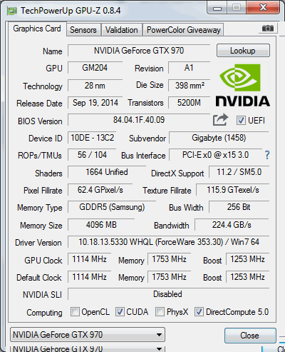

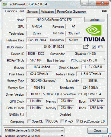

Guest Posted July 3, 2015 Share Posted July 3, 2015 Would the EXP GDC Beast along side with a GTX970-DCMOC-4GD5, GB-BXi7-4770R, with the Dell 220W adapter be a good compatibility? If not what is the worst possible outcome of incompatibility? Quote Link to comment Share on other sites More sharing options...
