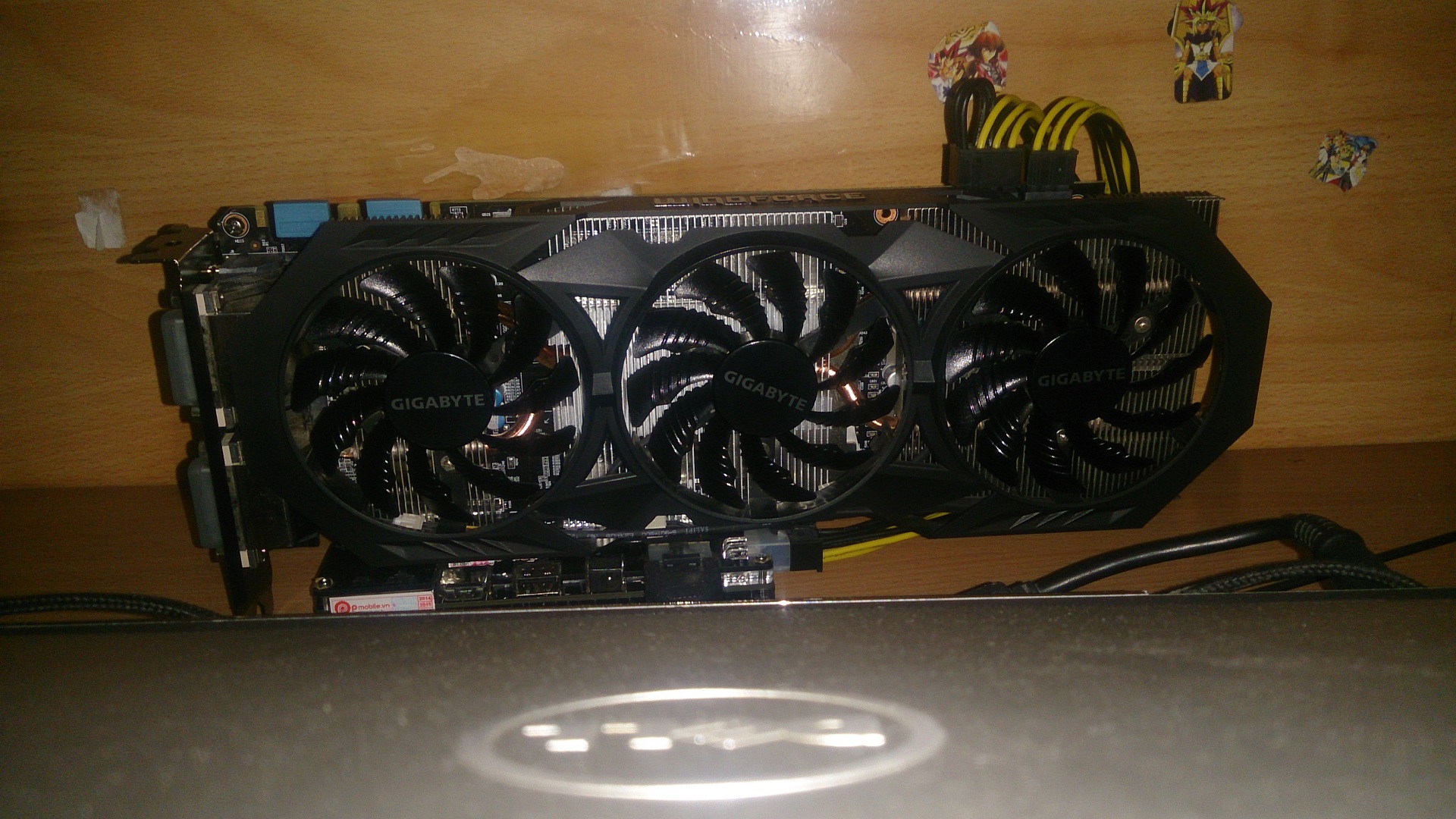

Hi!
I am new here, I have ordered EXP GDC Beast already but I can not decide which GPU should I choice, hope you will give me some advice.
My setup:
Lenovo y580
CPU: i7 3630qm
RAM: 16 GB,
Power supply for EXP GDC: DELL DA-2 220W.
I was thinking about MSI GTX 960 ARMOR2 and GIGABYTE GTX 970 WindForce3.
Which one should I pick? WILL BE DA-2 220W enough for this?
Thank you for answers.
i have GTX 970 WF3XOC and Dell DA-2 can handle this, 970 is the best choice :)
EXP GDC BEAST has 6 PIN connection for additional power supply but GTX 970 WF3 requires 6 PIN + 8 PIN connection. So if I plug 6 PIN to EXP GDC and both cable ends which are 6 PIN and 8 PIN to GTX, will it work properly?
It will be OK, bro
