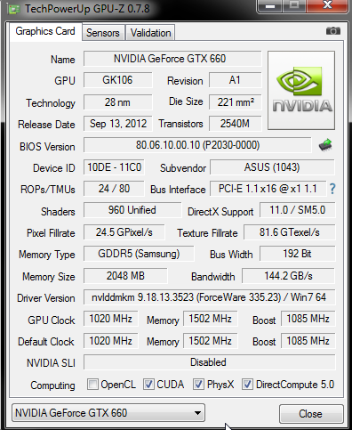

Your GTX660 would already be running at x1.Opt speed. You can confirm this by running 3dmark06. Typically you'd see a 3dmark06 of ~5k if Optimus compression is disabled on a x1 1.0 link. With compression enabled it will be > 15k with a GTX660. Optimus giving you an accelerated internal LCD mode too if decided to run without
an external LCD, though at a bandwidth penalty.
HD4770 would require the Setup 1.x software to overcome the error12. Hardly worth pursuing. It's a dog of a performer compared to a GTX660 or your earmarked GTX750. Either is the way to go gaining you x1 pci-e compression performance and internal LCD mode features of NVidia Optimus. Hence why NVidia eGPU implementations significantly outnumber AMD ones.
Ok since I'm a bit confused by the x1 speeds and on what em i currently running here is a screen shit from the GPU-Z, also note that the 660 was recognized as a second VGA, intel HD as a primary one. Basically is this the best setting i can go with or is there still some place for improvement? Because i see that even with eGPU are people getting much better scores in benchmarks then i do.
I was also running some benchmarks again and in 3d mark 06 i get only 13916
http://www.3dmark.com/3dm06/17576890
So i still feel like something is not completely right :(
