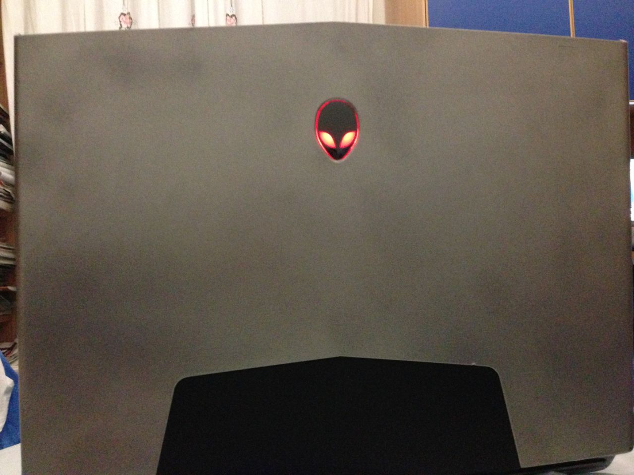

I wanted to paint my alienware also because I got broken in the first slot of the video card, thanks to the fiberglass has adjusted all without leaving a trace;

as soon as I finish painting the top part of the perfectly place photo:Banane06:
That is awesome! did you leave the aluminium on the heatsink? I might be doing that to my R4 but for the cpu as the 3940xm gets hotter than the 3630 I currently have :P anyway, thanks for the idea ^^ good luck with your mods.
Finish , but i like new color xD , I think I paint it back on the light blue / light blue: P
I left it as aluminum, another hack was take the card and paste it under the fan so that the air is projected into the sink and in fact now putting his hand behind you hear a large amount of air to escape, thanks to with all this metal gear rising to reach the maximum 63°!
