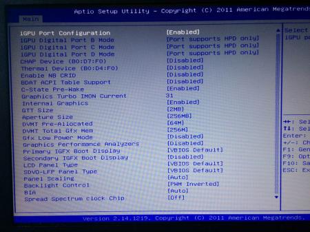

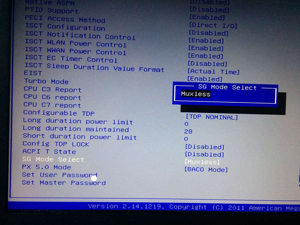

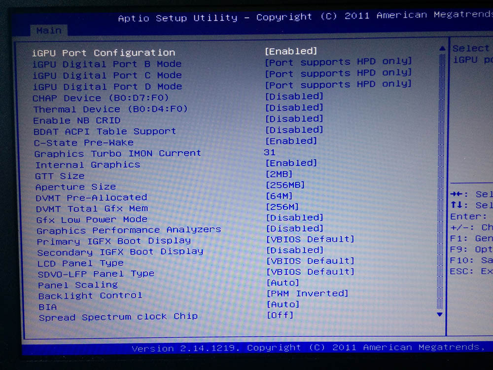

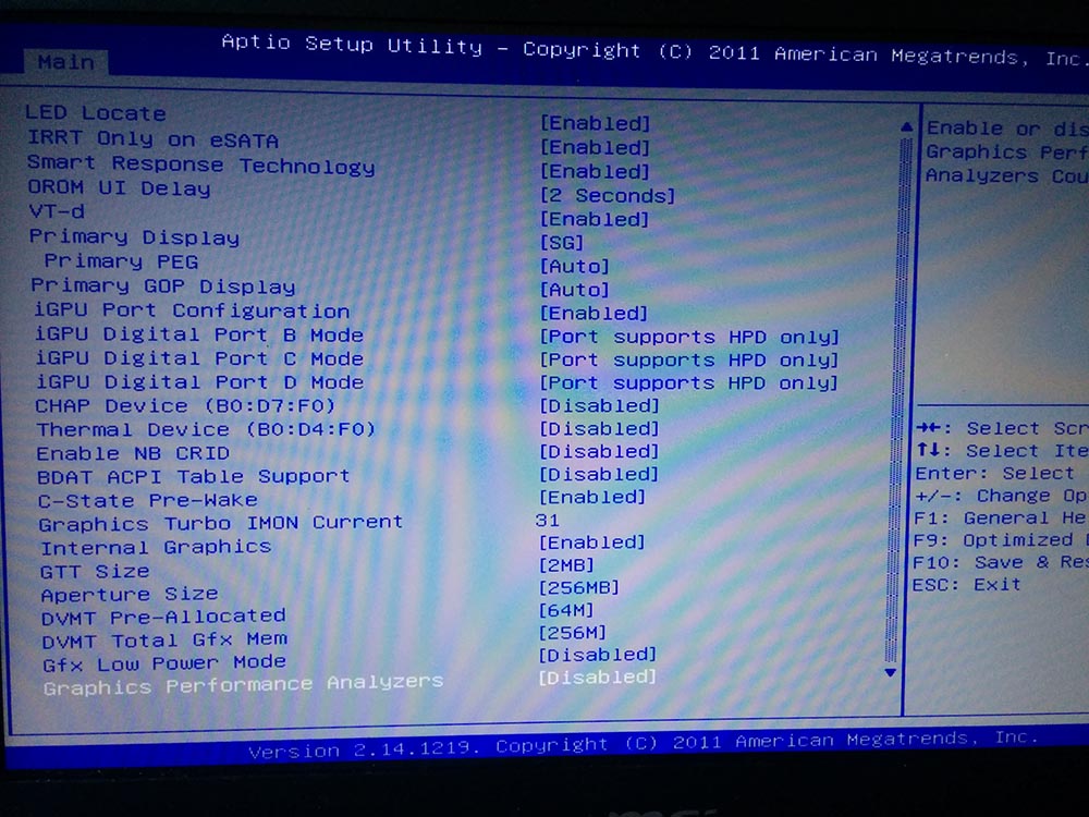

Loïc Marin 10 Posted April 12, 2014 Hi! I recently upgrade my gpu from 670mx gtx to 780m gtx! My board is ms16f3. (msi gt60 0nc) Unfortunatly, I made a bad vbios flash :-( Now : If i boot with 780m: stuck at msi logo screen If i disable 780m, the laptop boot without problem but i have no access to the card → no nvflash to recover If i remove the card, boot without problem If i boot with the old 670mx → no problem Please, is it possible to force boot on igp while keeping the 780m awake and so make a nvfash? I have an unlock bios : Thanks in advance! Quote Share this post Link to post Share on other sites
