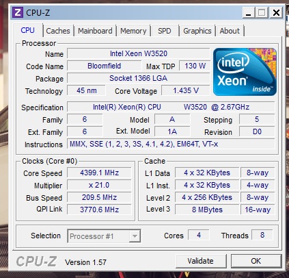

Here's my x58 system in the other room, custom water loop. 4.4 ghz stable, clock never changes in windows. And never throttles under load either.
Edited by Kithylin
Now for further tweaking... if you want overclocking tips...
One of the things to do is under Ai Tweaker in bios, make sure Load-Line Calibration is switched from Auto Enabled. This will make the board control vdroop directly, and prevent your cpu's voltage from fluctuating between load/idle. For greater stability. In my x58 system I didn't touch anything but cpu voltage and left the rest on Auto. Although my chip needs up like 1.55v for 4.4 ghz.. not a good clocker. But it does do it.
