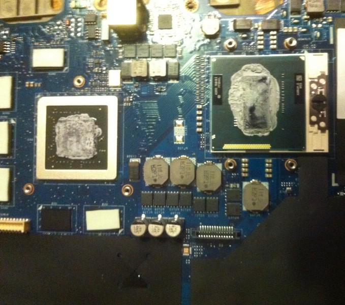

I was having very similar problems with temperatures. While running certain game software, I was getting a scary 98 degrees C. My M14X has been this way ever since I bought the laptop. I left it go and ran it that way for 1 year and 11 months. I couldn't stand it anymore, and I thought that the laptop was almost 2 years old, so I took a chance at fixing the problem. I went to Youtube and typed in M14X disassembly and paused the video as needed, following each step. I finally got to the point where I could change the heat sink paste. The old paste was hard and was not applied well. I cleaned the areas needed and put on new paste. My temperatures went from 98 peak to 82 peak, so it was well worth it to me. The problem finally got fixed. One last note is that I learned to blow canned air from the backside of the computer (Heat sink) and not from the fan side. If you end up tearing yours apart, I think you will see what I mean.post-24184-14494997339171_thumb.jpg

Thermal paste had never failed me before at least the good ones. I too once had some serious overheating issue on the m14x r1, applied new thermal paste to both cpu and gpu fixed the problem. I'm not sure about thermal pads though never used them before. Maybe someone experienced in using both of these can enlighten us?
