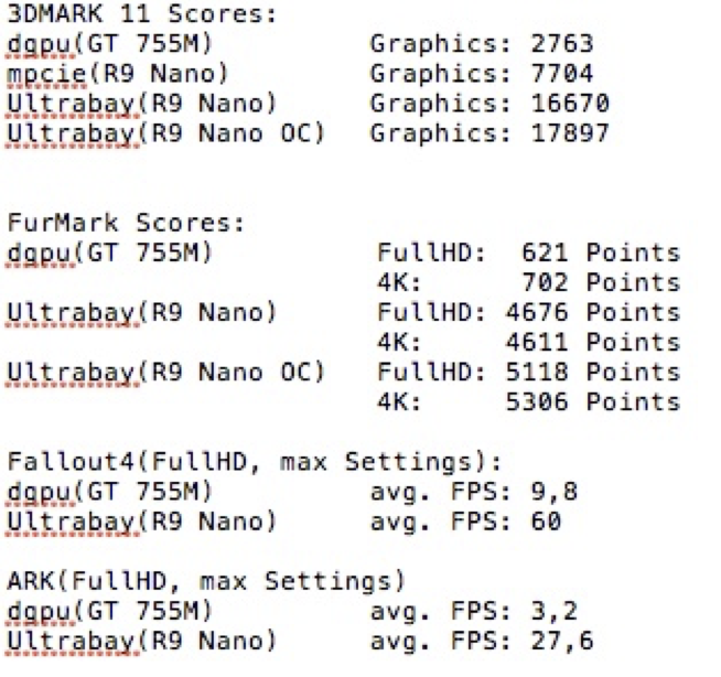

Benchmarks:
dgpu means the original nvidia GT755M graphics card, mpcie a PCI x1 adapter from the WLAN interface -> you need a special BIOS for this solution, Ultrabay -> that's the adapter, and OC means an overclocked R9 Nano.
I'am also an electronic engineer for industrial control. But a PC/Laptop is not so far away from a PLC:-)
Mass production depends on the result of the kickstarter project. Currently the demand is not really high but maybe it increases with the benchmark results :-)
13 hours ago, gerald said:
Benchmarks:
Congratulation! Pretty interesting numbers, performance is on par with desktop setups.

Videos are a lot of work. Please believe me that these results were really measured on my Y510p.
You can adapt the height of this adapter by the three distance bolts. This should fit all your requirements.
