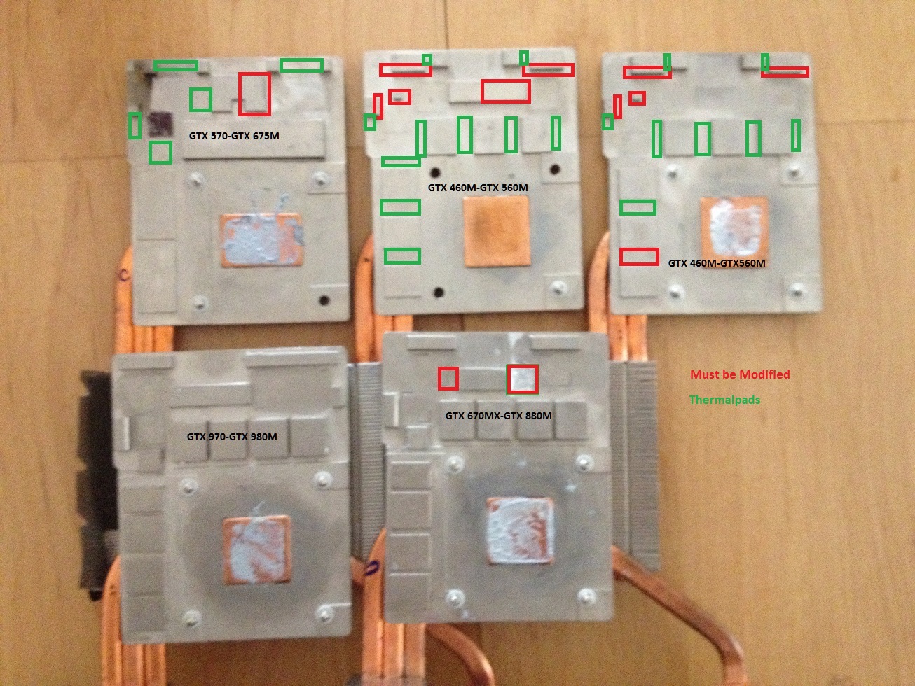

PixelRaide Posted September 25, 2016 Share Posted September 25, 2016 Hello guys ! Found a GTX 570M heatsink : Can i use it for a K4100M i'm planning to buy ? Quote Link to comment Share on other sites More sharing options...
Bloetschkopf Posted September 25, 2016 Share Posted September 25, 2016 (edited) Hello Is no Problem to use it for K4100M,but You have to fill up some Parts with Thermalpads. In the Picture You can see the different Heatpipes,Yours is the bottem left. You need normaly the top right,there You can see the Different. The Marks are for Changing Heatpipes for GTX 980M. Edited September 25, 2016 by Bloetschkopf Quote Link to comment Share on other sites More sharing options...
PixelRaide Posted September 25, 2016 Share Posted September 25, 2016 1 hour ago, Bloetschkopf said: Hello Is no Problem to use it for K4100M,but You have to fill up some Parts with Thermalpads. In the Picture You can see the different Heatpipes,Yours is the bottem left. You need normaly the top right,there You can see the Different. The Marks are for Changing Heatpipes for GTX 980M. The 570M is at the top Left and not at the bottom Left as you said, right ? My main concern is the different chip layout ^^ Quote Link to comment Share on other sites More sharing options...
Bloetschkopf Posted September 25, 2016 Share Posted September 25, 2016 (edited) Sorry,wrong Picture Edited September 25, 2016 by Bloetschkopf Quote Link to comment Share on other sites More sharing options...
PixelRaide Posted September 25, 2016 Share Posted September 25, 2016 So the 20mm height of the part in contact with the chip isn't an issue ? And the width ? Sorry but i need to be sure ! Quote Link to comment Share on other sites More sharing options...
Bloetschkopf Posted September 25, 2016 Share Posted September 25, 2016 16 minutes ago, PixelRaide said: So the 20mm height of the part in contact with the chip isn't an issue ? And the width ? Sorry but i need to be sure ! IT is with the K4100M no Problem,i used it without Problems for a GTX 680M. Here a MSI Vbios for it with 824MHz Basic Clockrate. The Performance is like GTX 680M with it. K4100M.rar Quote Link to comment Share on other sites More sharing options...
