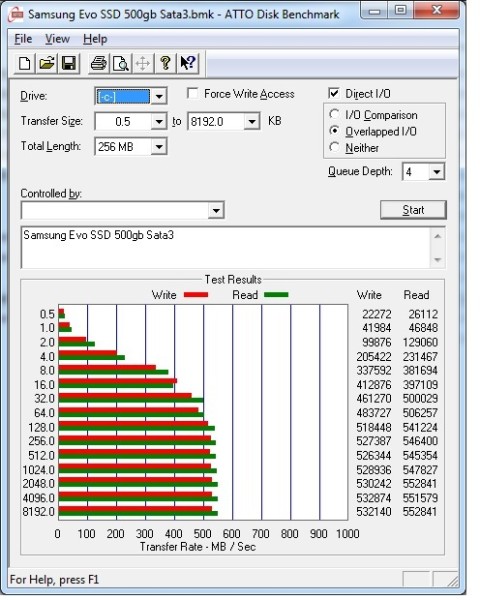

NforceRaid Posted January 20, 2014 Share Posted January 20, 2014 Also, do I need the Intel Rapid Storage Monitor update for any ssd or just specific ones? I haven't installed it yet (don't know if it automatically did either). But AHCI is enabled try doing a test with ATTO Disk Benchmark, you should have the transfer rate on the 500 MB/s. my bench: ciao edit: I have not installed RST Quote Link to comment Share on other sites More sharing options...
exabyte407 Posted January 20, 2014 Author Share Posted January 20, 2014 try doing a test with ATTO Disk Benchmark, you should have the transfer rate on the 500 MB/s.my bench: [ATTACH=CONFIG]10651[/ATTACH] ciao So... I actually can't see (or post) pictures yet for some reason haha. But I did the ATTO Disk Benchmark with a transfer size of .5 to 8192 kb with a total length of 1 gb. The max I hit was 250 MB/s. So.. I'm guessing that's slow. Also, I didn't mention before, but when it says I'm using 100% of my disk (and running slowly), it's only using 0.1-0.3 mb/s Quote Link to comment Share on other sites More sharing options...

NforceRaid Posted January 22, 2014 Share Posted January 22, 2014 So... I actually can't see (or post) pictures yet for some reason haha. But I did the ATTO Disk Benchmark with a transfer size of .5 to 8192 kb with a total length of 1 gb. The max I hit was 250 MB/s. So.. I'm guessing that's slow.Also, I didn't mention before, but when it says I'm using 100% of my disk (and running slowly), it's only using 0.1-0.3 mb/s if your max transfer rate is 250 MB/s and your ssd is connected to sata2, it means that it's perfectly But you have to understand why it is always or almost 100% you have tried to see in the task manager which is the task that you care more cpu? ciao Quote Link to comment Share on other sites More sharing options...
exabyte407 Posted January 28, 2014 Author Share Posted January 28, 2014 if your max transfer rate is 250 MB/s and your ssd is connected to sata2, it means that it's perfectly But you have to understand why it is always or almost 100% you have tried to see in the task manager which is the task that you care more cpu? ciao Yeah, I think the main reason that I'm having so many issues is just the drive is really bad. Looking at reviews, everyone else who bought it also had the same problems. A firmware update will probably fix it, but I need to burn myself a win8 cd before I do that just in case. My cpu is staying relatively low. Usually doesn't use more than 25% and stays under 5 most the time. Anyways, thanks everyone who tried to helped me with this problem. I think I'll just get a new drive at some point (currently studying abroad so it'd be hard to get one here, but it'll be the first thing I do when I get back) Quote Link to comment Share on other sites More sharing options...
