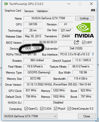

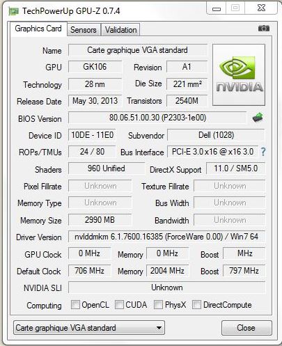

Here I put in attachment that gives me GPU-Z about the GTX770M.
I would also need the. Inf for this card. PCI\VEN_10DE&DEV_11E0&SUBSYS_05511028&REV_A1\4&13F92896&0&0008
How is flashing the bios FPT mode (I can not find the details of the tutorial).
The vbios on the card is good or bad.
thank you
