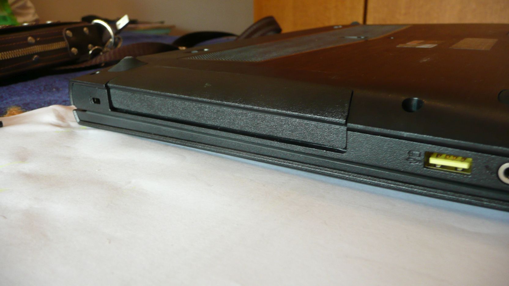

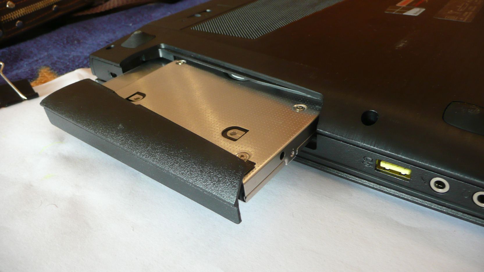

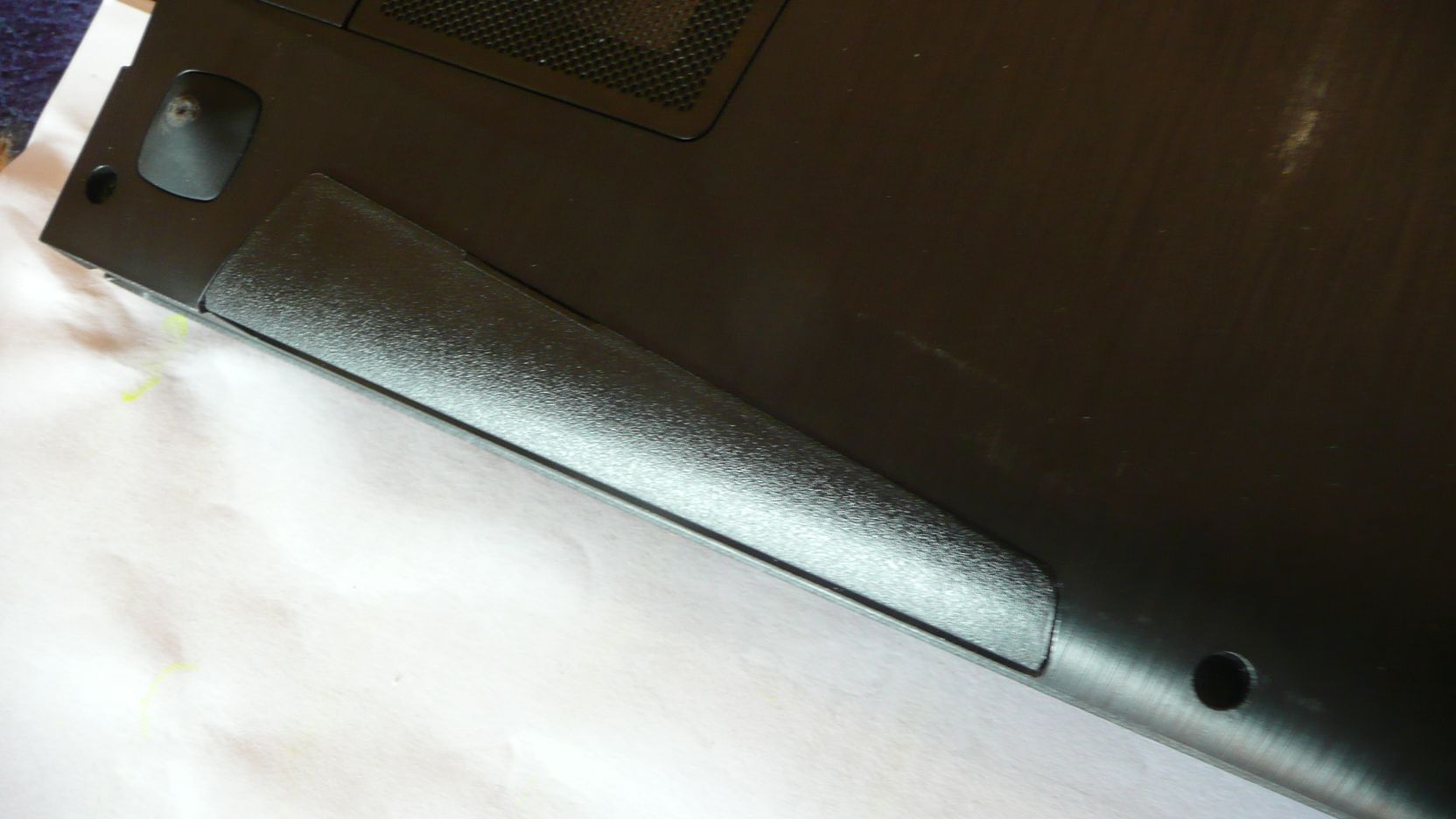

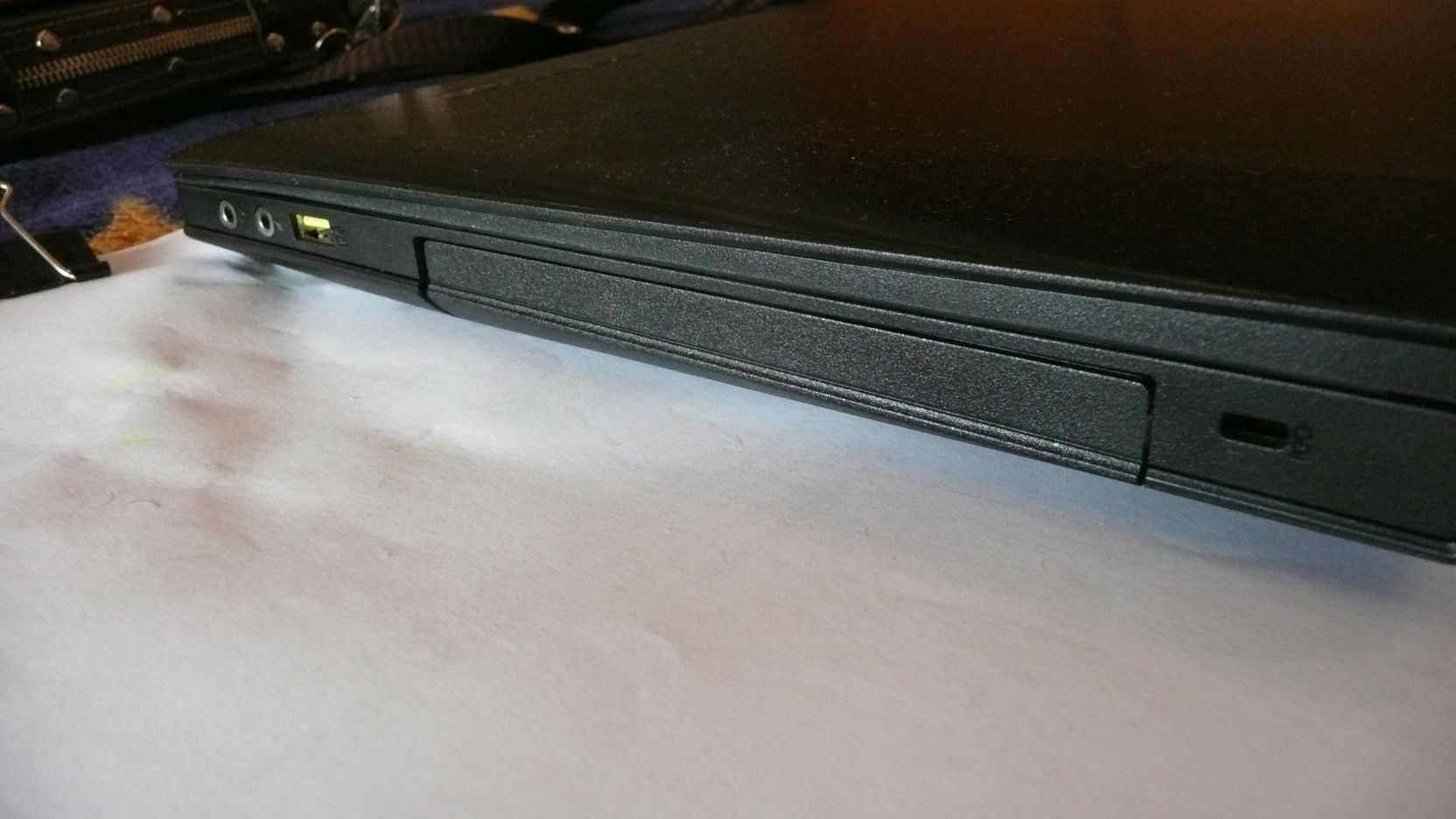

I have just recieved this y510p hdd caddy:
2nd HDD SSD Hard Drive Caddy for Lenovo IdeaPad Y500 Y500N Y510P | eBay
It came together with a bezel. And it i HOT Swappable - if I boot into Windows 8.1 with it, I can remove it, replace hard drive and insert it into the ultrabay slot again.. Here are some photos of the bezel they provide together with hdd caddy:
For a price of 16 dollars, its super nice! I inserted into it original 1 TB hdd which came with y510p (I use ssd inside computer mSata) and I get 100 MB/s speed even.

I think its good not to have a bracket - it holds quite well in place and is hot swappable - so I can remove the caddy and put it back without windows restart.
