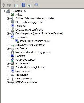

silverdessert Posted January 26, 2019 Share Posted January 26, 2019 hi @ll could someone help a newbee ( me) have bought a new card for my laptop on ebay because the old one is "brocken" these is the new one : Nvidia GeForce GTX 880M 8GB DDR5 MXM 3.0 Type B for MSI Clevo #303019526970 the seller told me that i must modify the driver inf. but i dont realy understand enough what i have to do i downloadet a driver from www.msi.com/laptop/gt72-2pe it shows not the new card only the onboard PCI\VEN_8086&DEV_0416&SUBSYS_11181462&REV_06 PCI\VEN_8086&DEV_0416&SUBSYS_11181462 PCI\VEN_8086&DEV_0416&CC_030000 PCI\VEN_8086&DEV_0416&CC_0300 Quote Link to comment Share on other sites More sharing options...

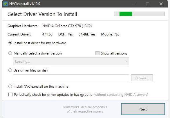

DeG Posted May 9, 2022 Share Posted May 9, 2022 Yop all, Test this software its realy good NVcleaninstall all download directly branch binaire and more avanced option after install and compile directly New setup.exe. > Disable signature ect Quote Link to comment Share on other sites More sharing options...
