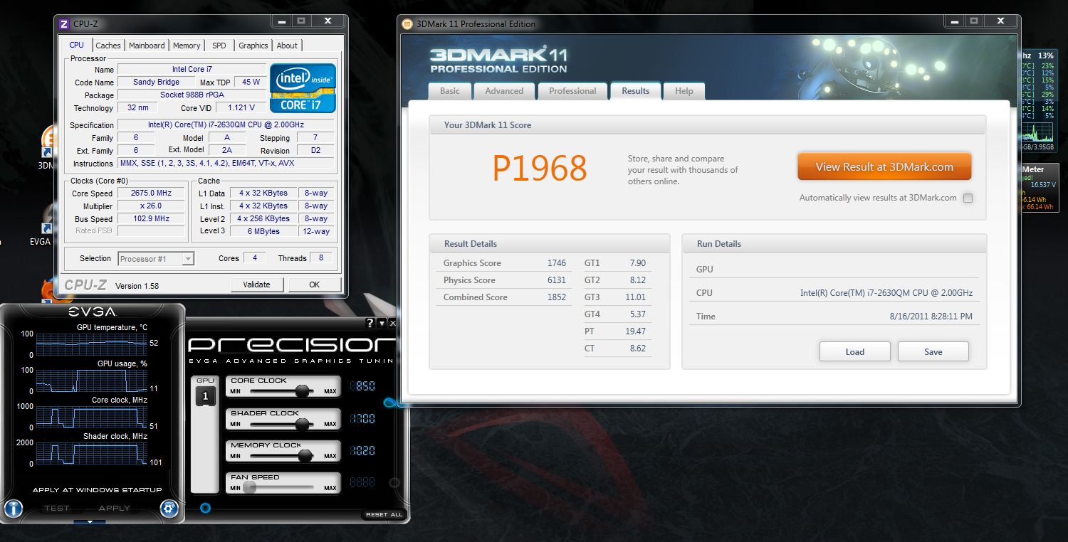

n3ocort3x Posted August 16, 2011 Author Share Posted August 16, 2011 (edited) i7-2630QM Core: 850 MHz ; Shaders 1700MHz ; Memory 1020 MHz 3DMark 11 remember that is the weaker CPU... if i had the stronger... 2000 would be possible with that clocks... @ slv7 that is not the end... I can´t go higher at the moment because I need more volt, please mod me one with 1,00 V instead of 0.93 V. The Temps are more than ok ! Edited August 16, 2011 by n3ocort3x Quote Link to comment Share on other sites More sharing options...

n3ocort3x Posted August 16, 2011 Author Share Posted August 16, 2011 yeah see what you can do... i can smell the 2000 Points in 3DMark11... xD No hurry slv7... I´m sure when we can code the 1 Volt setting in the BIOS 880 - 900 on the Core are possible...other question: How dou you extract the VBIOS from the .exe... ?? I modified BIOS for ASUS Boards (but only Microcodes for CPU support and "easy stuff") I would be interested how you extract it and how the strings are changed ?? (maybe the name of the program...)As I said... there is so much potential in this M14X and now we have unleashed it... xD I can´t say how happy i ´am... xD 1 Quote Link to comment Share on other sites More sharing options...

Stevenxowens792 Posted August 16, 2011 Share Posted August 16, 2011 I notice that both Neo and Dane seem to have the purchased version of 3dmar11 since the score is from a different source than the internet page. Im also wondering what is different about the free version of 3dmark11 vs the paid version. Quote Link to comment Share on other sites More sharing options...
DaneGRClose Posted August 17, 2011 Share Posted August 17, 2011 There's no difference when you run it at the settings most people go by StevenX, the main differences are being able to:Run different tests(additional)Run different settingsView the scores in the app rather than online Quote Link to comment Share on other sites More sharing options...
