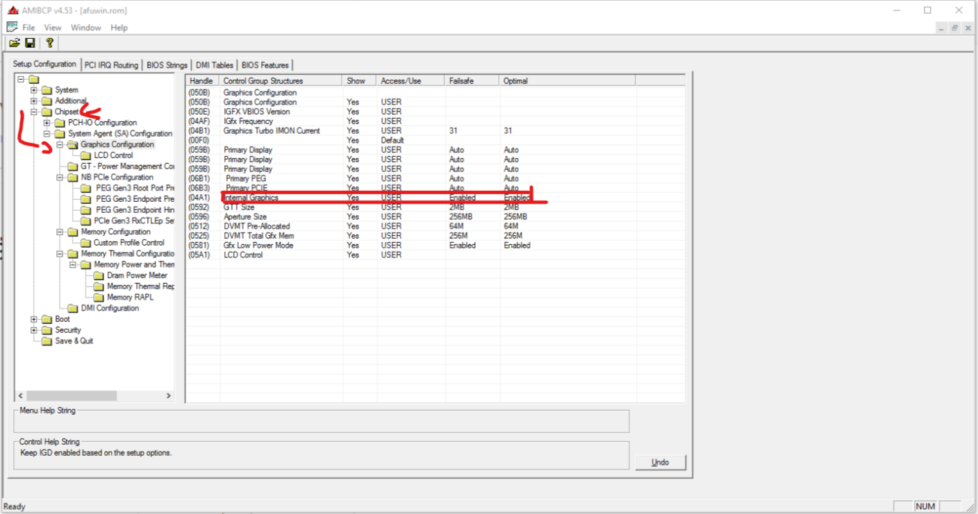

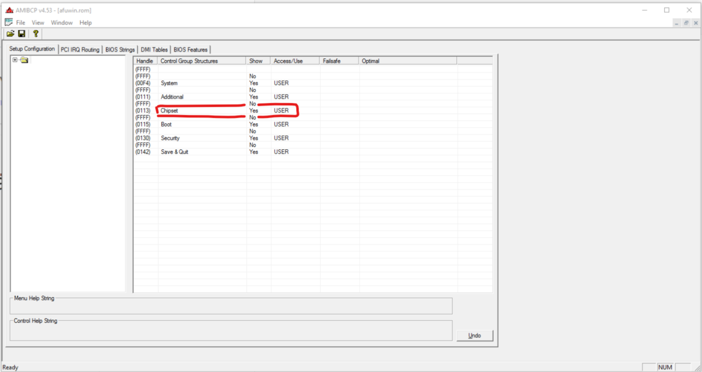

Skankhunt42 Posted September 20, 2017 Share Posted September 20, 2017 17 hours ago, Klem said: Yes. Hi Klem, i have still one Problem, In AMIBCP i can see a Tab called "Chipset" where the setting for the integrated GPU is. I already set it to "USER" but it wont show it to me in the flashed BIOS. If i change the setting (in this case to activate internal GPU ) directly in AMIBCP it wont apply them. Still only the GTX 770m is active. The BIOS just dont apply my settings..I can set everything to "USER" and the BIOS will show it to me, with except the "Chipset" Tab. (screenshots) Thanks for your response Quote Link to comment Share on other sites More sharing options...
