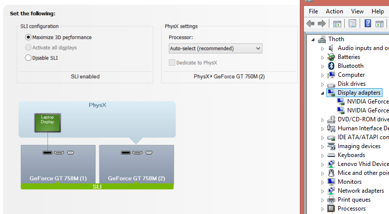

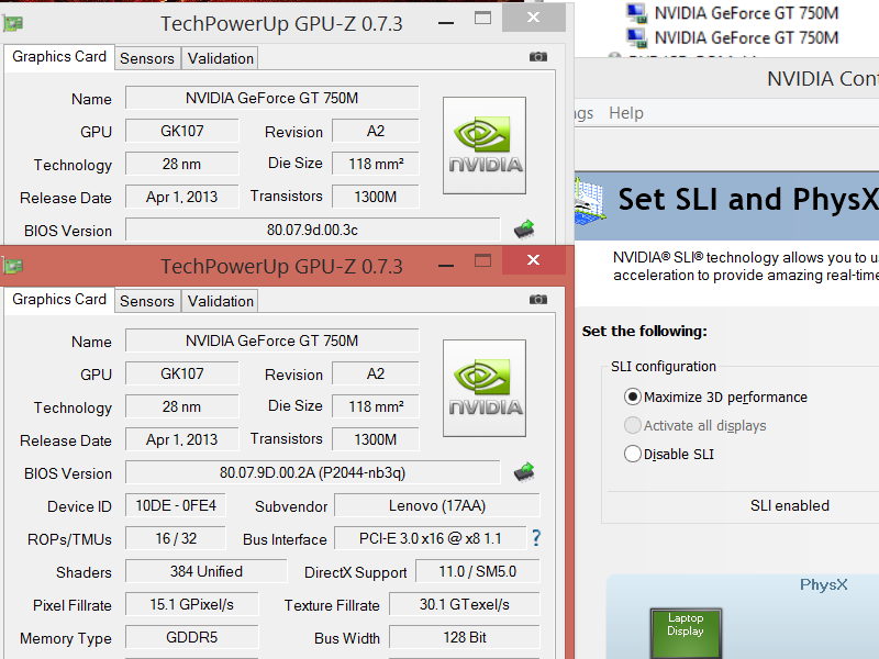

Here is a screenshot of the device manager, gpu-z for each gpu, and SLI status. The only thing different between the internal and external GPU are the bios versions.
Things are blurry because windows fails with >96ppi displays (come on microsoft).
Please reply with any questions or comments.
[ATTACH=CONFIG]9299[/ATTACH]
What is the driver version in your machine?
Because when i installed 320.49 then i can enable sli and work in 2d but after when i start a game it crash only restart works...
