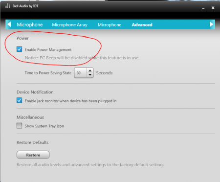

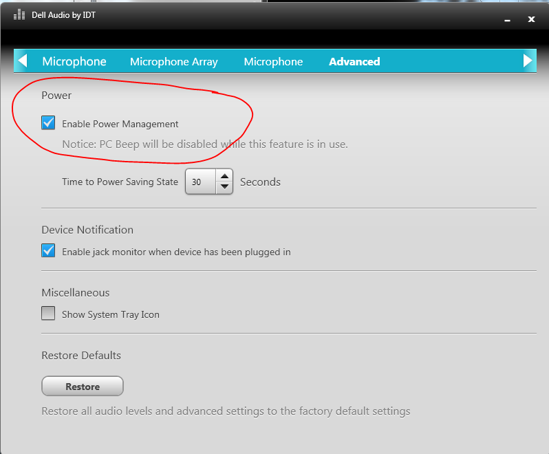

I have been "struggling" to install a GTX 780M in a Alienware M17X R3 (3D, 120HZ, so no optimus / IGP)
There where conflicts getting the IDT and GPU running together. White, Yellow, Pink screens :)
I found out the following using IDT Control Panel. Unchecking the option [Advanced>Enable Power Management], results in black screen and sound getting messed up.
post-17588-14494997917511_thumb.png @Jinx1337: I don´t know your IDT Audio Control Panel settings, but maybe this discovery, leaving Enable Power Management checked, can help.
  • Thumbs Up 4
