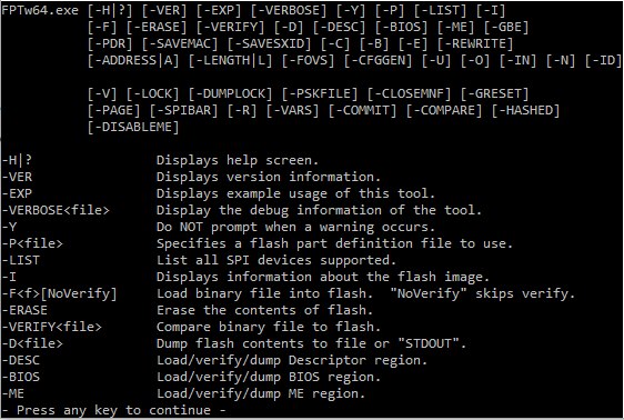

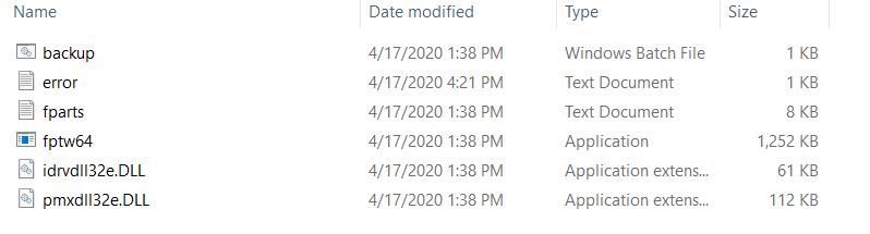

Edit: yeah, looks like I just didn't know how to run a .bat file.  I'm fine deleting this post if someone can tell me where/how to do that.
I'm new to this, so there's a decent chance I just don't understand what's going on, but instruction (1) is confusing me.
I've got all the files downloaded, but I don't know if I'm supposed to be running that fptw64 application first and then the .bat file or what.
Also, when I run the fptw64 application, it opens the cmd window and just has a list of functions, with "press any key to continue" prompts twice and then automatically closes.  An error file is then generated that has the text inside "Error 200: Invalid parameter value specified by user. Use -? option to see help."
I don't want to continue with the instructions because it seems like some sort of actual backup file is supposed to be getting generated and that's not happening.
Hi!
Don't run fptw64.exe!
Just run backup.bat
