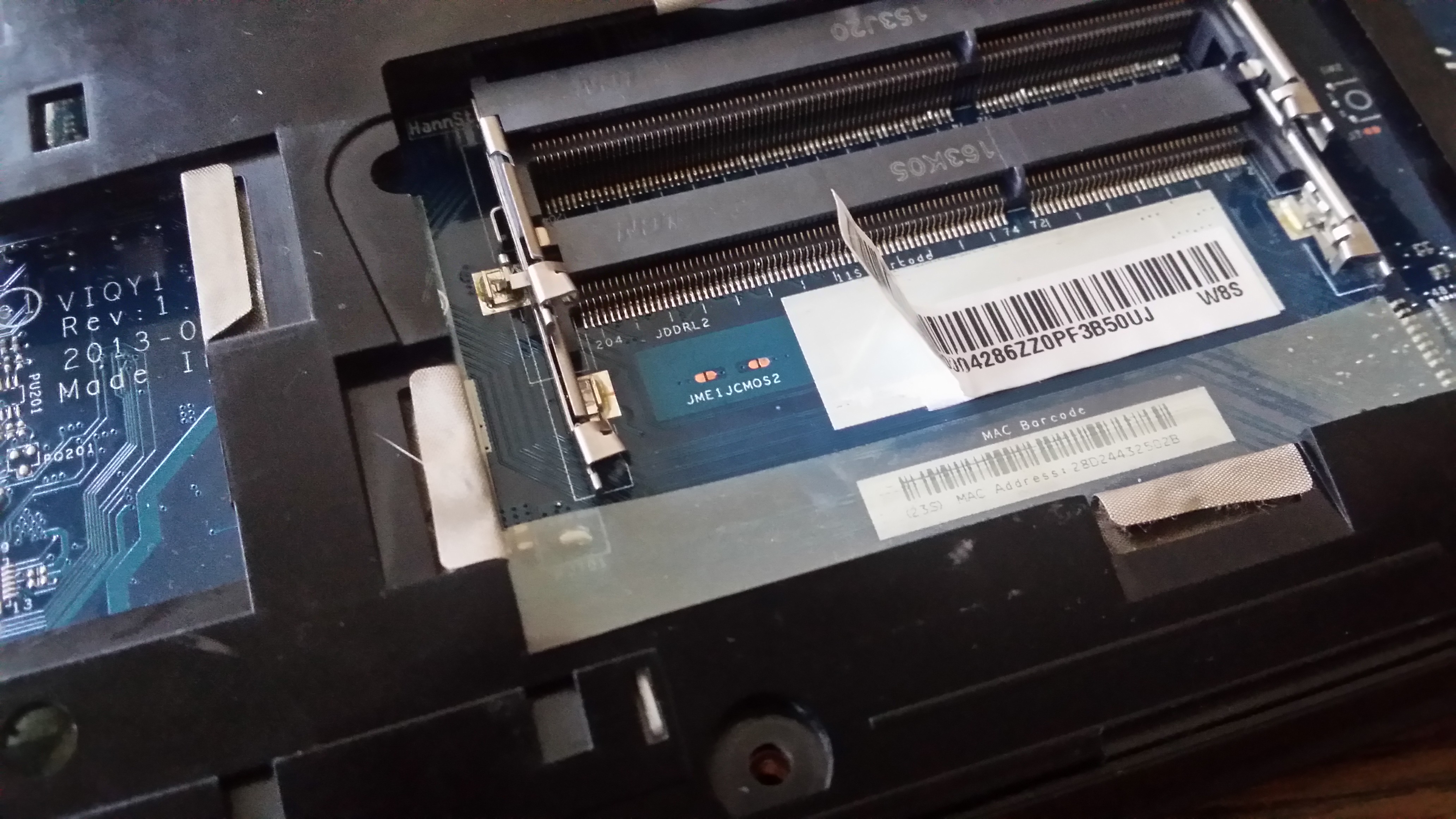

dan71 Posted October 29, 2016 Share Posted October 29, 2016 (edited) 9 hours ago, dan71 said: Already try that, only coller start to spin and keyboard light up Found there is no need to unsoldered coin lithium for bios, under lover sodimm you will find 2 contact for reset. But this not solve my problem still bricked I will buy my bios chip from ebay, change it and I will unlock again, but not use it for eGPU. Edited October 29, 2016 by dan71 Add some Quote Link to comment Share on other sites More sharing options...
Imrule Posted October 29, 2016 Share Posted October 29, 2016 19 minutes ago, dan71 said: Found there is no need to unsoldered coin lithium for bios, under lover sodimm you will find 2 contact for reset. But this not solve my problem still bricked I will buy my bios chip from ebay, change it and I will unlock again, but not use it for eGPU. Desoldering the CMOS battery and soldering it back on worked for me but only twice was I able to boot into my OS. Unfortunately I wasn't able to reproduce these results. I just need to boot into my OS one last time so that I can flash my bios back to stock. Where are the reset contacts specifically, can you post a pic of it? Quote Link to comment Share on other sites More sharing options...

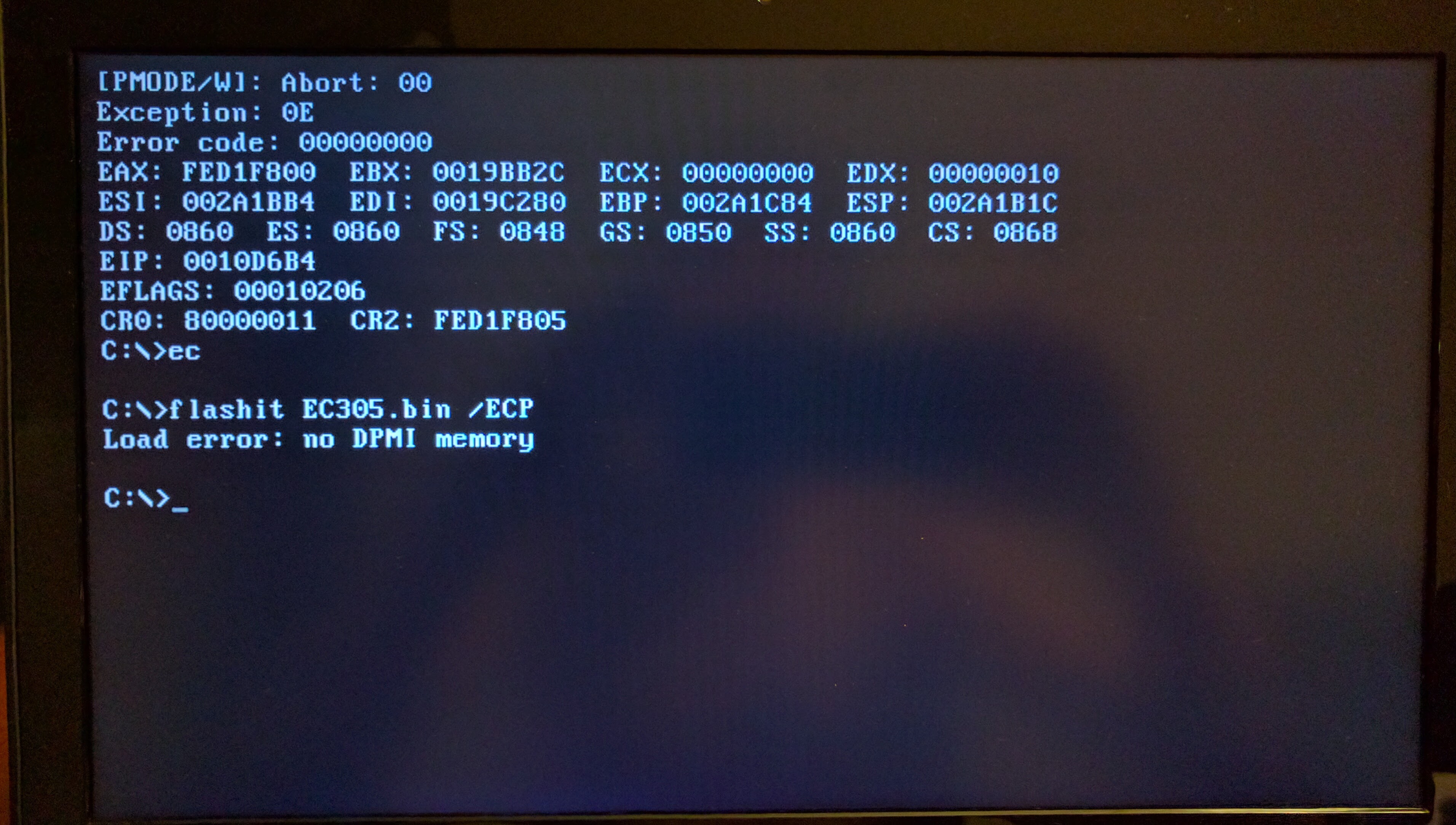

t1mman Posted November 10, 2016 Share Posted November 10, 2016 Tried a couple of times, I'm always getting this: Using Y510P Core i7 4700 Dual GPU GT750M I was on 3.07 originaly, so I did: -Flashed 3.05 -Created the hacked v305mod.bin -Installed 2.07 stock -Rebooted with USB thumb drive, then I ran bios and I get this (The error when running EC is also there) What am I doing wrong? Thanks! Quote Link to comment Share on other sites More sharing options...
t1mman Posted November 11, 2016 Share Posted November 11, 2016 (edited) Nevermind my post, turns out you don't need to copy the whole win98_files folder after, all those apps end up loaded in the ram and saturate the thing! Tried it without coping everything and it worked great! Now I have my 7260 working!! Still, one question: Do I need to do the whole nvflash procedure if I don't intend to overclock the GPU (I have the SLI setup)? Edited November 11, 2016 by t1mman Quote Link to comment Share on other sites More sharing options...
mamislimen Posted November 14, 2016 Share Posted November 14, 2016 Please help Flash bios successful installed with no error but when i run EC i have this error: dos memory buffer 2 allocate failed Any solution ? 1 Quote Link to comment Share on other sites More sharing options...
tecnicksx Posted November 18, 2016 Share Posted November 18, 2016 (edited) my battery is dead can i do it without battery ? i fixed battery bios flashed without error but on EC command errors dos memory buffer 2 allocate failed help pls Edited November 18, 2016 by tecnicksx Quote Link to comment Share on other sites More sharing options...
blueluke234 Posted November 19, 2016 Share Posted November 19, 2016 (edited) On 11/11/2016 at 8:03 AM, t1mman said: Still, one question: Do I need to do the whole nvflash procedure if I don't intend to overclock the GPU (I have the SLI setup)? 1 This is something that I would also like to know. Because I could care less about the other mod features all I need is the whitelist removed. On 11/8/2016 at 4:38 PM, redfox85 said: 1) Could not get the FPTW64 to run. Discovered the BAT file is not running the correct command its missing the .exe). Work around is to open command prompt as admin - go to FPTW64 directory and run this command: fptw64.exe -d bios.bin -bios 1 I tried your fix but all I seem to get is Error 75 and Error 201. After looking into it. Some y510p reject FPTW64 and doesn't allow it to work. The alternative supposedly is to use the Universal bios backup toolkit which looks a lot easier to use than FPTW64 the problem is I can't find a download anywhere. If anyone knows where to find a working link please link it to me. I also heard that Backup tools 12 is another FPTW64 alternative if anyone can find a download link of that. As it has also magically been wiped off the internet along with the Univeral Bios Backup Toolkit. UPDATE: I found the Universal Bios Backup toolkit. The problem is it gives me a .rom and not a .bin. What do I do now? Or how do I fix the FPT 201 Error? It says that it is not operational on my platform. Please help. Edited November 19, 2016 by blueluke234 Quote Link to comment Share on other sites More sharing options...
