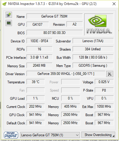

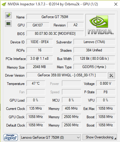

Hi! I have a question about flashing the ultra bay
after i put in dos commands
nvflash -a
there is 2 graphic adapters "0" and "1"
then i started to flash "1"
nvflash -i1 -r
nvflash -i1 --save xxxxxx.rom
nvflash -i1 -6 755mOC.rom
flashing was passed perfect!
when i wanted to start flash "0"
i put in
nvflash -i0 -r
and DOS writes that EEPROM is not supported
should I flash "0" at all? or it is good enough to flash only "1"?

Hey I had the same problem. After browsing the forums a bit it seems we only have to flash the ultrabay(1) card. Apparently the main(0) graphics card was taken care of when we flashed the BIOS in the previous steps. I've already gone through with it. When I look at my graphics cards using nvidia inspector it lists both as MODIFIED so I think it worked out alright. Hope I was able to help.

You only need to flash the Ultrabay. (1)
The BIOS flash takes care of the Main GPU.

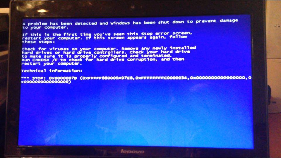

I just flashed my bios with this mod and everything came up fine, I booted linux mint 17 and that looked great. The only issue i'm having now is that my Windows 7 partition is quickly showing a blue-screen error and a black screen. Then the system recovery blinks up quickly and it goes back to black again. What could be causing Windows 7 to not work with this bios mod? I did exactly as stated in the instructions, including loading default settings.
EDIT: Fixed by changing SATA mode to Compatible/IDE
