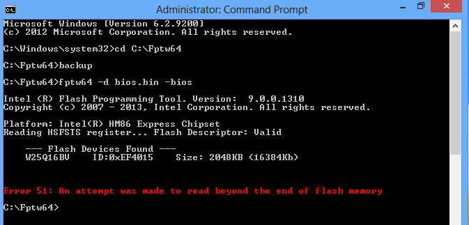

Hi there. I actually got stuck in the first step which is this "Create a backup of your own BIOS by using this tool.
The archive contains the files of the program and a .bat file that will create a backup of your BIOS. You need to call the .bat file from an admin command prompt."
I have no idea how I can run the .bat file.
please help me~
I think I found how to do it. Please let me know if this is right or not.
I put all Fptw64 folders' files into c\windows\system32 and run cmd by admin and typed "start backup.bat" and it seems like backing up my bios.
and it says writing flash contents to file "bios.bin"...
does this mean my bios backup has been saved in bios.bin file?
I dragged this file to bio-fixer program and nothing happened!!!!!!!!!!
its just saying "Input file: bios.bin" thats it!!!! what should I do??????
wow solved it again.
first, I had to pull out bios.bin file to desktop from system32 file.
it worked!!!!!!
