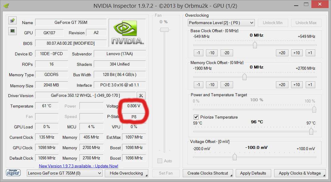

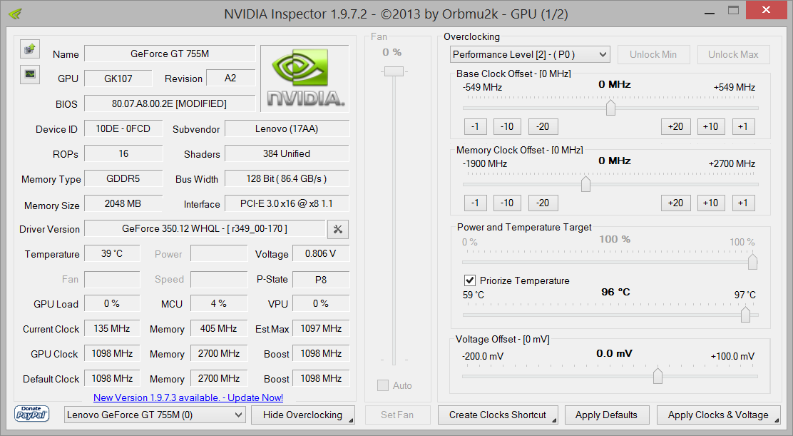

Post a picture of NVInspector (2nd Page) for both the GPUs. Have you flashed the modded BIOS? The ultrabay GPU separately?

I've flashed both Vbios and Bios and here are the screenshots:
[ATTACH=CONFIG]14862[/ATTACH][ATTACH=CONFIG]14863[/ATTACH]
that's it :D
thanks for your help so far:)
Ok both your GPUs have been flashed to custom vbios. Try to undervolt in increments ( start from -100mv) and go upwards, dont change any other setting yet. If your GPU underclocks, manually overclock. Overclock the Memory and downclock the Core thats how Kepler architecture likes it. Use MSI Afterburner to check the clocks and temps your GPUs are running at. BTW hows GTA V running on your system? Report back the temps

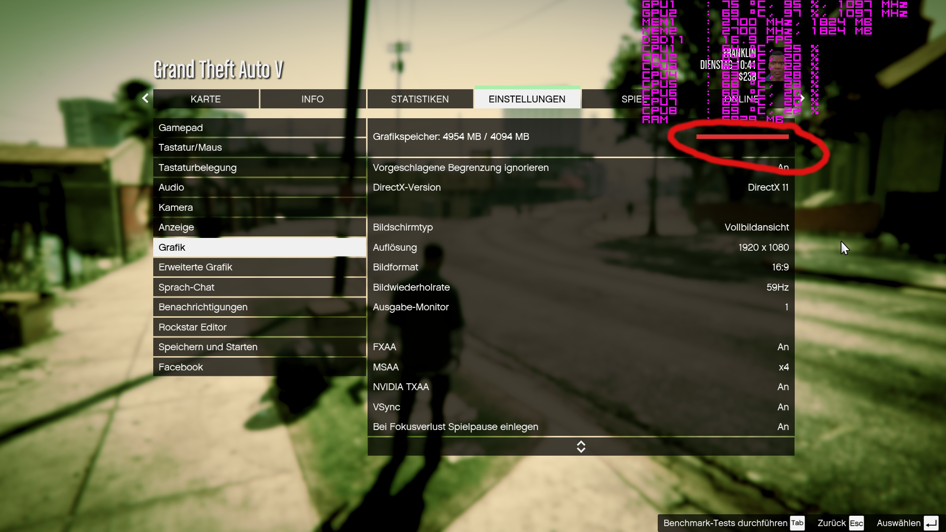

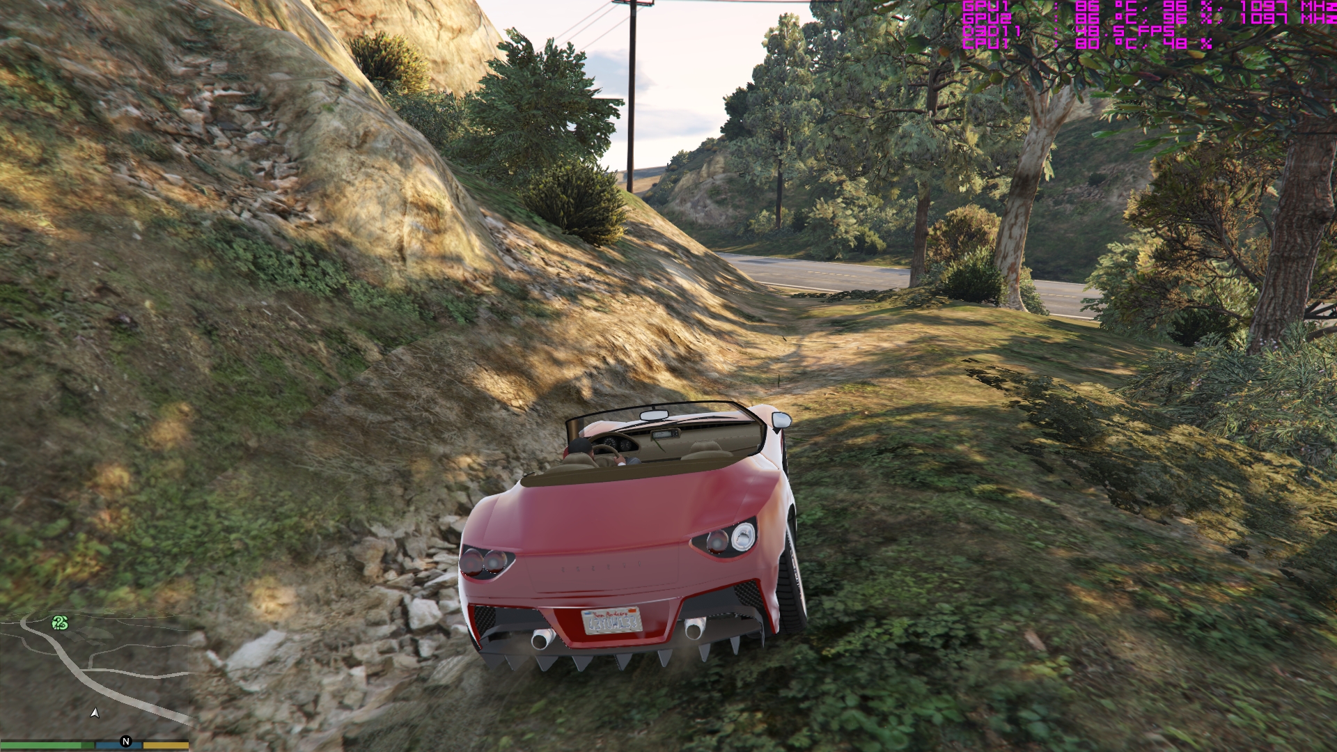

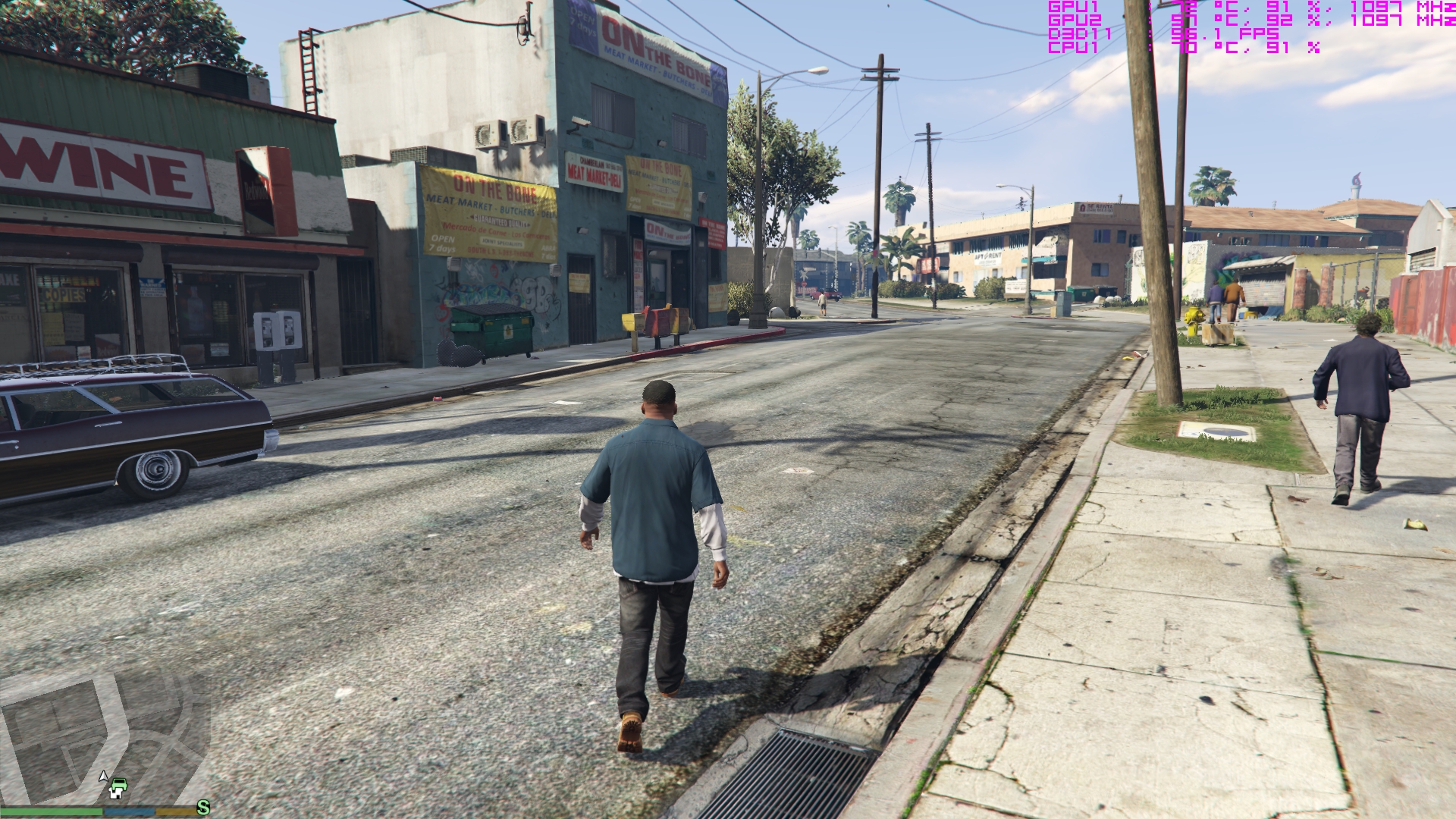

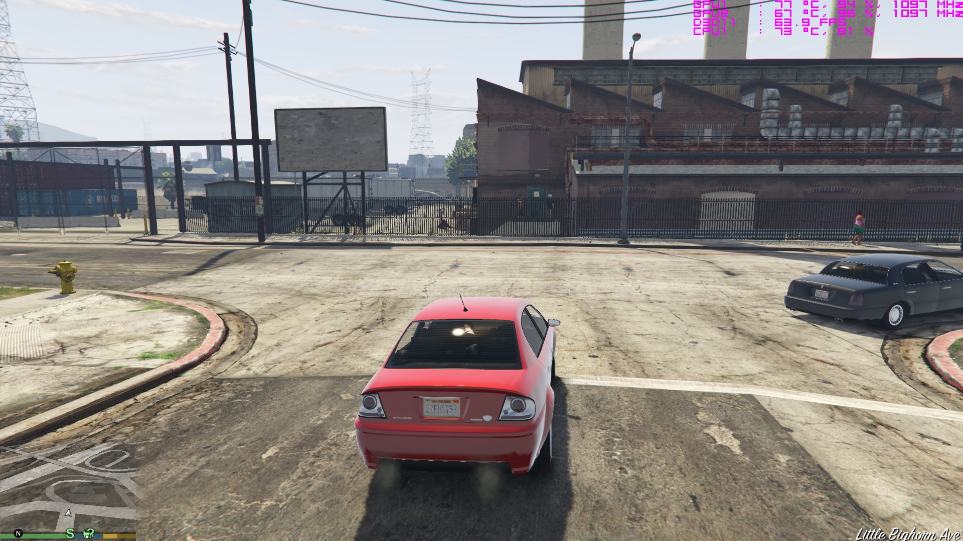

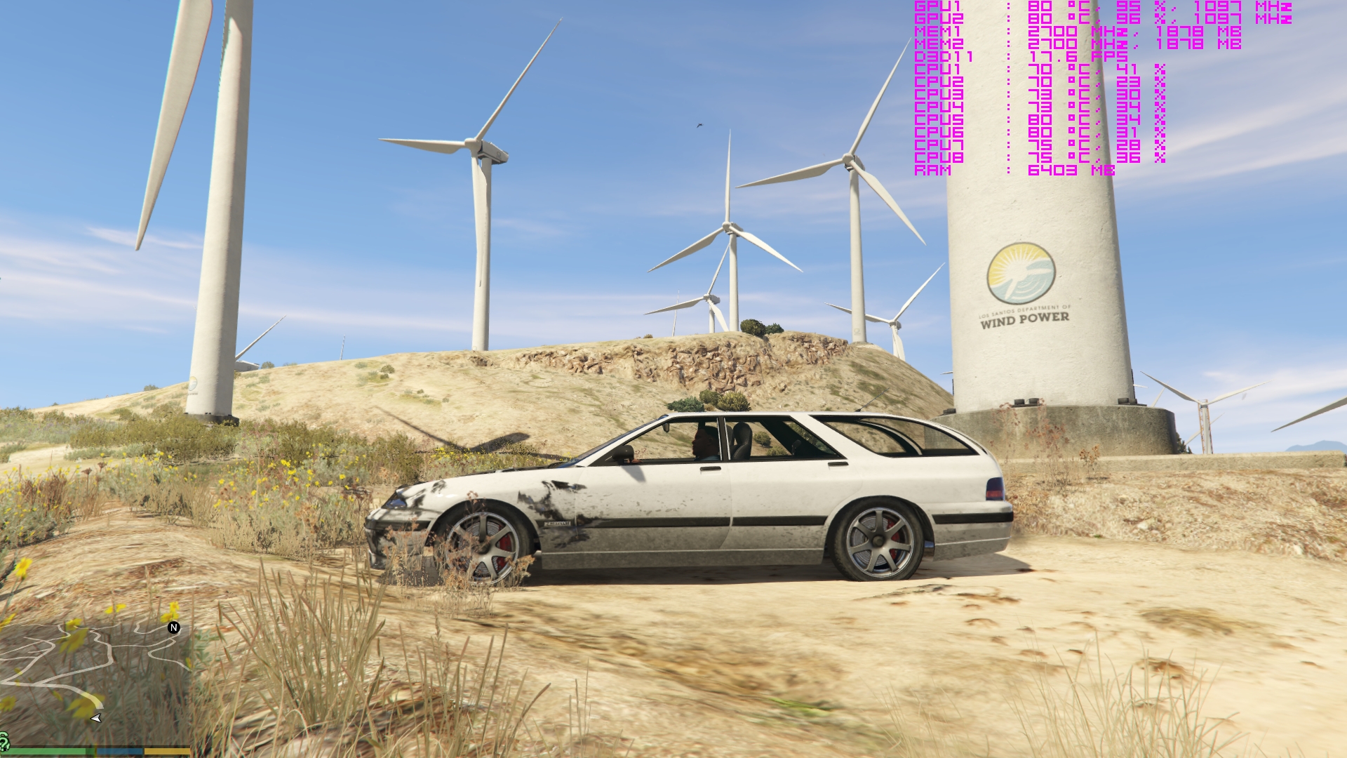

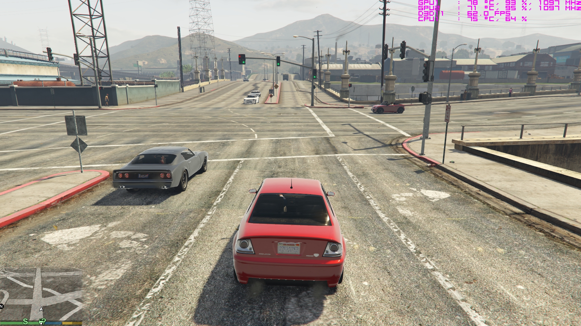

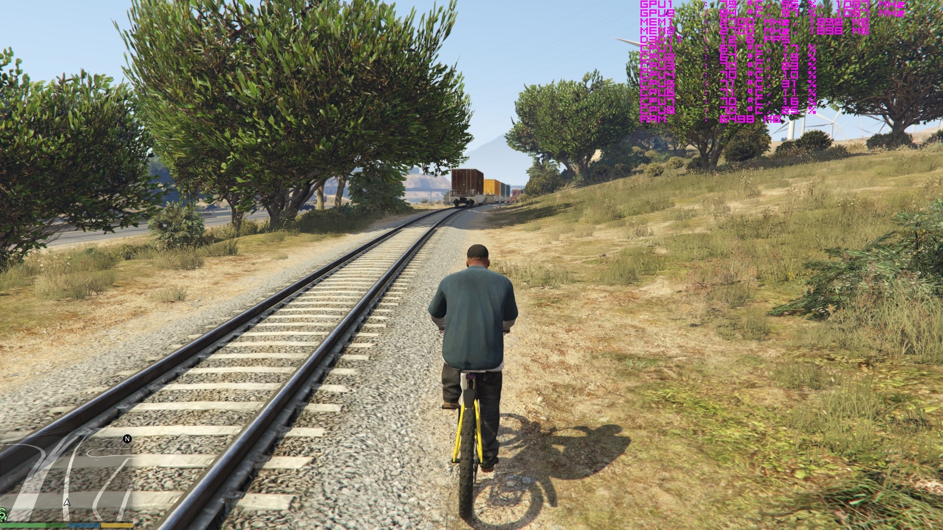

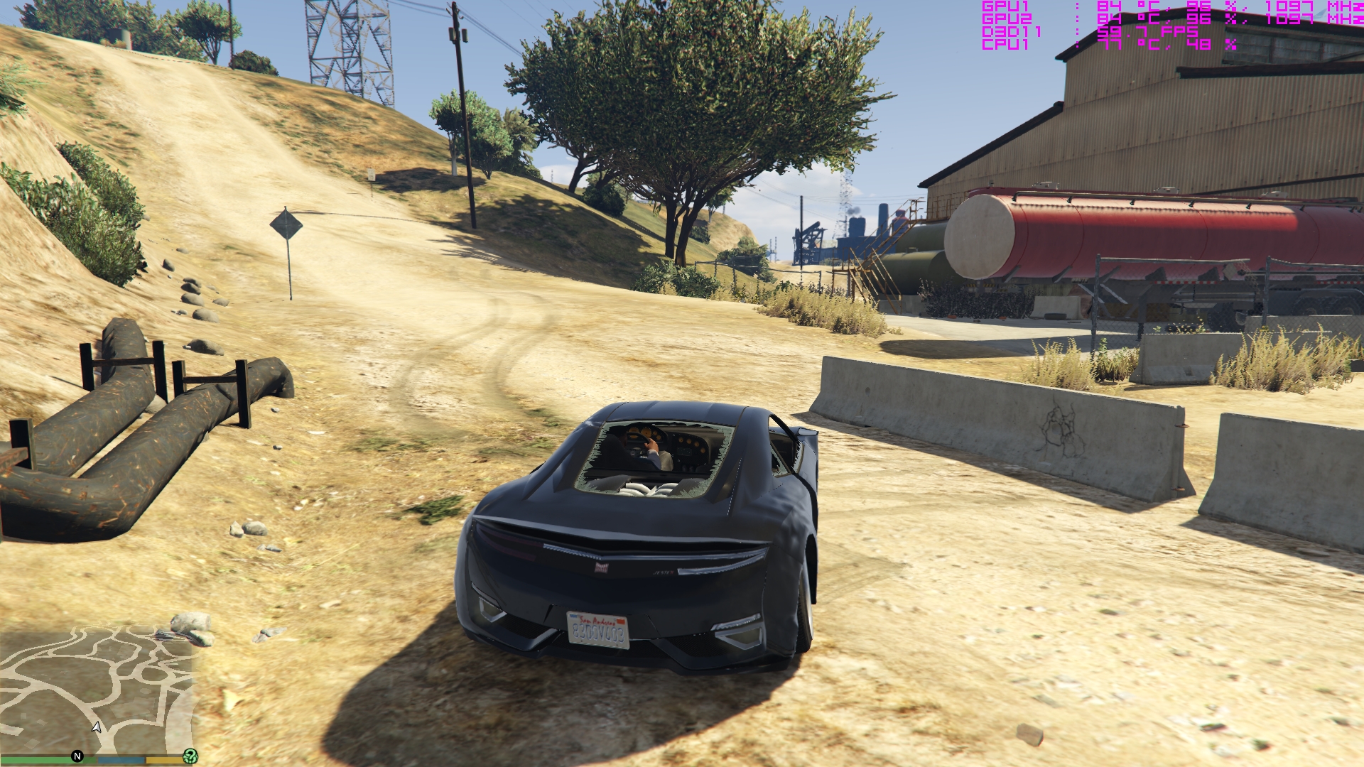

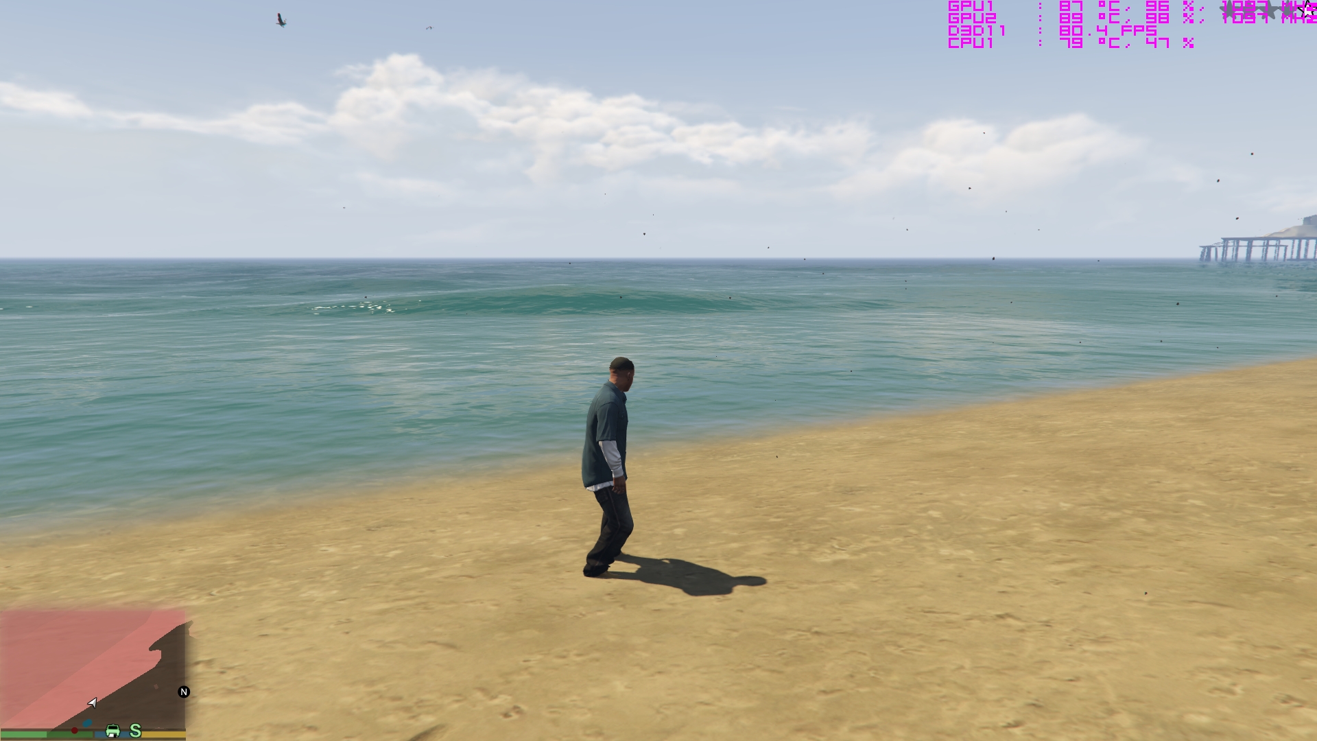

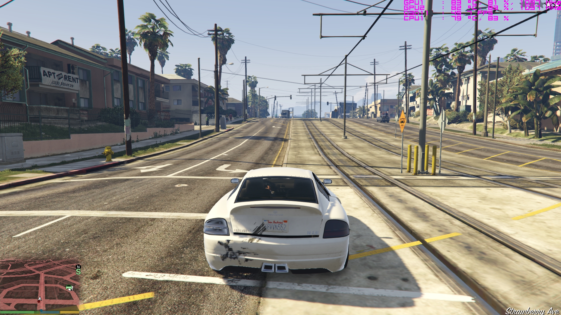

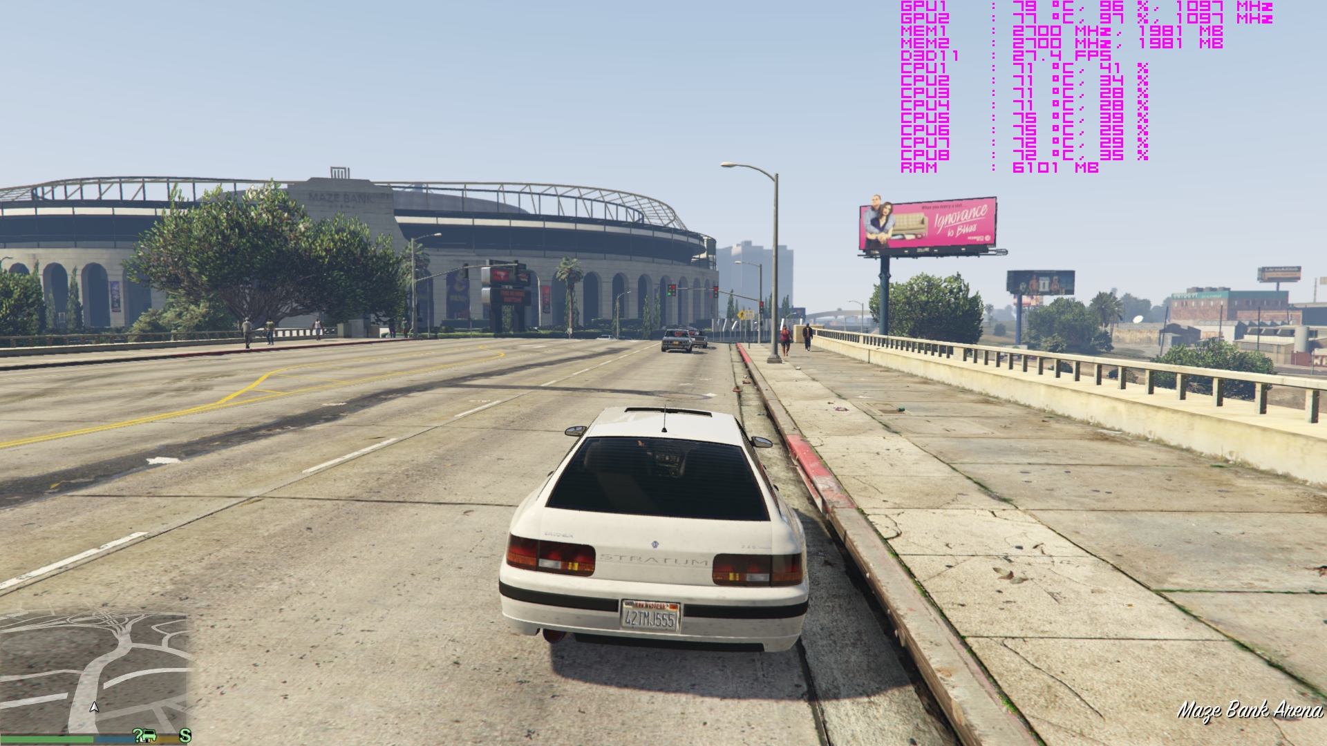

Okay, as you said I just undervolted my both GPUs by -100mv. I got no crashes with -100mv (I undervolted them before by -112,5 or something and I got crashes so I preferred to ask for help), I didn't check other voltages yet. My GPU didn't underclock so I didn't have to overclock manually. And I didn't change anything like memory clock and core clock because I wasn't sure which values would be the right ones. The highest temperature was 90°C at the ultrabay gpu and all in all they were around 85°C.
Sorry for that much pictures :D I thought it would be helpful.
GTA V is running fine :)

Okay, as you said I just undervolted my both GPUs by -100mv. I got no crashes with -100mv (I undervolted them before by -112,5 or something and I got crashes so I preferred to ask for help), I didn't check other voltages yet. My GPU didn't underclock so I didn't have to overclock manually. And I didn't change anything like memory clock and core clock because I wasn't sure which values would be the right ones. The highest temperature was 90°C at the ultrabay gpu and all in all they the were around 85°C.
[ATTACH=CONFIG]14894[/ATTACH][ATTACH=CONFIG]14895[/ATTACH][ATTACH=CONFIG]14896[/ATTACH][ATTACH=CONFIG]14897[/ATTACH][ATTACH=CONFIG]14898[/ATTACH][ATTACH=CONFIG]14899[/ATTACH][ATTACH=CONFIG]14900[/ATTACH][ATTACH=CONFIG]14901[/ATTACH]

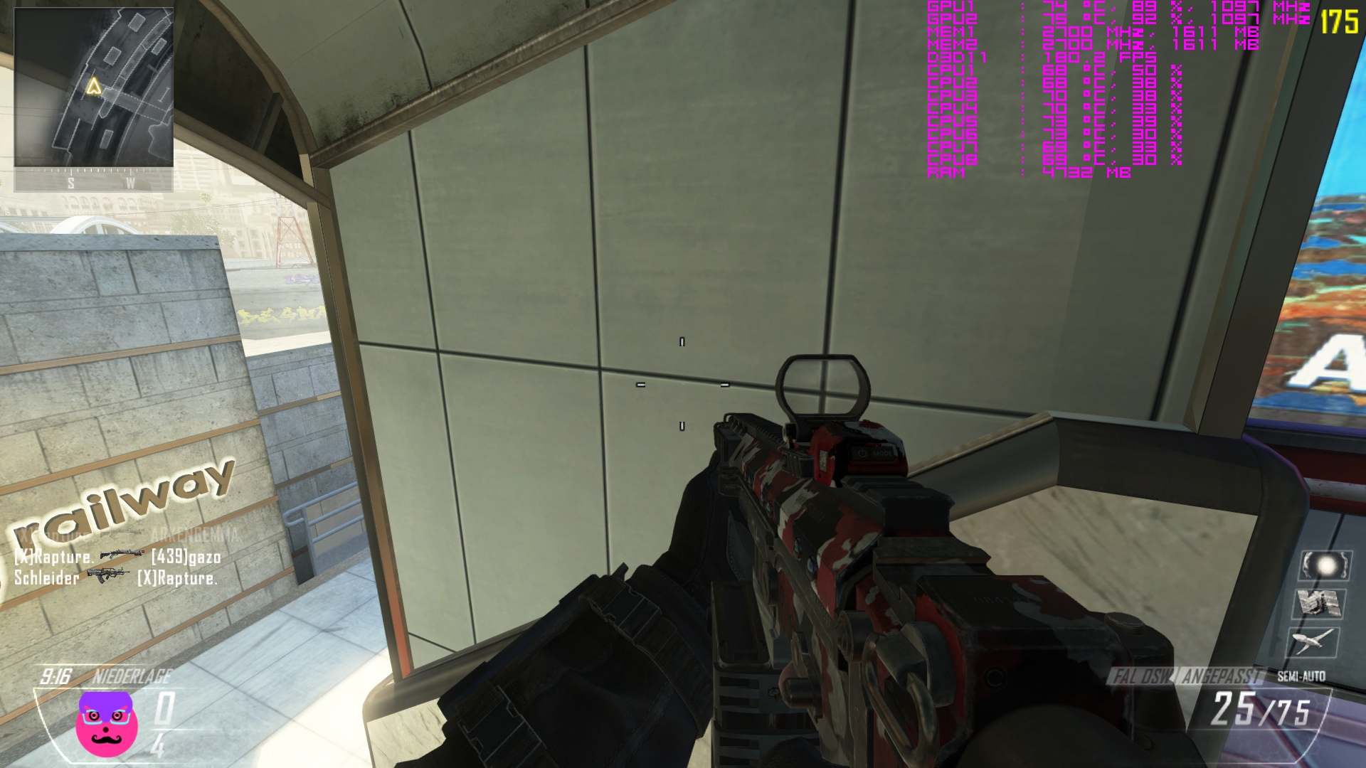

I think you're running at very low settings. And why is MSI Afterburner reporting only 1 CPU? Check the game with HWinfo running in the background. Secondly turn the gfx to ultra or high and report the FPS. If you prefer to run the game at 60fps I suggest you lock the fps to 59 or 60 since exceeding those will make GPUs work harder (higher temps) and there is no use. Have you checked other games?

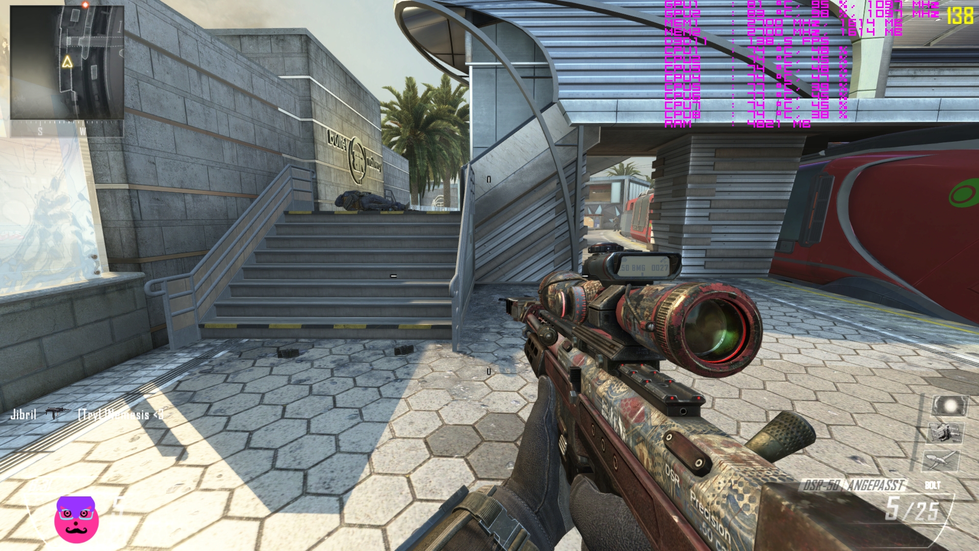

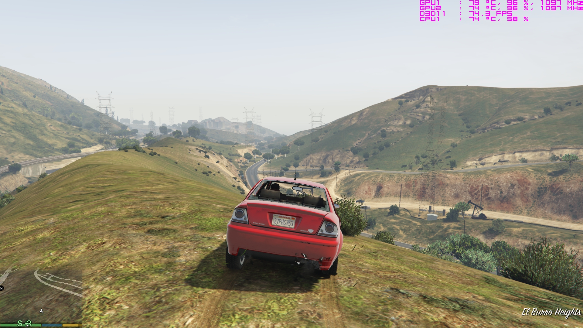

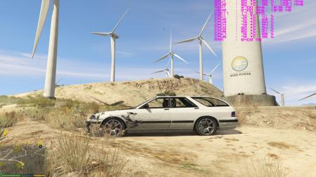

I turned on all the CPU core temperatures in the on screen display and some information about the memory clock too. In GTA 5 I also turned on vsync. In BO2 i didn't because I need the high framerates for a smooth gameplay.
I had the settings on high/normal, that's right. I've tested Black Ops 2 and GTA 5 at highest graphic settings now. Black Ops 2 everything maxed out and GTA 5 too, MSAA x8, textures at very high and so on, but it said that my graphics is overfilled.

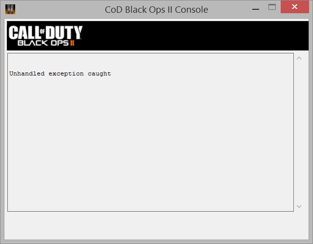

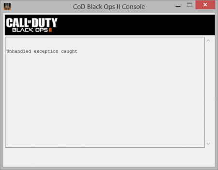

I've got crashes in both games after something like 10 minutes. Here's the error message of BO2 and two screenshots, i had a freeze and needed to press ctrl+alt+del to get to the desktop:
With GTA 5 I've just got the normal windows error: GTA 5 doesn't work anymore...

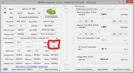

What i have to say is that I think these crashes aren't due to overheating which you can see in the pics below, could it be a result of modding the Vbios? Because i've got this kind of crashes since i modded it.

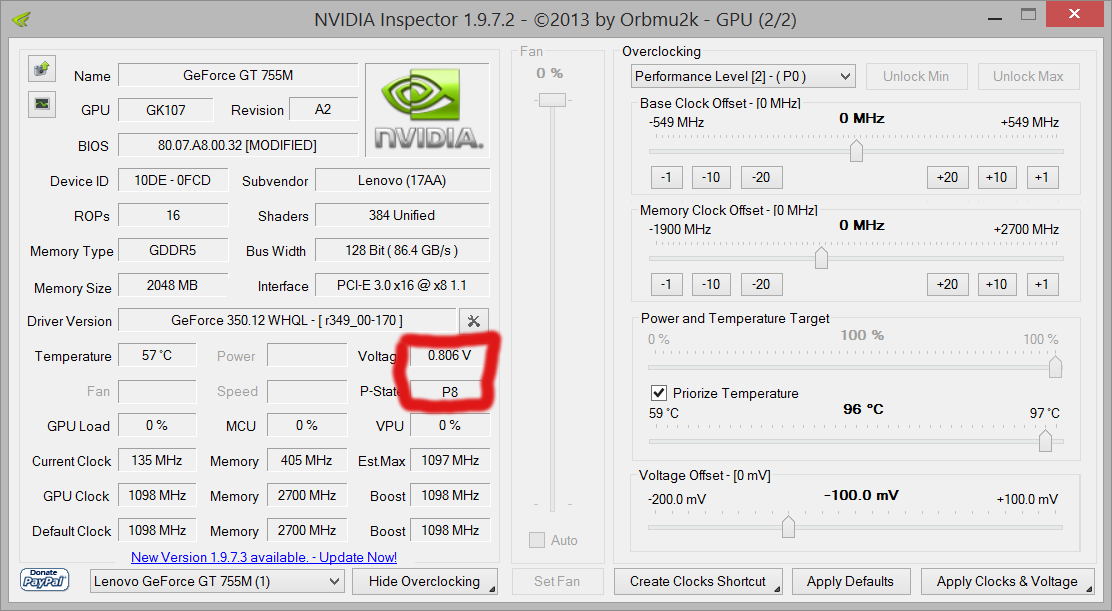

Sometimes I think NvidiaInspector sets the wrong P-state:
I don't know whether it needs to be locked but in the file I used before there was a command to lock it.
Thank you, I hope someone can help me :)
Fix your attachments. Secondly the crashes you get in certain games is due to the undervolt. Lower (-87mv) your undervolt in games that crash. I'd also suggest you update NVI. The P-state is set according to load. If you ALTab inbetween a game the P-state might change which is what your case seems to be. Lastly what is your avg Temperature of both GPUs, CPUs, and FPS in GTA V on ultra? Also mention your ambient temperature.
