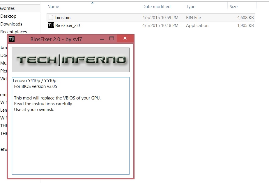

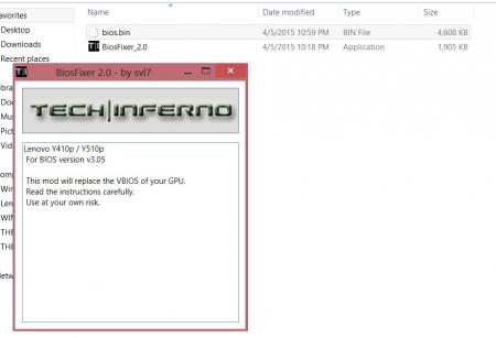

BiosFixer 2.0 DOESNT WORK....! I decided to use your modded bios for y510p 750M SLI version..after successfully updated to bios 3.05 from 2.07 and took a backup of new 3.05 bios then
when I simply drag and drop bios backup file on BiosFixer_2.0.exe just a small windows pops out but there is neither a button nor a browse thing in there..? and when I close it nothing created in the same folder as it should be "v305mod.bin" just look at my picture uploaded..
and I also disconnected the second gpu from the bay but it doesn't work again
and I cant go back or downgrade to official 2.07 bios even though Bios Back Flash is ENABLED in bios and when I run this "Y510p-Y410p_v207_[stock].exe" with ADMIN priviligies says "Bios version compare error"... WT:Banane56: ?
[ATTACH=CONFIG]14511[/ATTACH]
you should drag the file bios.bin onto the small window. around the white area.
